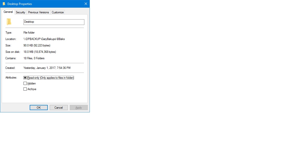

I assume there are 18 files in the 90KB folder? :)

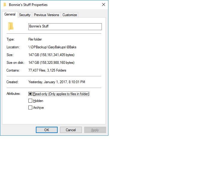

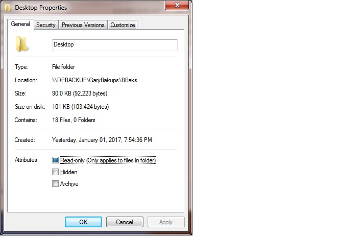

Yes, there are 18 files in the 90kb folder -- clearly Wndows "thinks" there's a 1MB min allocation size.

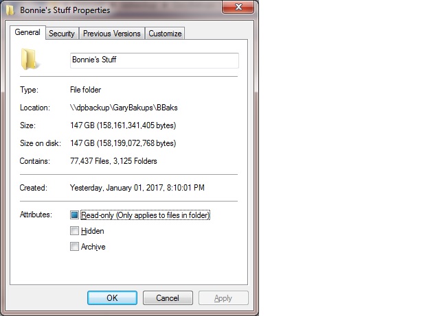

HOWEVER ... I was "fiddling" a bit and discovered that this is NOT a problem with Windows 7 -- only with Windows 10.
Not only does Windows 7 show the correct results ... but it completes a "Properties" window [i.e. right-click on a folder and select Properties]  DRAMATICALLY faster than Windows 10 does.  For example, the two results below show the same folder -- one done in Windows 10; on in Windows 7.  Windows 7 completed the Properties window in ~ 1 minute;  Windows 10 took nearly 10 minutes.  And as you can see, the Windows 7 result is correct.
And just for grins, here's the tiny backup that only has 18 files ...
Yes, I've just tried Windows 7 and it's shows correct and completes way quicker as you have mentioned compared to Windows 10.

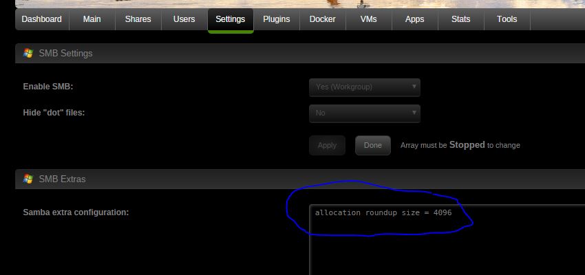

Some of you please add this line to your smb-extra.conf file (Settins/SMB Settings/SMB Extras):
allocation roundup size = 4096
or even
allocation roundup size = 0
and let me know if you notice any performance differences.

I tried changing the SMB allocation parameter -- set to both 4096 and then 0 with very similar results.
There's still a HUGE performance difference between Windows 7 and Windows 10, but at least the massive difference in "size on disk" is gone ... although interestingly it's still not shown as the same number in the two OS's.
The following results are from both Windows 7 and Windows 10 after changing the allocation parameter to 0.  Note that the huge difference is gone, but the results are still not the same in the two OS's.  Also, the time to generate the Properties window was about 15 seconds in Win7, and nearly 3 minutes in Win10 !!  Definitely STRANGE !!

I changed the setting to 4096 with the following results ...
"Size on Disk" is exactly the same as with a 0 setting -- i.e. it's fine.
But there's still a difference in the reported numbers for '7 and '10 ... definitely STRANGE.
The actual Size of the folder I used to test this is 158,161,341,405 bytes.  The "Size on Disk" is shown as 158,199,072,768 bytes in Windows 7, and 158,320,988,160 bytes in Windows 10.  Not significant, of course, but still strange that they'd be different.
Performance wise, there's still a BIG difference.  Windows 7 took 16 seconds to show the finished Properties page.  Windows 10 took 2:46  (166 seconds) ... or just over ten times as long.

Here is the correct way to change it (It's often not explained in this forum i have noticed):
In the unRAID web GUI (v6.3.5) click Settings -> SMB (under Network Services) then you add "allocation roundup size = 4096"  (without the " ") in the text box "Samba extra configuration"..
After that im not 100% sure if the settings will take effect or if you have to stop and then start the array.. I ended up with rebooting unraid after that it is working correctly! :) Finally!
Maybe someone could report this as a bug (or change request)? Or I will when i get the time in a few weeks or so...
Below you can see the that the allocation size has changed.. Size on disk: now shows 4KiB instead of 1MiB! :)
