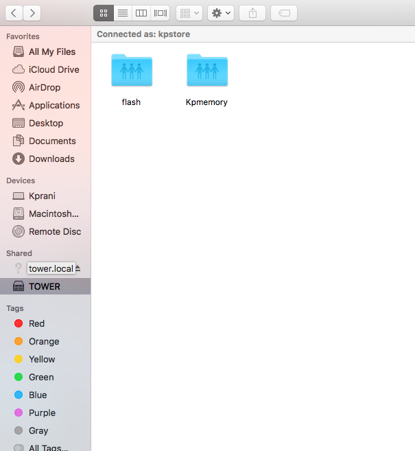

I created a new share and enabled SMB for that share. It is set to be private. Not available to guests. Only one person has R/W access.
Then from my mac, I tried accessing the share over SMB.
I'm able to access my share. But I am also able to access the flash usb drive on the UnRaid box. Isn't that a major security issue?

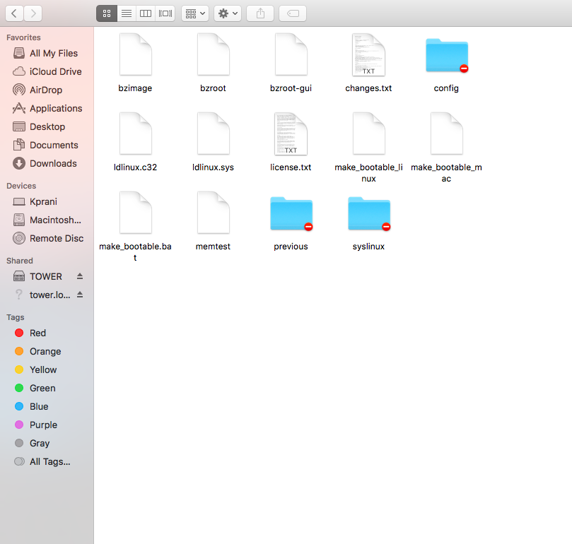

As you can see from the screenshots in the attachments, the flash folder and its contents are visible even though, the only share being accessed is at `smb://192.168.0.103/Kpmemory`

Have you changed the SMB permissions for the flash drive?  Click on Flash from the Main Tab (Boot Device) and you can set it as you wish.
And don't forget about the Yes(hidden) option. That will make it so nobody can see it, but if you have permission you can still get there by specifying its path.

Oh. I never knew the flash had share settings and that they can be changed. But thanks for pointing that out.
In any case, why would the flash usb drive be exported as an SMB share by default? I've had UnRaid for about 18 days now. I noticed that that flash drive was being exported on a Mac 2 days in. But didn't think much of it then, cos I was trying to set up other things on the UnRaid box.
Noticed it again today and I knew it had to be fixed.
