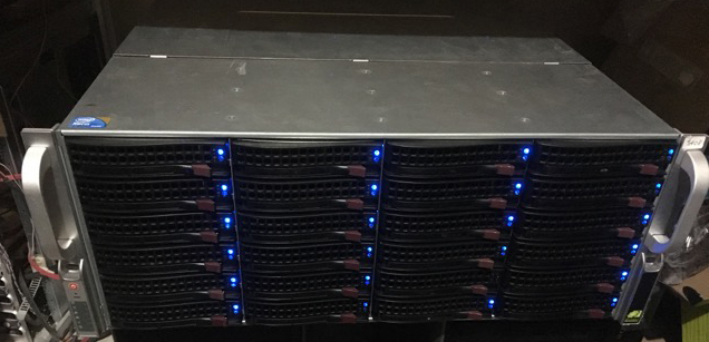

For rack mount, the sky is the limit. 24 bay chassis like the Supermicro 846 are very common on eBay and built like tanks. Supermicro also offers 36 and 45 bay version of that chassis called the 847 I believe? Don't quote me on that one as I don't own any.

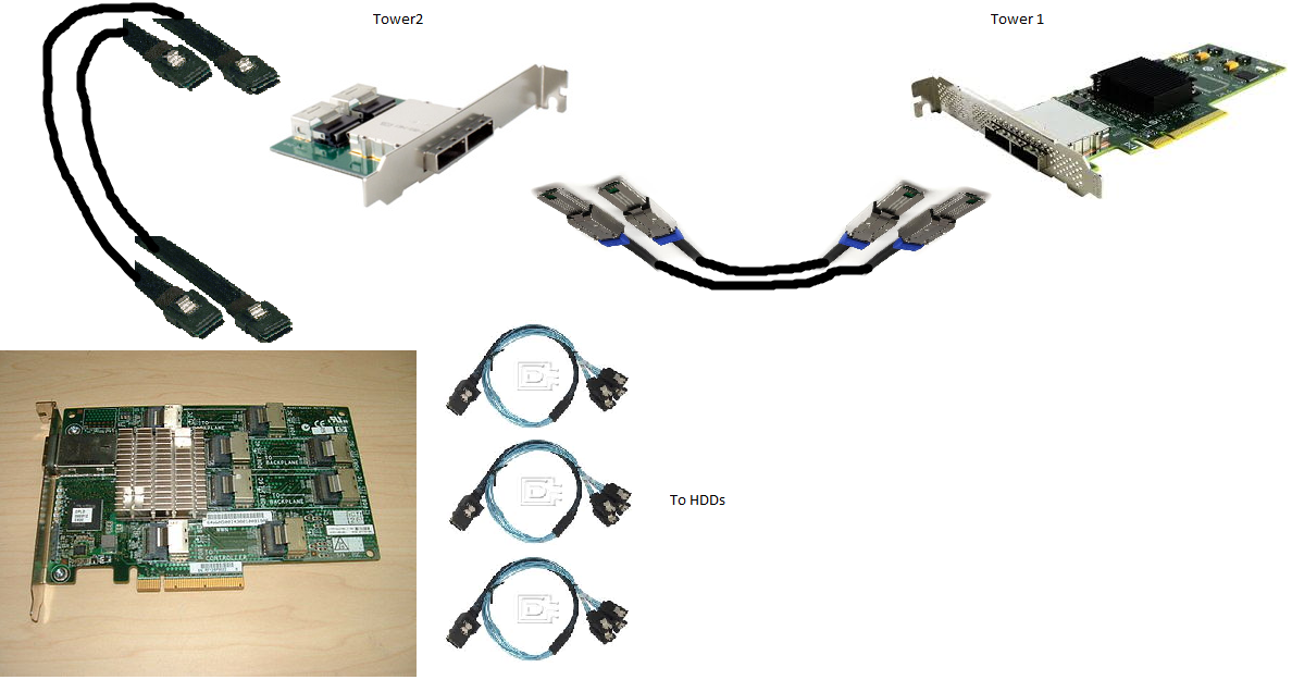

Another economic way to build a big server, is to use 2 towers , especially if you already have them, it's how I built my 30 disk server, one tower with 18 disks and another with 12, connected by 2 external SAS cables, so it's very easy disconnect one when I need to work on it.

It's not easy for me to take a good photo without disturbing the server, but the image below shows how I connect from the main tower to the extra one with 12 disks.
Note however that there are cheaper ways of doing it, like getting a controller with 16 external ports (e.g., LSI 9201-16e) and using 3 or 4 SFF-8088 to SATA cables, with that you wouldn't need all these cables, adapters and the SAS expander, but I had most of these parts available already from previous projects.

I went the 'big server' way and got a SC846 off ebay. It is still the best value for money IMO for what you get, e.g. compared to a Norco, but bjp999 is right, you have to balance the need for expansion with the cost.
Ok, in the cheaper example you mention, you would h have 3 computer cases?
1 average/to small PC to run the Unraid software with maybe some solid state drives for the cache and parity drive and the 2 X LSI 9201-16e(16 external ports each, 32 ports total), they would connect to like 8 X SFF-8088 which would branch out between 2 high tower computer cases with the 3X5 adapters with possible 30 hard drives between the 2 cases.
Would there be some kind of special power supply that could adapt to 30 hard drives? Do these external Sata have like a 1-meter maximum length limit?  I was reading something like that but not sure if it for normal SATA or if it would apply to this type of thing.

I now run (2) 112TB/EA (14x8TB) arrays. All my 2TB drives will be sold. But with 24 bay SM 846 chassis being dirt cheap, you can build a running chassis for the cost of a 8TB drive if like in the case of the OP, you already own the drives.

No, just 2 cases also, SAS cables can be up to 10 meters, I'm using 2 meter (6 feet) external cables between the 2 towers, SATA is 1 meter max, but as long as the cases are side by side you could use a controller with 4 external ports to connect 3 or 4 one meter SFF-8088 to sata cables, 1 meter is enough to connect from the back of one case, enter through the back of another and connect to the disks.
Each cables connects to 4 disks:

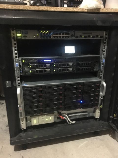

Do you have this in some dedicated server room at your house/company? How loud is this? My understanding is these have crazy loud mini fans on the power supply? Do you have some kind of custom setup or do you use the motherboard included with this case?  Your signature page said supermicro 36Bay, but I only count 24 bays. Are there more in the back? This has a very nice look to it.
Thanks for sharing Gollum
Thanks.
Nope it sits in a half rack under a desk in my office. I've attached a photo and a sound clip, the sound clip was taken on my iPhone with my in my chair about a two and a bit feet away from the rack, its pretty loud. If I have to use the phone, I close the door to the rack which makes it quite a bit quieter.
Yes there are 12 more bays on the rear of the server. I am still using the older dual socket 1366 Intel motherboard that came with the server although I recently upgraded the original CPU's that were quad core to hex (6) core.

I would not mind having a professional looking rack based system however since I have no room in my house for a dedicated server room, it would have to be directly behind me. This is one of the reasons I am leaning towards some kind of multiple tower solution with off the shelf computer parts. I can get power supplies with large quiet fans and case fans.  I'm not sure if there is  a way to basically take one of these cases and add standard PC equipment to it in order to make it quiet.

Thanks for the great information in the pictures and audio file. I appreciate it.
