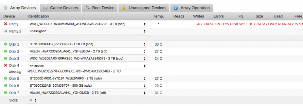

Drive died and Parity wants to rewrite
See screenshot. I had a drive that died and won't even let the server boot with it in. I've never even heard of that but it boots without the drive. Now it says Parity will be overwritten if I start the array. Should I replace the drive first?590bc1b25f392_ScreenShot2017-05-04at8_01_56PM.thumb.png.c2cfca0589e448c62ebd648b147b0269.png
Before you do anything, post your diagnostics, as you have 2 downed drives, but only single parity.  IE: You can't rebuild

Disk4 is missing from the beginning of logs/syslog.1, but it isn't missing later in syslog.1, and it isn't missing in syslog. It appears in SMART with 2 pending sectors, but it doesn't look like unRAID ever disabled it. It isn't shown as disabled in system/vars.txt
Parity disk looks OK, but it is disabled, which is why unRAID wants to rebuild it. I don't see the write error that would have caused unRAID to disable the disk, but syslog.1 is truncated. It is only missing a few hours. See if there is a syslog.1 in /var/log and post it.
Possibly you just disturbed parity cable when you were trying to get disk4 working.
Obviously rebuilding parity with a missing data disk isn't a good idea. According to the screenshot disk4 is missing, but it doesn't look like it is missing now according to your diagnostics.

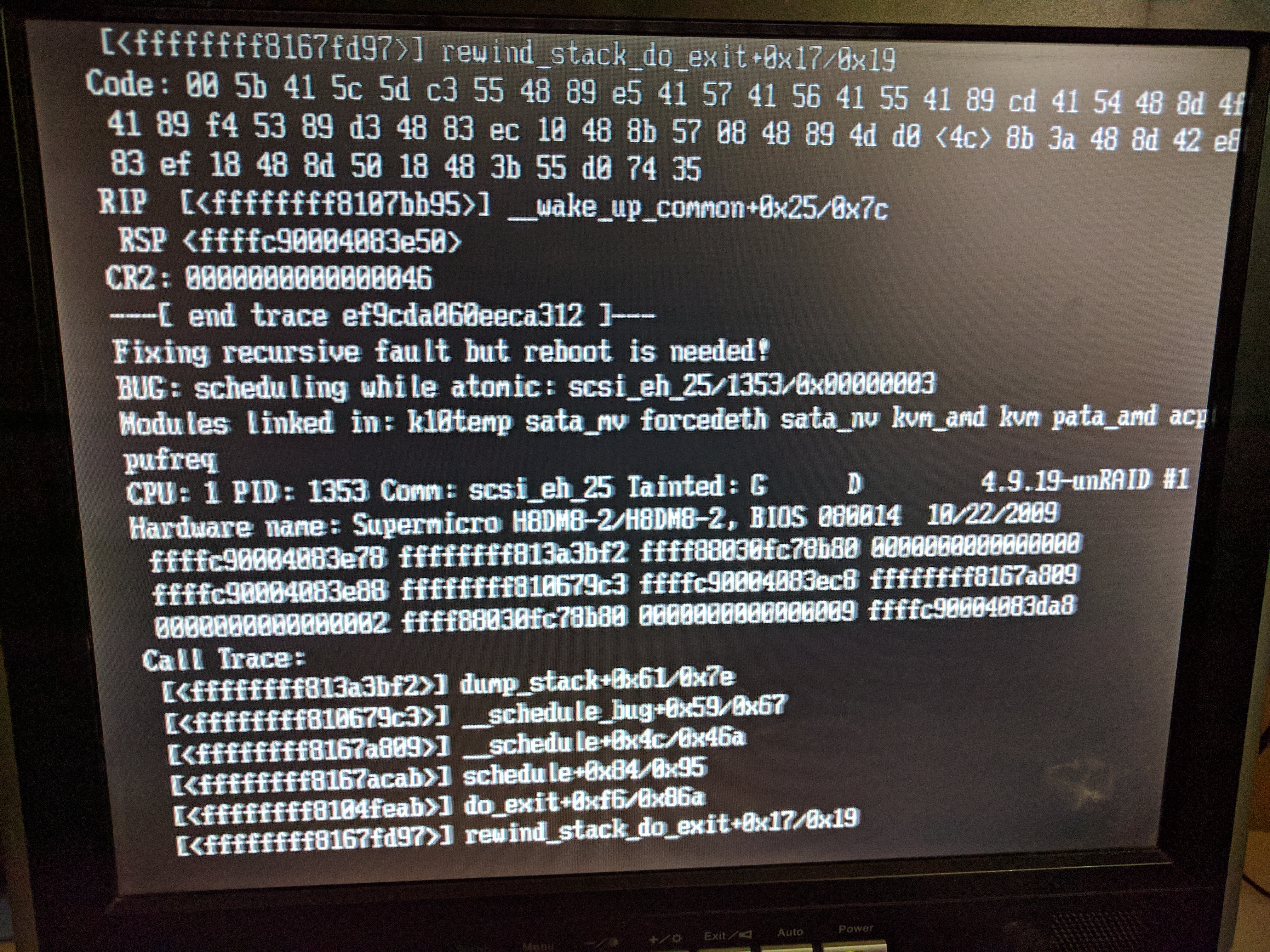

Sorry, I see I've made it confusing. Disk4 was missing because I took it out. I took it out because the server won't boot with it in. I then connected it via an external usb drive after I got the server to boot. That's why it was suddenly showing it was there.
 Now, I've put it back in using a known working bay. See the picture I took. The bootup stops there with the drive installed. The only way to boot is to remove that one drive

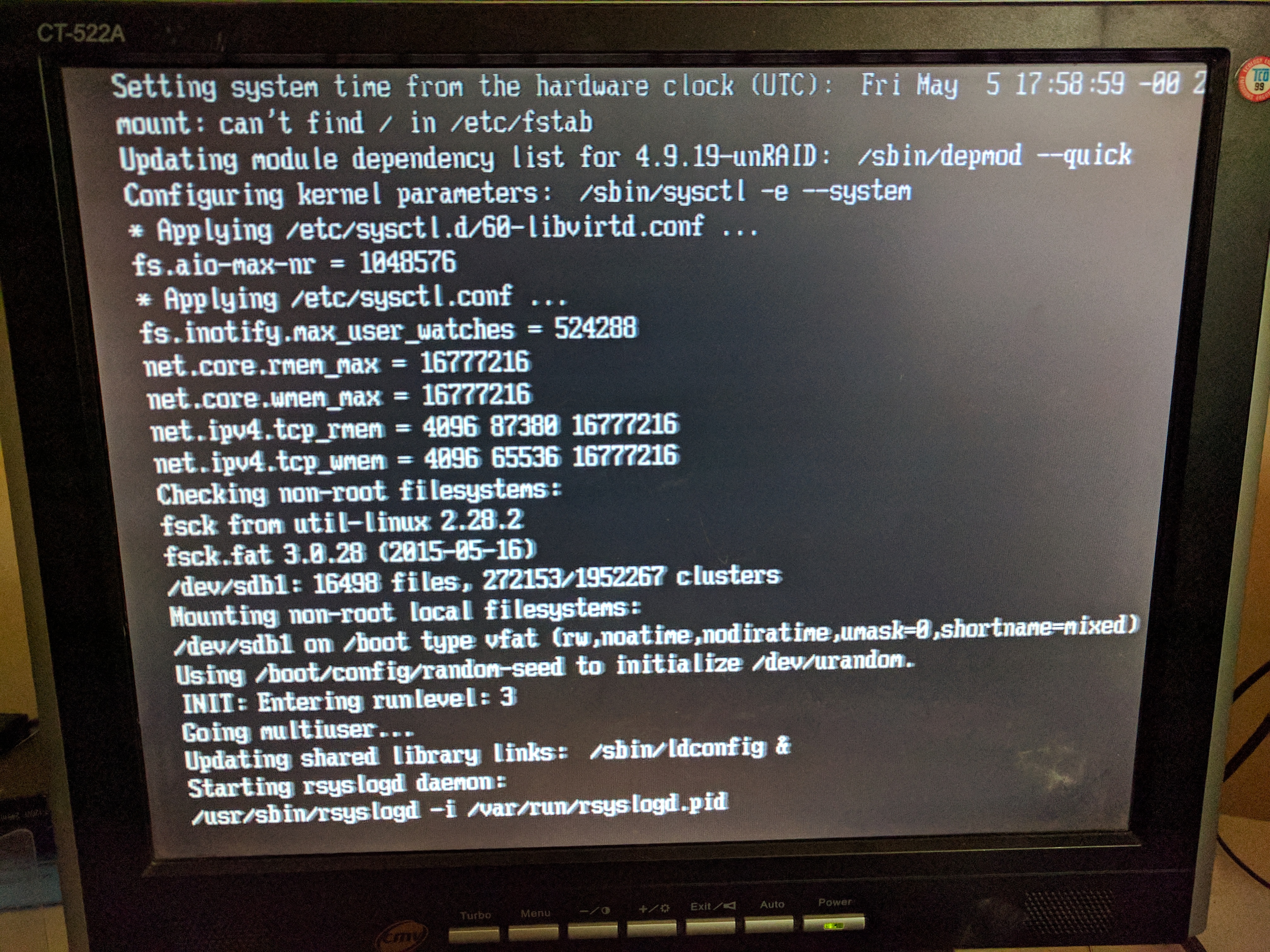

Any idea what I'd have a ton of FSCK.REC files that are 8kb each? Also, I tried hooking that hdd directly to the MoBo and all the system does is flash a blinking cursor at me. I moved that drive to the bay closest to the powersuplies and I got the same thing as the last screen I posted. I'm backing up the thumb drive now and will try it with a clean version of unraid.
Often the BIOS will try to "help" you by trying to boot from a new disk. Did you make sure it was booting from flash?
Well, I feel like an idiot. That's what had happened. And it actually booted! Attached is the diagnostic although since I can see the bad drive it the drop down I'm not sure you'll see much in it. But who knows. Now, I'm going to put my files back on the flash and try to boot and see what happens. Maybe run to Frys...

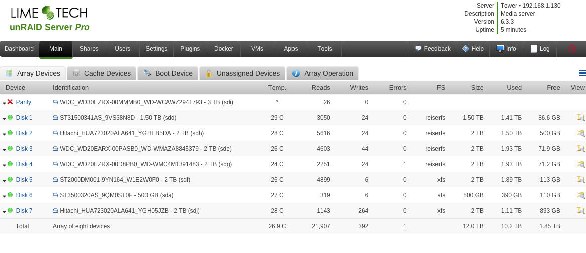

Ok, I sort of merged a clean 6.3.3 along with my old one and got rid of the /extra and /custom directory so it wouldn't install all the extra crap. I'm booted back up and the array automatically started without parity. That Disk that had been giving me problems said it had 1 read error. I attached the diagnostics, the smart test for that drive (I checked it with a fast SMART and it said it had errors), and a screenshot of what I see now.
I've shut it down... I don't know where to go from here. But, I probably need to go buy a hard drive or two.. right?

Parity looks OK, it just needs to be rebuilt. Disk4 has 2 pending but I would wait till after parity rebuild to consider what to do about that.
