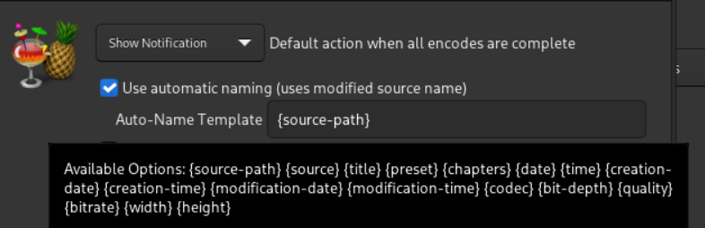

also is there a way to to have the files output to a folder that is named the same as the folder the source file is in? i tried {source-path} {source} but that didn't work. trying to do like how the windows desktop version does outputting

it's odd that in the container it mentions {source-path} in the automatic name like in the screenshot but it doesn't provide any output at all if i use it so it's not interpreting it correctly it seems. this isn't such a huge deal but would be nice to see the linux version add it at some point (i know not under your control for that though).

After a little bit more investigation, it seems that the "source-path" parameter is working under Linux.  However, HandBrake will use the source path only if it is writeable.  By default, /storage inside the container is read-only, thus if your video is coming from there, the "source-path" parameter won't work.  If you want /storage to be writable, you can edit the "Storage" parameter of the container and change "Access Mode" to "Read/Write".  You have to switch to the "Advanced View" to be able to perform this.
