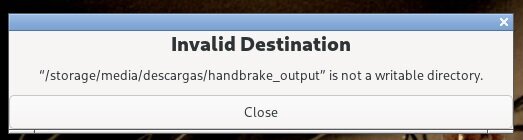

I'm trying to use HandBrake but it always says when I clic Start to encode "invalid destination is not a writable directory"
This is my config for docker, I have touched the bare minimum but I always get the same error no matter what folder I choose to output

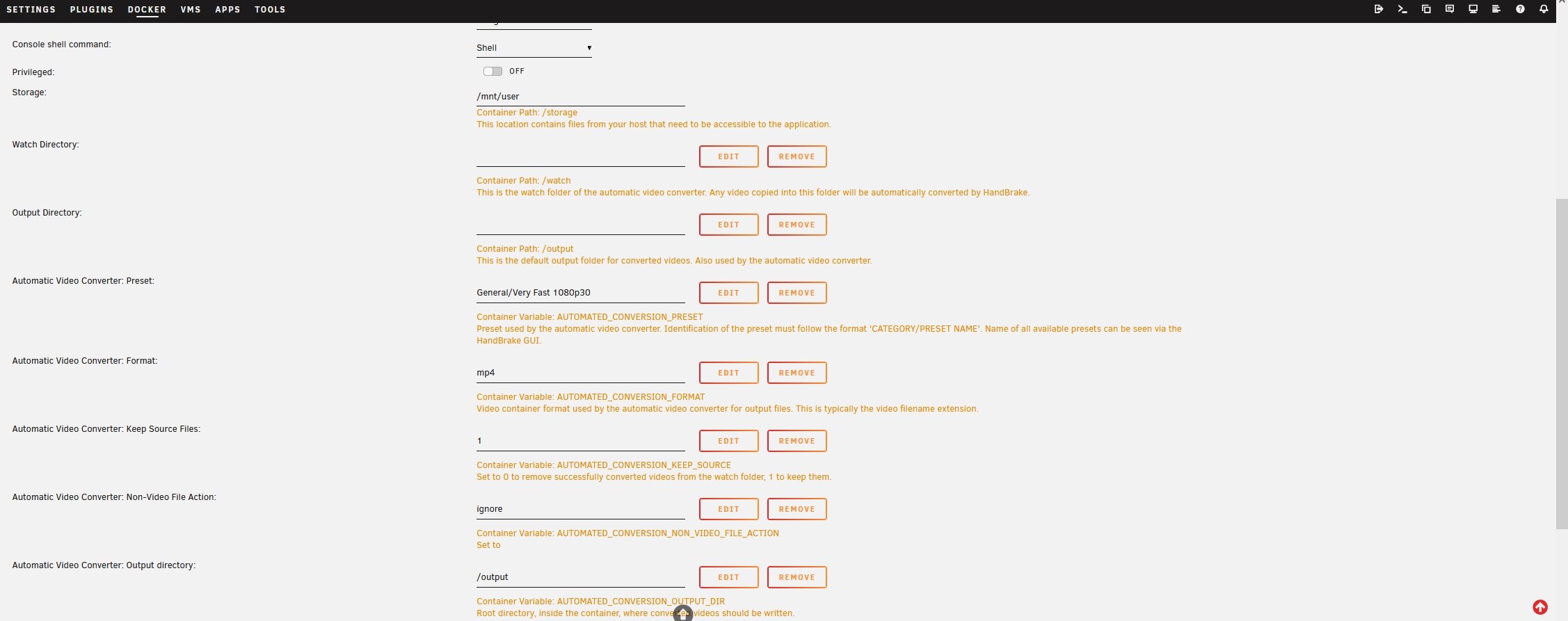

I don't use this, but your mapping for /storage is ro (readonly). You probably want another mapping for the output.
ChatGPT said the same thing but there is no EDIT button on the template for the /storage mapping and I can't change the access, is there any other way of changing it?

Not sure if you're still looking for an answer three months on but...
You need to set an output directory in the container configuration - it's between 'Watch Directory' and 'Automatic Video Converter: Preset'. If you don't plan on using a watch directory you can skip that but at least set the output directory (which is set to rw).

After migrating to Unraid 7.1.2 Handbrake auto converter now just saves empty files.
