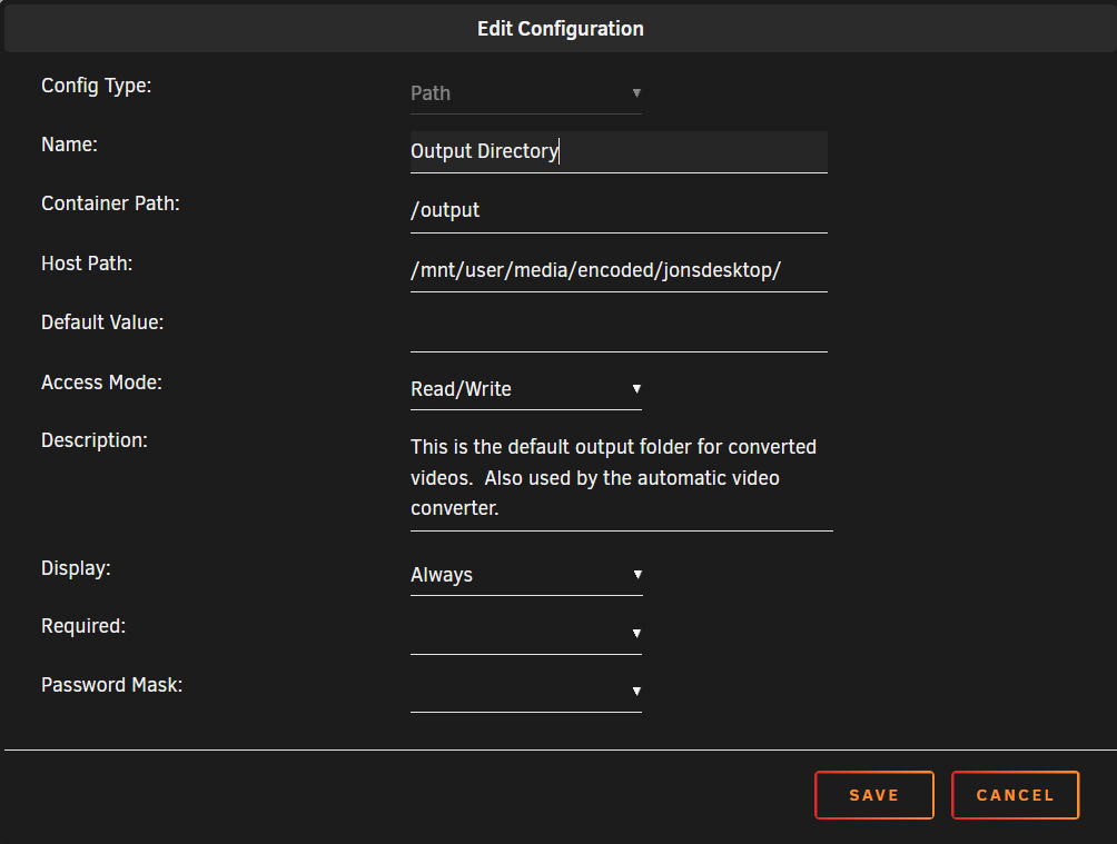

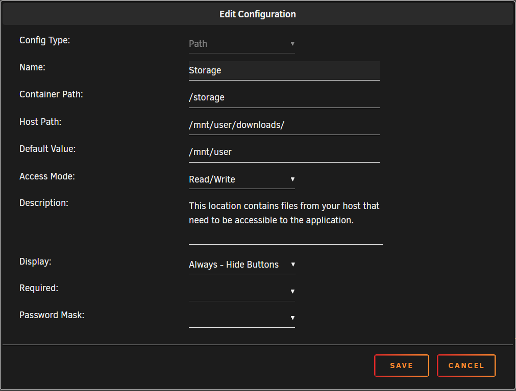

After a little bit more investigation, it seems that the "source-path" parameter is working under Linux.  However, HandBrake will use the source path only if it is writeable.  By default, /storage inside the container is read-only, thus if your video is coming from there, the "source-path" parameter won't work.  If you want /storage to be writable, you can edit the "Storage" parameter of the container and change "Access Mode" to "Read/Write".  You have to switch to the "Advanced View" to be able to perform this.
sadly still didn't work after i set and confirmed both storage and output are set to read/write

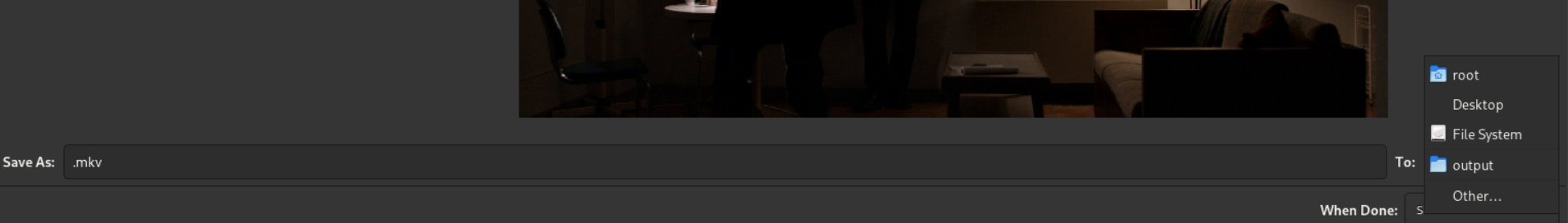

It's working for me.  How did you set the template ?

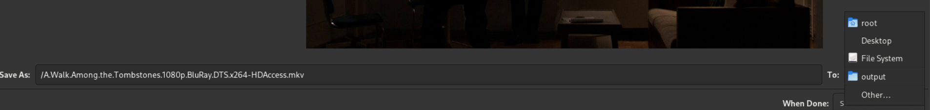

Also not that the source path is not part of the "Save to" field, but it is part of the "To" select box at the right.

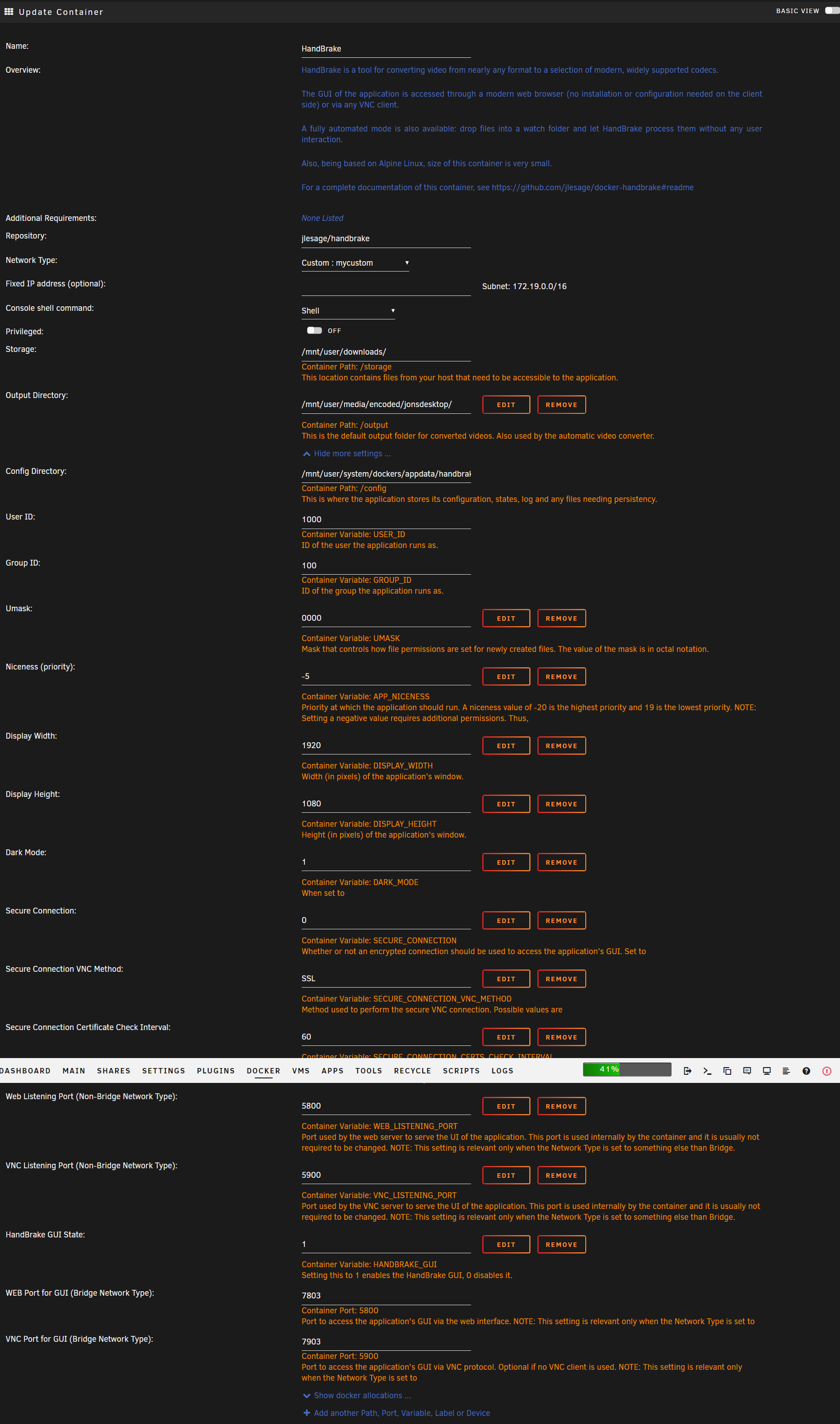

here is my template configs for the path mounts and the overall template, also a screenshot of how i have it in the container but i don't see the source-path in the to on the right in doesn't give me a name either unles it put {source-path} {source} but still nothing in the to on the right
image.thumb.png.a47a0542b242c025c8ec7b7092647ef4.pngimage.thumb.png.de6be38faf2838f47499374d94b697ec.png

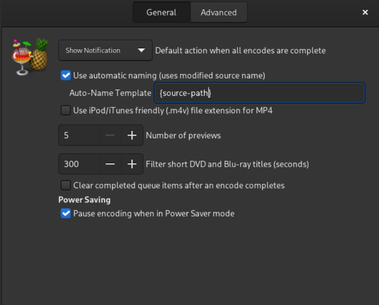

Did you try "{source-path}/{source}" ?
image.thumb.png.b059420a50754b43d2052fe436e11201.pngwith that it's ends up like this
I don't see "Access Mode" in Advanced View, is it called something else? Do I need to add a new variable?  Yes I was in advanced view and expanded all parameters/settings.
NVM, once you are in "Advanced View" you click "Edit" next to the Storage variable. Got that.
I changed it to read/write, because I output in a sub-directory of the storage volume. Restarted the container and am still seeing "because the associated output directory 'Cannot process watch folder because the associated output directory is not writable."
Anything else I need to do?

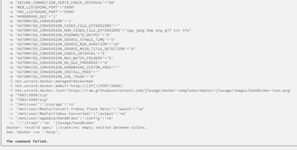

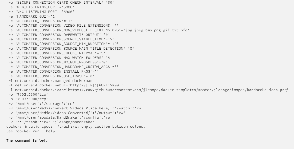

Recently had to delete my docker.img file as i believe it was corrupted and was able to get my other docker containers working again. However having a issue with getting HandBrake re-installed. I've tried creating a new template, as well as using my previous version with same issues. See attached, its failing at the end, and not too sure how to proceed. Would greatly appreciate any advice.
Also results in an orphaned Image when going to the docker tab.
Edited by IaMs12
Forgot to add info
as you see in the end line you have a missconfiguration
1/ either fix it by setting a correct volume mapping or remove it as you obviously dont need/use it
2/ may read this as "easy fix"
Background, older Unraid (Docker) Version just "ignored" empty volume fields, not anymore ... ;)
