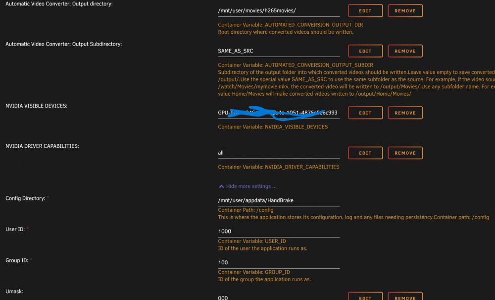

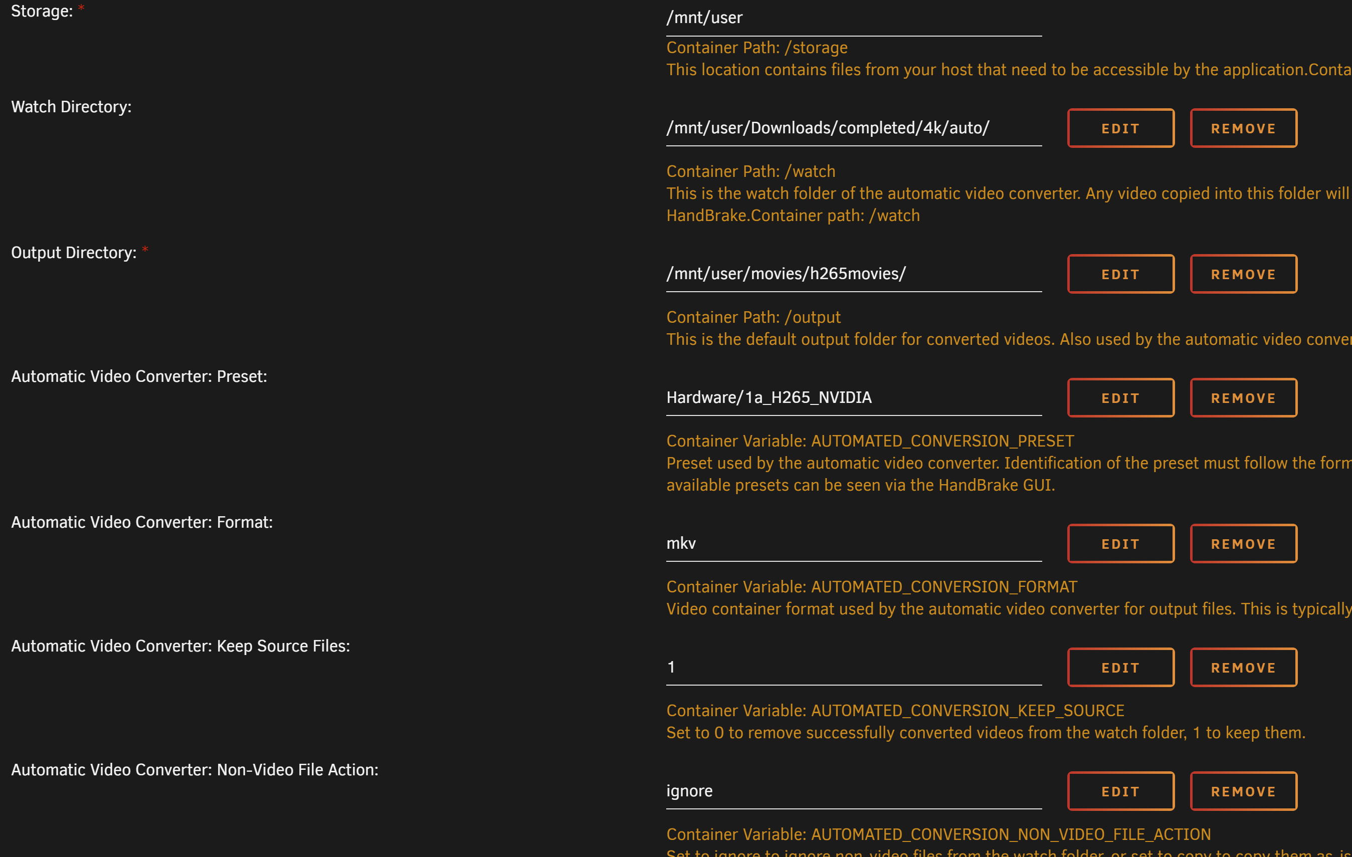

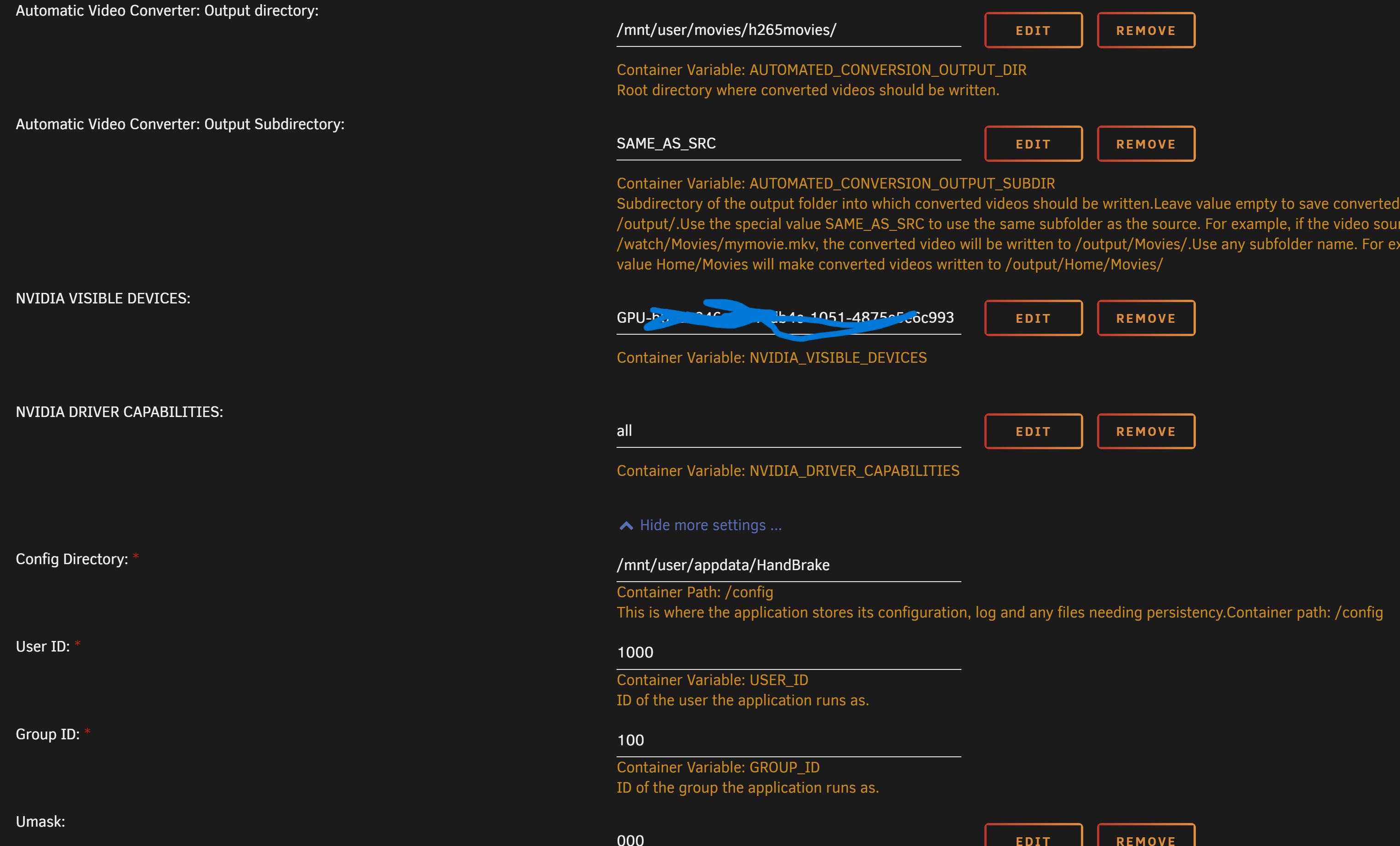

container settings are in the screenshots.

I'm using zocker160's NVENC-enabled fork of the HandBrake docker and I can't set it to output to mkv at all; it doesn't give the option, only to mp4 (the default) or to m4v. I've tried adding the AUTOMATED_CONVERSION_FORMAT parameter as a variable (copying exactly from jlesage's docker setup, only changing the value from mp4 to mkv) and it's not working; any help would be appreciated.
Edit: Never mind, I'm a dumbass...
Edited by dbaggett262
