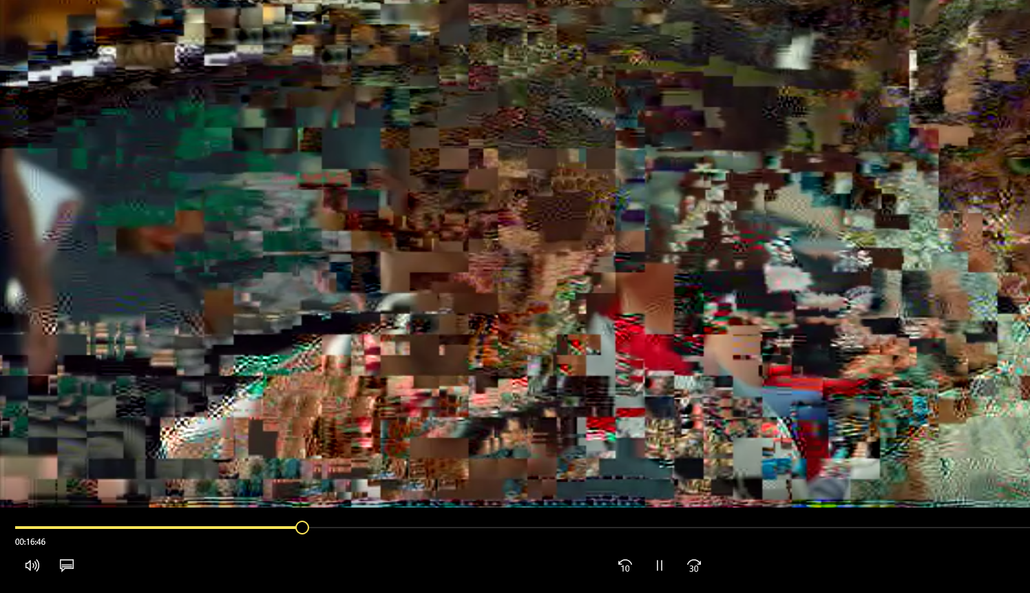

Hi all, hope we're all well.
I'm using zocker160 repo version of the docker just as many others are, I use a 1050ti for plex transcoding and had previously used it to rip a DVD to my server using NVENC on the previous docker image that got deprecated.
The issue I am having at the moment is that when using NVENC my videos come out extremely distorted as per screenshot. I am using the HQ 576p25 Surround preset with no adjustments, I have the --runtime=nvidia in extra parameters and my DVD is passed through as a device in the docker template.
I have two instances of handbreak installed, the jlesage/handbrake repo version works flawlessly using CPU only.
Does anyone have any ideas ? If any further information is required then I'll be happy to provide it.
EDIT: I have also just found that whilst encoding, the progress bar gets to 50% and then says encoding done and stops.
TIA, Myles

I'm having an issue where handbrake will "complete" a conversion but its not actually complete (Video won't play, file size is wrong and is usually MB when it should be GB).
It's happening with 4K video in particular. This seems to be happening at random and generally the second attempt at conversion does actually fully convert the file.
I pulled the logs for the last one and the conversion process was only at 20.51% when handbrake marked it as complete.
The conversions are done via the automated watch folder.
Also, the docker container is pinned to 3 cores/6 threads of the processor. The reason for this is I have two instances of handbrake for converting two video files at once and so each instance is pinned to different cores/threads so that one doesn't cause the other to crash.
