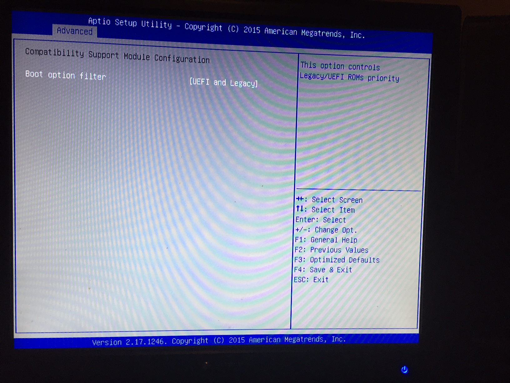

When I opened ticket with mother board manufacturer, they asked me to take photo of each BIOS setting and send to them.
In the process, I learn that under Advanced Menu ->CSM Setting -> boot option filter was set to "UEFI only".
While I was preparing response for them, I notice this.
So, I quickly changed it to "UEFI and Legacy" which allowed boot. (See BIOS photo attached).
In short, My drive was following legacy MBR boot and motherboard was looking for UEFI bootable media.
Hence, it was not booting. After above change, I could boot without any issues.
