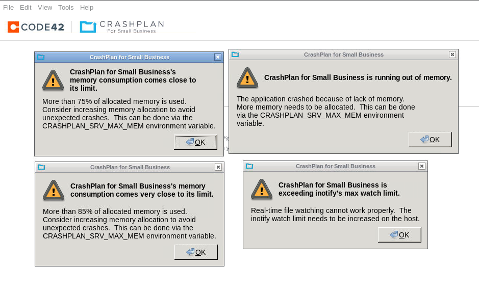

I have gotten my monthly email update and noticed that I haven't had a 100% backup completed in nearly 60 days.
When launching the container I see the following errors.
Note my server uptime is only 17 days, so this container has recently been restarted a little over 2 weeks ago.
Would love to know how to fix these for good so I don't have non-completed backups and so that it runs effectively.
EDIT: Also it looks like a partial cause of my backups not being fully complete for 60 days is that 3 files are not backing up?
Where can I find detailed logs that show me which files are having these issues so I can take the appropriate actions?

The amount of RAM allocated to that docker is not enough for what the application needs. Change the Maximum Memory setting in the docker config for CrashPlan provided you have enough free RAM for it (but keep it reasonable as you can always increase it later as needed).
Do you have a resource that you can point me to that shows how to do this? I'm not familiar with the process as I haven't needed to increase it for any other containers yet, so this is new to me - thanks!
EDIT - Have 128GB of RAM in the server running unRAID so I should be able to give it a sizeable bump.
EDIT2 - I see this container has a special place for that, whoops! Increasing it to 2048 for now to just make sure that solves all the issues for me first - I can reduce it later if I feel the need.
Edited by CorneliousJD

  1. Go to unRAID dashboard.
  2. Go to Docker.
  3. Select CrashPlanPRO.
  4. Scroll to bottom and expand "Show more settings...".
  5. Locate Maximum Memory setting (the default is 1024M).
  6. If you've got plenty of RAM to spare, I would bump up to 2048M.
  7. Click Apply at bottom and container will be restarted with new settings.

Had found this out from the github page right as you posted it. I didn't realize when I was asking that it was something container-specific, I thought it was something I could increase/decrease for each container somewhere in unRAID settings.
Thanks for the post - I'm back up and running and I found the file at hand that was causing the issue, a database file I'm backing up another way every week anyhow and that's only a big log for HomeAssistant - excluded that from the backups and I think we should be good to go now, thank you very much!
For the inotify watch limit, is that a setting somewhere in unRAID that I can change though if I keep getting that error?
Thanks in advance!
I think the way to go is to use the "Tips and Tweaks" plugin to adjust the inotify limit.
Awesome, that makes it easy, thanks!!!
