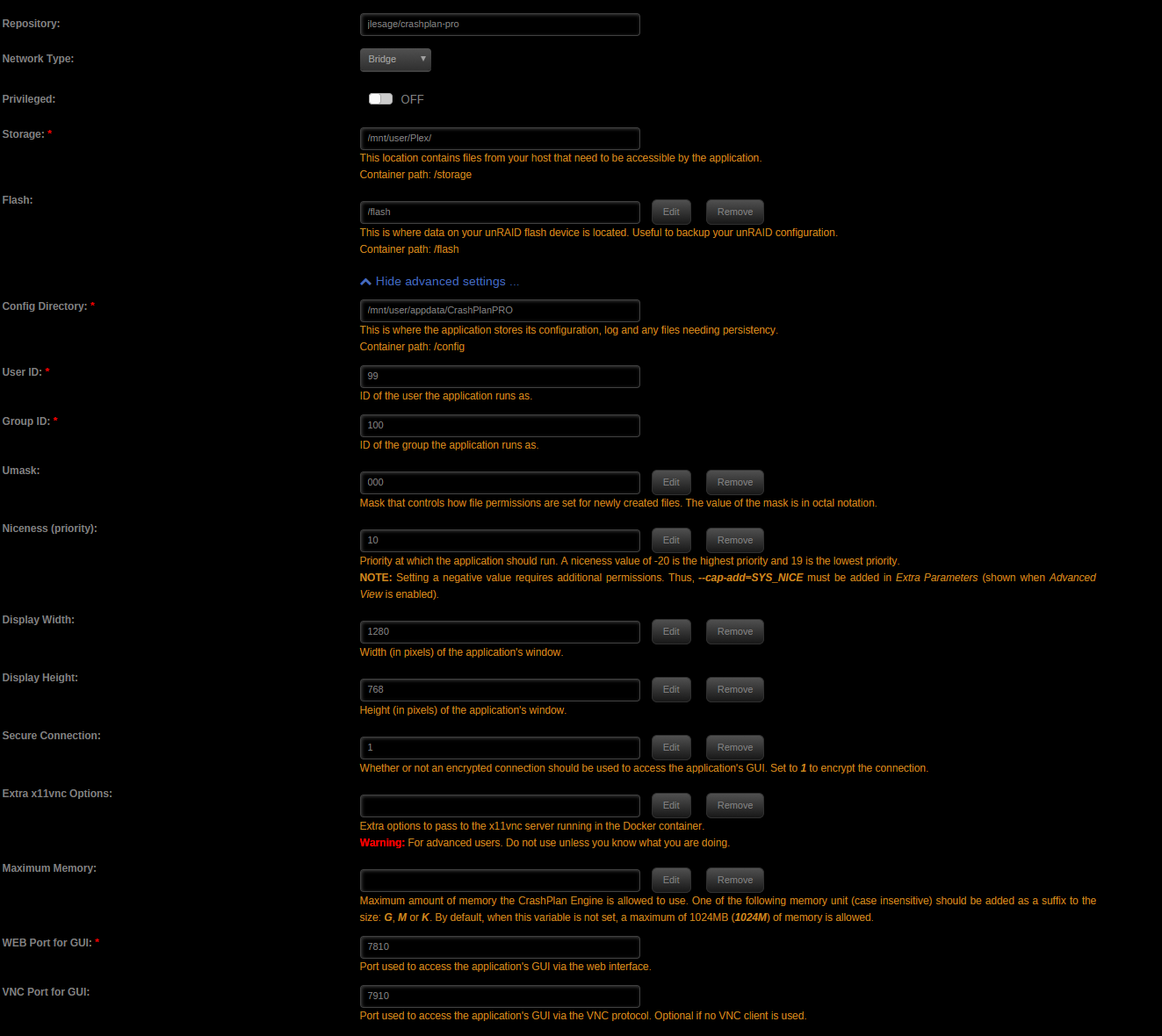

Can you tell me if the setting are ok in the image ?
thx
Settings look good.  The only comment I have is that you enabled the secure connection.  This means that the first startup could take some time.  I could take 1-2 minutes before the GUI becomes available.  Look at the container's log to see what's happening.
