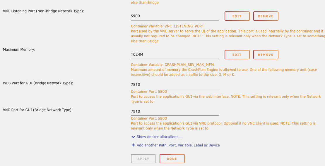

Hi, I created a custom network and set up my reverse proxy to route to the Non-Bridge ports.
Now I would like to remove the Bridge ports to prevent access directly from the local network without going through the reverse proxy.
The problem I have is that there is no [Remove] button beside the fields of the two Bridge ports.
I also tried to just empty the fields but when I save, the fields are filled back with the default value.
Would it be possible to get those two fields unlocked ? Thanks
Here, on the two "Bridge Network Type" there is no remove button.
These apply only when the "Network Type" setting in the same page is set to "Bridge".  From what I understand, this is not your case.  So the "WEB Port fo rGUI (Bridge Network Type)" and "VNC Port for GUI (Bridge Network Type)" settings don't apply and are not used in your case.

4 hours ago, rbroberts said:
I didn't see anything listed as a definitive solution to this, but I'm having the same problem. My lead up to the problem is a little different in that I managed to trash my cache drive completely and have been reinstalling from scratch. That got me my old config and the latest container; not sure what version I was on before.
Well, I rolled back to
    │ Application:           CrashPlan for Small Business                  │
    │ Application Version:   10.4.1                                        │
    │ Docker Image Version:  22.12.2                                       │
    │ Docker Image Platform: linux/amd64                                   │
And this works both with Host and Bridge for networking.
I'll try rolling forward step by step and see if it works.
And after rolling forward a few times, eventually ending on the latest, it's all working. No idea what went wrong the first time, but the problem has just gone away on its own.
