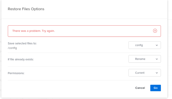

I have been having a lot of issues with "Waiting for connection".  I tried to clear the cache and that didn't seem to help at all.  The other day, I added a new folder to a "Backup Set", it read all the files, did about 10% of them and then kept going to "Waiting for connection".
I was able to ping 8.8.8.8 from the container so I know it has internet access.  No obvious errors in the logs.  I did reinstall the docker and that didnt work either.  Any suggestions?
When I go and try to restore some files I am getting error.png.d90ddfd130e75e1bcf7cd8972dc7d288.png
[1061:0331/234538.763453:ERROR:bus.cc(407)] Failed to connect to the bus: Could not parse server address: Unknown address type (examples of valid types are "tcp" and on UNIX "unix")
[1061:0331/234538.810478:ERROR:bus.cc(407)] Failed to connect to the bus: Could not parse server address: Unknown address type (examples of valid types are "tcp" and on UNIX "unix")
[1061:0331/234538.814275:ERROR:bus.cc(407)] Failed to connect to the bus: Could not parse server address: Unknown address type (examples of valid types are "tcp" and on UNIX "unix")
[1061:0331/234538.852562:ERROR:bus.cc(407)] Failed to connect to the bus: Could not parse server address: Unknown address type (examples of valid types are "tcp" and on UNIX "unix")
[1061:0331/234538.873599:ERROR:bus.cc(407)] Failed to connect to the bus: Could not parse server address: Unknown address type (examples of valid types are "tcp" and on UNIX "unix")
[1061:0331/234538.887636:ERROR:bus.cc(407)] Failed to connect to the bus: Could not parse server address: Unknown address type (examples of valid types are "tcp" and on UNIX "unix")
