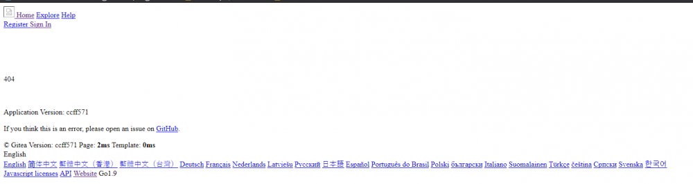

8 hours ago, Ezro said:
Hey,
I'm really digging Gitea (especially how fast the UI is).
Do you know how I can set up your container with the LetsEncrypt + DuckDns linuxserver.io docker containers?
I'm ultimately trying to get gitea to be accessible from https://mydomain.com/gitea but can't seem to figure out the configuration for it.
I feel like I'm getting close.
I'm able to get a 404, but with some Gitea information listed on the page (version, page load time, template, languages, etc.)

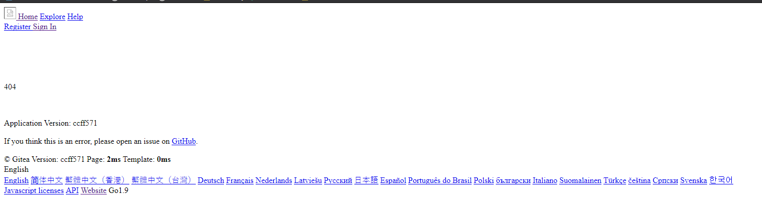

I'm still getting 404.
Here's what my configs currently look like:
/appdata/gitea/gitea/conf/app.ini
[server]
APP_DATA_PATH    = /data/gitea
SSH_DOMAIN       = mydomain.duckdns.org
HTTP_PORT        = 3000
ROOT_URL         = https://mydomain.duckdns.org/gitea
DISABLE_SSH      = false
SSH_PORT         = 22
LFS_START_SERVER = false
OFFLINE_MODE     = false
PROTOCOL         = http
/appdata/letsencrypt/nginx/site-confs
location /gitea {
  include /config/nginx/proxy.conf;
  proxy_pass http://192.168.1.207:3000;

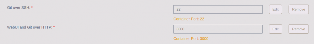

Thanks for this Docker. I am having issues changing the port. I assigned this to grab an IP from my network (so I can assign a domain to it), however I cannot get it to change ports. Everything works fine if I leave it on port 3000, but if I modify app.ini and restart, it doesn't work. If I change it back to 3000, it works. I've even modified this in the Docker template in unRAID. Any idea what could be going on, or what I am missing?
@CrunchyToast Don't change the port in the app.ini. The right way is to change the port in the Web-Frontend of the docker container. There you can change the port of the SSH and HTTP to everythink you like.
Thanks for your response. I did that, but it only wants to work on 3000 no matter what I do.

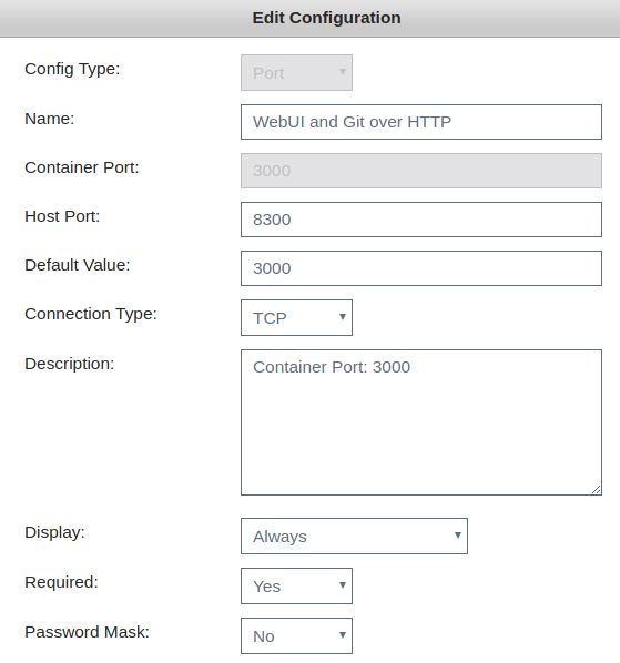

@CrunchyToast I made a fresh docker container installation of Gitea an it is working with different ports.
I only changed the input values of the fields SSH-Port (changed from 22 to 8022) and HTTP-Port (changed from 3000 to 8300).
Could it be, that you want to change to a port number, what is allready used by a other docker container?
Or, did you changed the network type? I am using "Bridge".
Here a detail screenshot of the http port setting.
The only problem on the install process of gitea with different http port, is the hard link to "http://localhost:3000/user/login" after the installation.

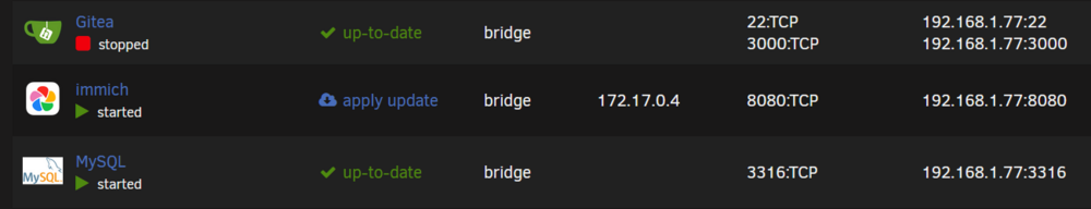

Hi guys!
I really need some help, because i am new to reverse proxy/letsencrypt thing.
Basically, i followed Spaceinvader One video about Nextcloud and letsencrypt:
No problems for nextcloud, but i can't configure gitea.
I created the file: user/appdata/letsencrypt/nginx/proxy-confs/gitea.subdomain.conf
server {
	listen 443 ssl;
    server_name gitea.*;
    include /config/nginx/ssl.conf;
    client_max_body_size 0;
    location / {
        resolver 127.0.0.11 valid=30s;
        set $upstream_gitea gitea;
        proxy_pass https://$upstream_gitea:3000;
Then edited the gitea config file:
[server]
SSH_DOMAIN       = gitea.mypersonaldomain.com
HTTP_PORT        = 8300
ROOT_URL         = https://gitea.mypersonaldomain.com:8300
DISABLE_SSH      = false
SSH_PORT         = 8022
LFS_CONTENT_PATH = /data/git/lfs
LFS_START_SERVER = true
LFS_JWT_SECRET   = ***********************************
The container uses port 8300 and 8022 for ssh.
The best i get is a 502 error when visiting gitea.mypersonaldomain.com:8300.
With these settings, the gitea web interface is unreachable even if i point to my localhost ip ( 192.168.1.200:8300 )
Any tips ?
