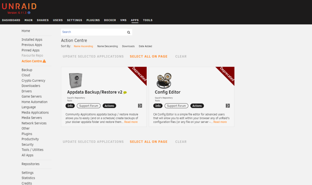

27 minutes ago, Kilrah said:
As mentioned it's deprecated "for all versions"
This isn’t true. The @KluthR version is not deprecated.
302231527_Screenshot2022-12-19at12_10_45PM.thumb.png.70414d80d36b9798e5585a13d396af28.png
1 minute ago, wgstarks said:
I assume this is meant to be for the unraid version.
The message means the Squid plugin is deprecated for all Unraid versions
Edited by Kilrah
When I search CA the version that lists you as the author isn’t marked as deprecated.
My mistake. I thought you were referring to all versions shown in CA.

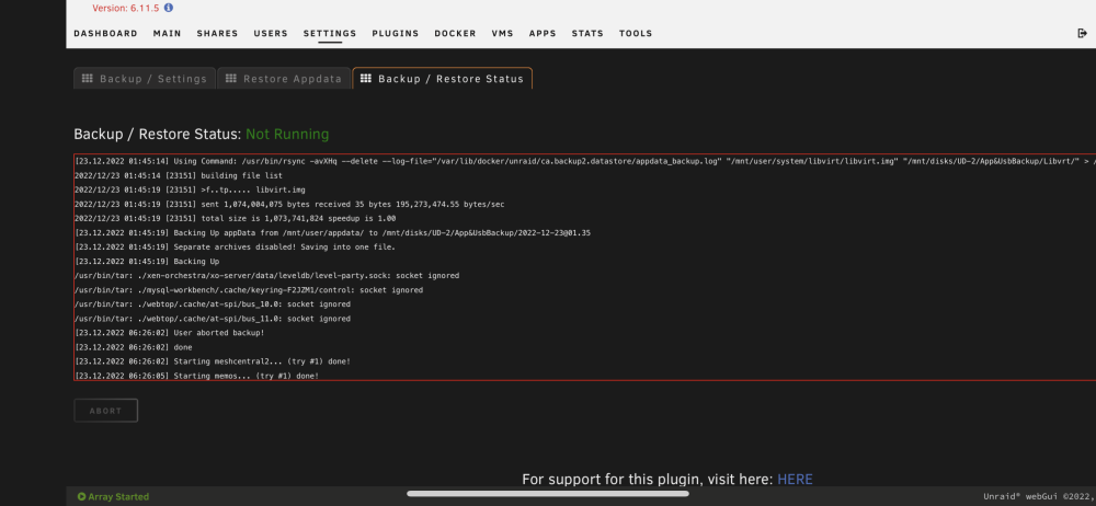

[20.12.2022 06:41:42] Backup / Restore Completed
Not good, is it possible to go back to old version, while these bugs are sorted?
Cheers,
Tim
