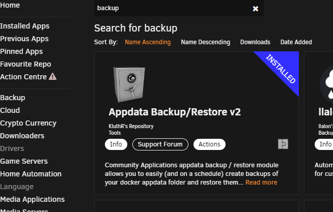

What am I doing wrong? I uninstalled the old version but don't see the new version when I search for it in apps.
It's in Plugins like the older one.
Edited by Kilrah
hmm, found it by choosing the backup category on the left but it wouldn't appear even just searching for the word "backup" for some reason.
Strange
