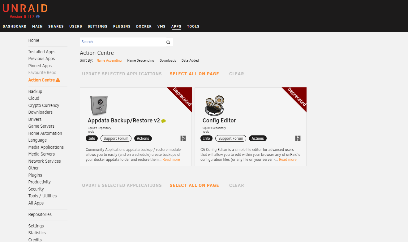

  • As of last night, on 6.10.3, fix common problems is alerting me that: The plugin ca.backup2.plg is not known to Community Applications and is possibly incompatible with your server. What's chang
  • This plugin has now been forked by @KluthR and the original version by myself has been deprecated.   I'd suggest to uninstall my version and then reinstall the fork.   NOTE:
Since installing the forked plugin (and uninstalling the original), the backup status is reporting an error occurred so it doesn't delete old backups, but there isn't an error displayed in the status window.  Any help diagnosing this?

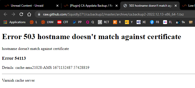

Github having issues it seems

My 'Action Centre' shows V2 as deprecated, see attached image.  Is there a "newer" new version??  I'm confused.
See "Recommended Post" linked at the top of every page in this thread.
