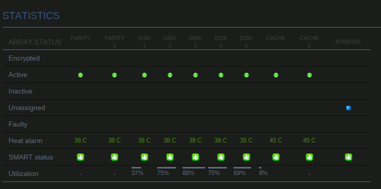

Dont have temps showing on NVME unassigned. But it shows correctly as Unassigned vs last release
Can you post the output of
smartctl -A /dev/nvme0
Just noticed than my unassigned disks also not reporting temp on the dashboard. almost sure it was working on rc10, it works on the main page, does yours shown on main? Maybe not NVMe related this time.
Right, a small regression error (wrong reference to disk) in Dashboard table.
Sorry for that, correction made.

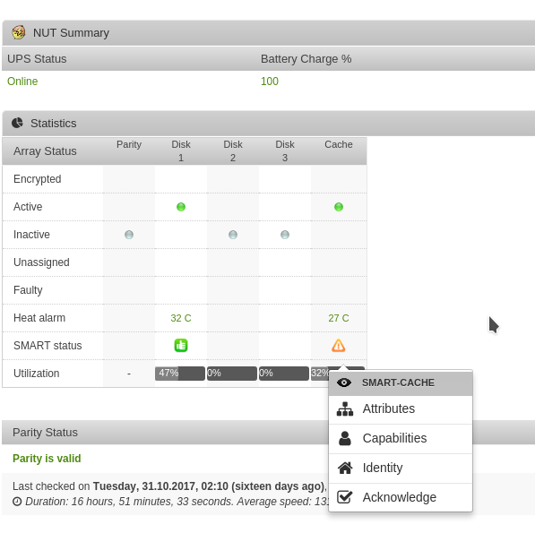

I have a ssd with a relocated sector.
on rc10 I could press acknowledge to get rid of the yellow triangle on the dashboard screen. Now this button does nothing.

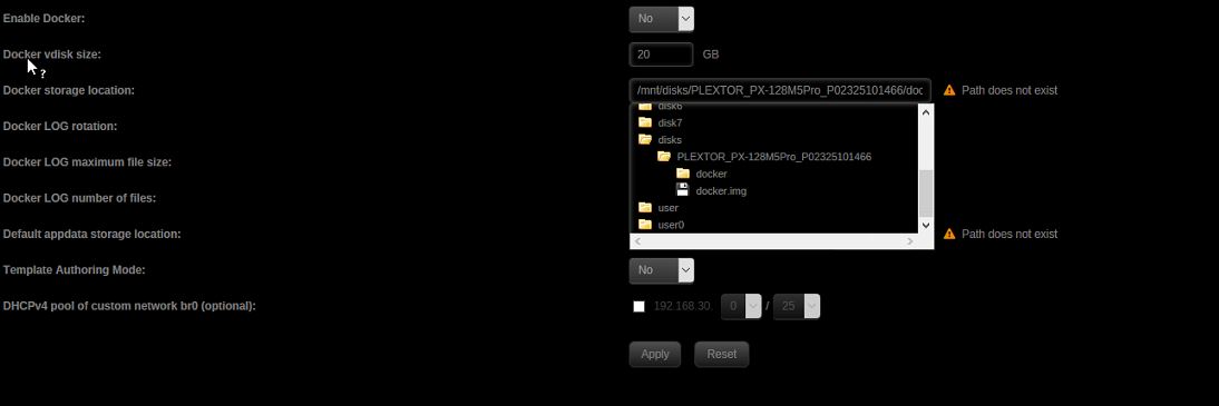

Did the docker settings change in this release?  After updating, my docker paths are now showing as invalid.
My docker paths point to an unassigned ssd drive that I've mounted and have been using for over a year specifically for docker. The docker.img and the appdata paths reside on this drive.
I've tried to reset the paths in the docker config to no avail.  I can select the docker image via the docker storage location field, but it still shows as invalid.  In the appdata storage location path, it won't allow me to choose the unassigned drive at all any more.
The ssd is functioning. I'm currently copying the docker data to a backup location.
I've included a screen shot of the error and the diagnostic files, should they be helpfulCaptureD.thumb.JPG.0b71d4e61935014e583997c9909f361c.JPG

44 minutes ago, Handl3vogn said:
on rc10 I culd press acknowledge to get red of the yellow triangle on the dashbord screen. Now this button does nothing
Right, you've found another regression error.
Accidentally a line deleted in the script code :( Corrected.
Docker settings have not changed.
The reason your path is invalid is because the mounting of the disk is not performed. This is in your syslog:
Tower unassigned.devices: Mounting 'Auto Mount' Devices...
Tower unassigned.devices: Disk with serial 'PLEXTOR_PX-128M5Pro_P02325101466', mountpoint 'PLEXTOR_PX-128M5Pro_P02325101466' is not set to auto mount and will not be mounted...
Tower unassigned.devices: Disk with serial 'ST9250315AS_5VC7XXWG', mountpoint 'binky' is not set to auto mount and will not be mounted...
I mounted the drive manually as part of my testing process and the drive was indeed mounted when I attempted to run docker.  See image below.
To confirm that not using auto mount may have been an issue, I restarted the array with auto mount enabled.
I still have the same issue.
As part of this, the default appdata used to let me go to the /mnt directory and choose which disk I wanted to put my appdata folder on. It now goes to the user/array folder and does not let me drill down further intro the tree.
My next testing step will be to copy the docker.img and appdata folders to a different drive and see if they are recognized.
