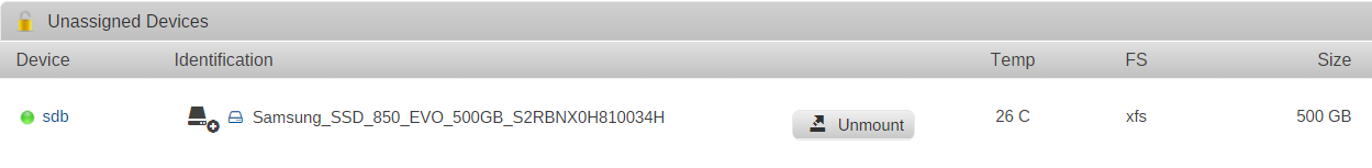

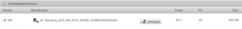

My 2 SSD show high temp in Dashboard, but UD shows normal temp.
  •  Samsung_SSD_840_EVO
  •  SAMSUNG_SSD_830
//Peter

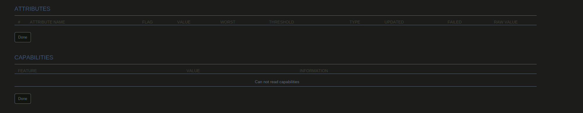

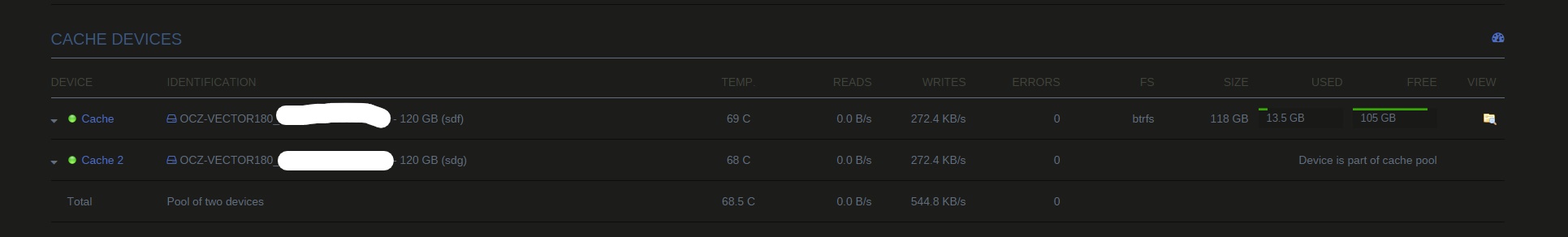

Since this release my SSDs (not that hot in reality) are reporting as 68/69ºC ... and I can't bring up their normal SMART attributes.
smartctl correctly reports line 190 as 31ºC
smartctl -a /dev/sdf
190 Airflow_Temperature_Cel 0x0000   100   100   000    Old_age   Offline      -       31
