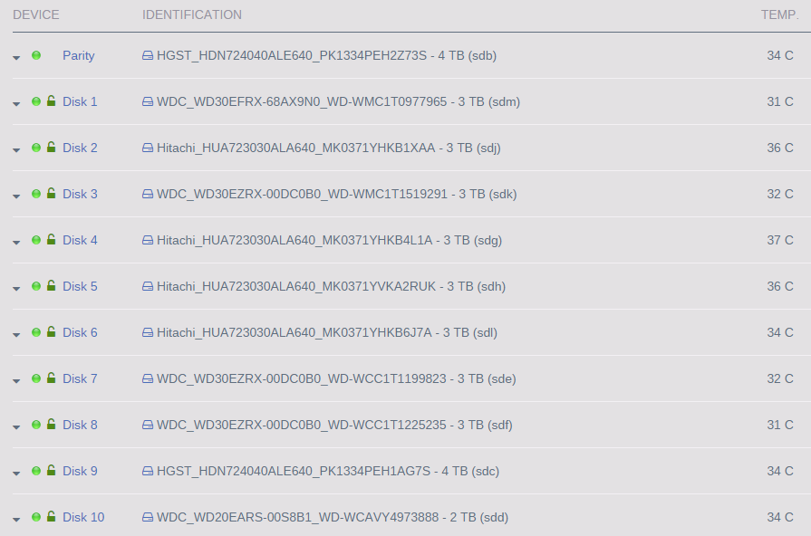

On 12/9/2017 at 9:13 AM, bonienl said:
unRAID 6.4 introduces encrypted volumes and allows individual disks to be protected by encryption.
The passphrase or keyfile which is used to unlock encryption is not permanently stored on the system itself, this means that upon a system start one has to re-enter the passphrase or re-select the keyfile. Until then the array can not start and the GUI will report a "missing key".
But what if we want to auto-start the array and not keep a local copy on the system itself? It kind of defeats the protection scheme to store a local copy, i.e. when your system get stolen, you don't want to include the keys to allow access.
The solution I have come up is to download the keyfile during startup from a different system in my local network which is in a different part of the house. In my case I am using an arbitrary .png file, but you could also store a passphrase and have this copied over. In my go file I added the following lines to download the keyfile from a remote SMB share before starting emhttp.
# auto unlock array
mkdir -p /unlock
mount -t cifs -o user=name,password=password,iocharset=utf8 //192.168.1.123/index /unlock
cp -f /unlock/#/some.png /root/keyfile
umount /unlock
rm -r /unlock
Of course the remote share must be accessible when the system starts and surely this approach can be cracked, but it is definitely safer than just keeping a local copy of the keyfile on the unRAID server itself.
Remember that once the array is started, the local keyfile may be deleted if you really don't want to keep the key while the system is operational.
Perhaps my idea is useful for others wanting to do something similar :)
