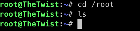

On 5/27/2022 at 12:58 AM, Vaggeto said:
Has anyone had this process break once updating to 6.10 or other newer versions? I went from like 6.7 or 6.8 to 6.10.
It just doesn't work now but did consistently . I'm not seeing any message in the console, but I could just be missing it.
My auto-start fixed itself with 6.10.2 with no changes to the scripting.

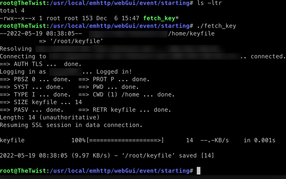

I'm able to run each step of the below 'fetch_key' script in terminal without issue,
#!/bin/bash
if [[ ! -e /root/keyfile ]]; then
  mkdir -p /keys
  mount -t cifs -o user='username',password='secret_key',iocharset=utf8 //'IP ADDRESS'/keys
 /keys
  cp -f /keys/AMD_array/keyfile /root/keyfile
  umount /keys
  rm -r /keys
fi
but when trying to run the script itself, i'm getting two errors.
root@Tower:~# bash /usr/local/emhttp/webGui/event/starting/fetch_key
/usr/local/emhttp/webGui/event/starting/fetch_key: line 2: $'\r': command not found
/usr/local/emhttp/webGui/event/starting/fetch_key: line 11: syntax error: unexpected end of file

Your script file contains DOS/Windows style line endings (\r\n), this is what confuses your shell. Try to save it with unix line endings (\n).
You can execute
sed -i "s/\r//" /usr/local/emhttp/webGui/event/starting/fetch_key
 then check it again.
If that works, you'll need to convert the fetch_key and delete_key on the boot drive. You should try to simplify the go file by using the install command.
https://forums.unraid.net/topic/61973-encryption-and-auto-start/?do=findComment&comment=648148
That worked. It removed the windows formatting. I also updated the go file to use the new install commands and that worked as well. What's the main reason for using the three install commands instead of the copy and changing permissions? Just reducing the amount of lines in go?
Thanks for the pointers and help.

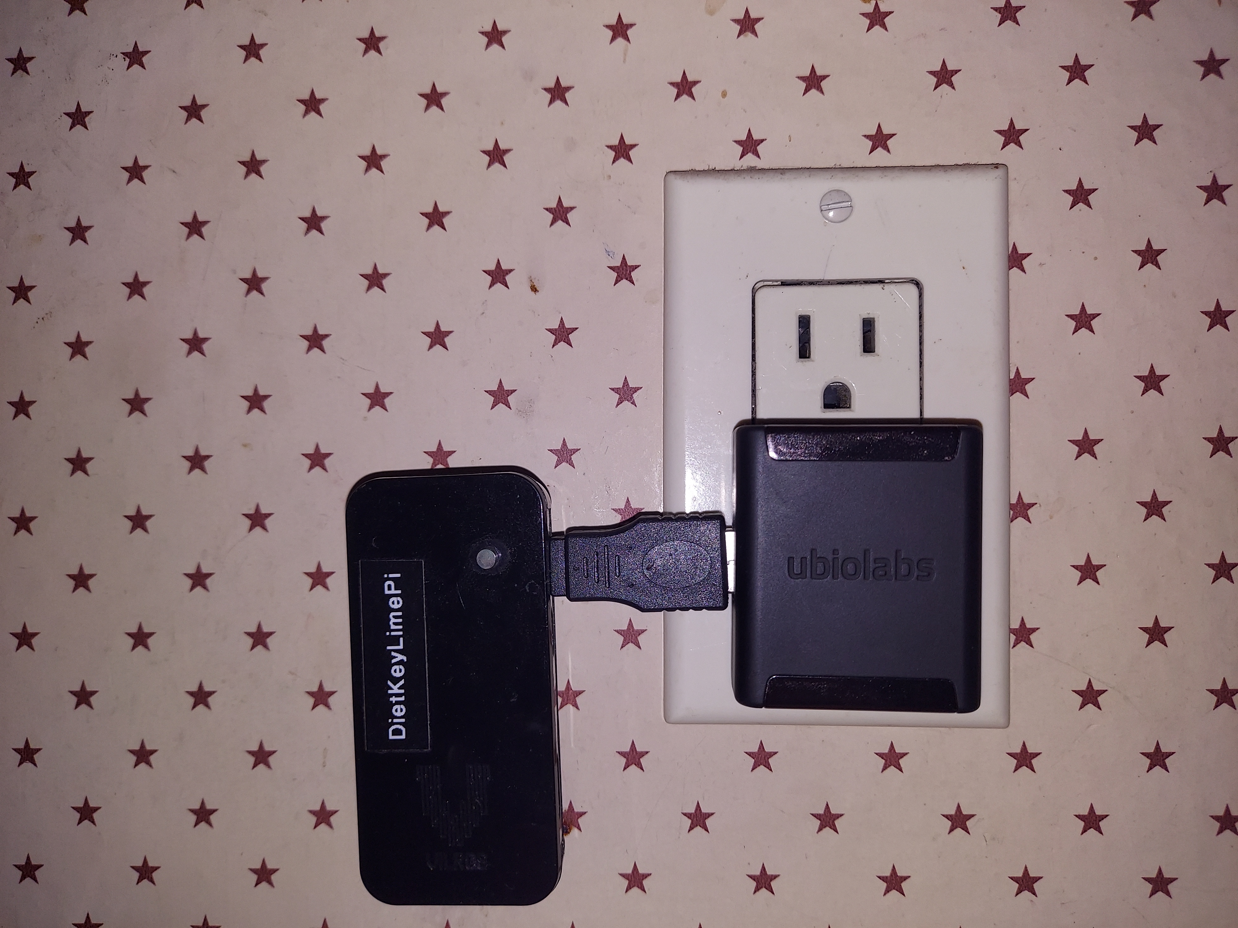

Now that the Raspberry Pi Zero W is available and we’re not being scalped, I thought I’d share how to make your own key server. It is tailored to the Raspberry Pi Zero W for various reasons. A Raspberry Pi Zero 2 W could be used, it will slightly cost more and consume a little more power. Any other Raspberry Pi may or may not function properly.
To save power it is configured to be headless, blue tooth and serial console disabled. The time synchronization daemon (ntpd) is not installed and time is synchronized only once a day and at boot.  The activity LED is limited to off, and two styles of flashing.
I’ve attached a photo of my Diet Key Lime Pi.

Hello, would anyone know how to set this up with tailscale? I'm storing my keyfile in another offsite server connected through tailscale. Do plugins start before the go file? If not, how can I have the go file wait for it to start?
