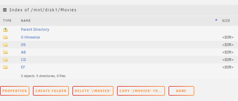

I think very basic functions should be added to the "view" function of shares and disks of the web UI. For example:
  1. Properties = Show amount of Files and Dirs + Total Size
  2. Create Folder = Opens dialog to create a folder with Name XYZ
  3. Delete '/Movies' = Opens a dialog with a warning "This deletes '/Movies' with all its contents"
  4. Copy '/Movies' to... = Opens a dialog with two dropdowns. 1st dropdown contains the list of shares and disks and 2nd updates to the folder structure of the selected share/disk. The dialog should contain a checkbox to allow "move" instead of "copy" as well.
  5. Create ZIP = Creates a ZIP of the directory (not visible in example)
  6. Upload = Upload a file through the browser (not visible in example)
I think this should be sufficient for the most users.
Edited by mgutt
