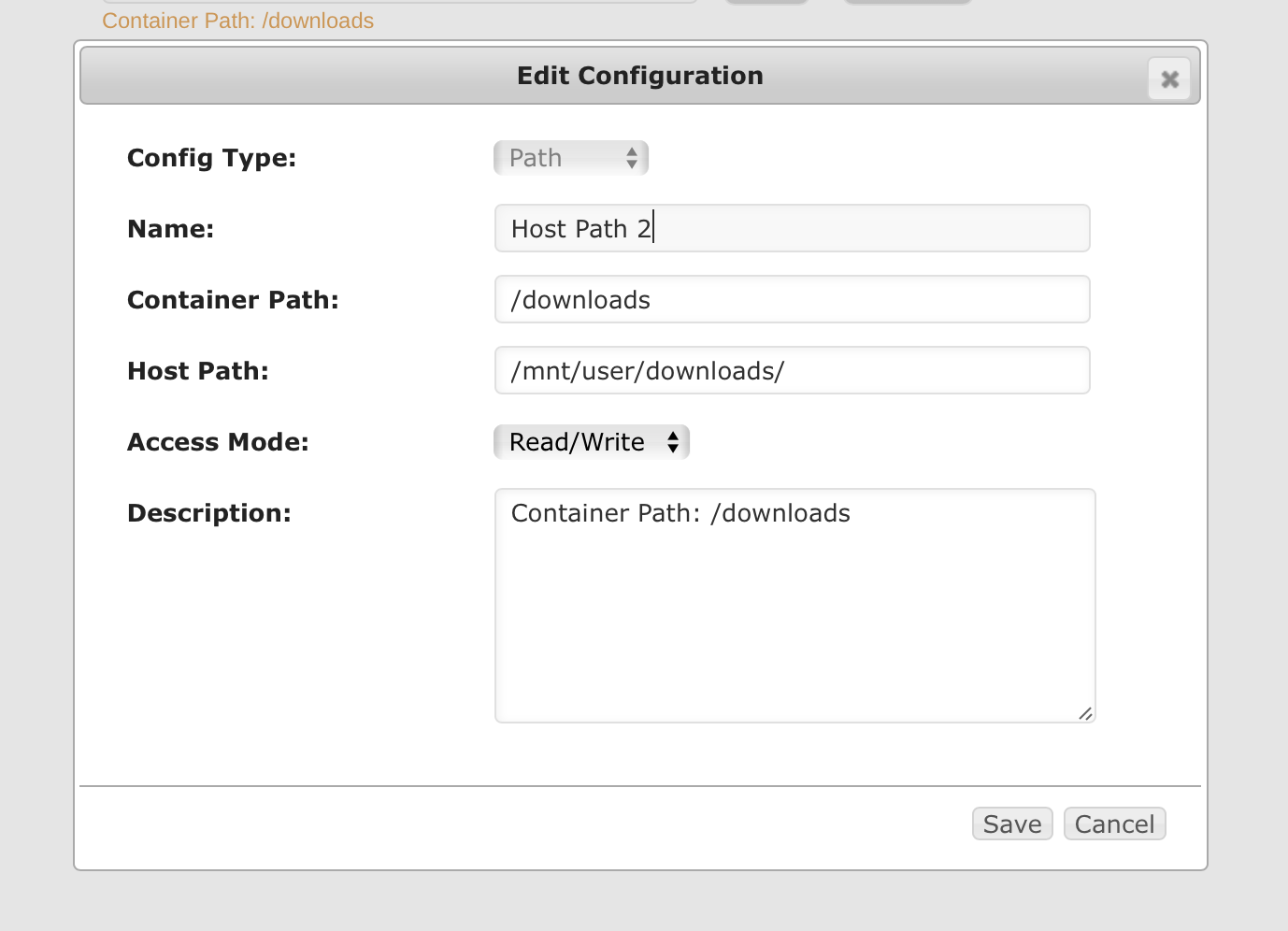

On 24/12/2017 at 4:30 PM, ice pube said:
I read that and my mappings look correct to me. Both radarr and sonarr have the same mappings and work without issue.
I must be missing something but I am out of ideas.
I had the same issue, I fixed this by editing the template ... Changed /data to /downloads and worked straight away :)
5a5fe8ce99294_ScreenShot2018-01-18at00_22_07.thumb.png.6188fffeed47a9b14db4f477664ac39d.png
