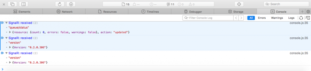

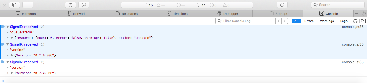

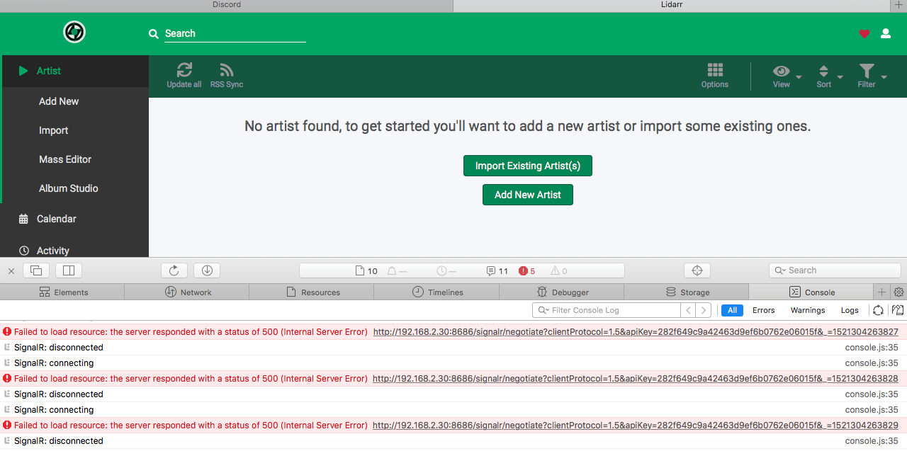

@binhex working with the lidarr guys the signalr fix is to add an ENV
ENV XDG_CONFIG_HOME="/config/xdg"
how that translates to your config mount i'm not sure
Thanks sparklyballs i appreciate you posting that, any chance of some more details (link to issue?) as im not 100% clear of the current problem (i don't use lidarr myself) and want to ensure any changes to my code fix whatever the issue is.
cheers.
cheers.
all of the conversation took place on discord with one of the lidarr team reporting the problem directly to us from issues from users in their discord thread
basically without the variable in the js console of browsers it reports 500 errors and signalr disconnect/reconnect loop
we had a similar issue with sonarr few years back https://github.com/linuxserver/docker-sonarr/issues/3
Edited by sparklyballs
basically without the variable in the js console it reports 500 errors and signalr disconnect/reconnect loop
ahh right, interesting you had the same/similar issue with sonarr, to this day i don't have that env var in for sonarr, and so far no reported issues of disconnect/reconnect issues, but hey i guess my image doesn't get the same sort of interest as the LSIO one, so maybe it is an issue and i just don't know about it :-).
ok well its painless for me to include the env var, so for now i will add it in, im assuming this is something that is required for lidarr going forward and this isnt just a temporary hack right?.
i would treat it as a permanent thing until someone says otherwise as i'm not aware of it causing any issues and you don't need to make a folder or touch a file or anything
just having the ENV alleviates the problem
perfect, thanks again for the info.
