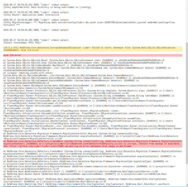

2018-09-17 19:34:02.985572 [info] System information Linux 0e75fe0edf53 4.18.8-unRAID #1 SMP Sat Sep 15 09:15:50 PDT 2018 x86_64 GNU/Linux
2018-09-17 19:34:03.003646 [info] PUID defined as '99'
2018-09-17 19:34:03.052851 [info] PGID defined as '100'
2018-09-17 19:34:03.103273 [info] UMASK defined as '000'
2018-09-17 19:34:03.120460 [info] Permissions already set for volume mappings
2018-09-17 19:34:03.139694 [info] Starting Supervisor...
2018-09-17 19:34:03,372 INFO Included extra file "/etc/supervisor/conf.d/lidarr.conf" during parsing
2018-09-17 19:34:03,372 INFO Set uid to user 0 succeeded
2018-09-17 19:34:03,373 INFO supervisord started with pid 8
2018-09-17 19:34:04,375 INFO spawned: 'lidarr' with pid 48
2018-09-17 19:34:04,375 INFO reaped unknown pid 9
2018-09-17 19:34:04,577 DEBG 'lidarr' stdout output:
[Info] Bootstrap: Starting Lidarr - /usr/lib/lidarr/Lidarr.exe - Version 0.3.1.471
2018-09-17 19:34:04,884 DEBG 'lidarr' stdout output:
[Info] AppFolderInfo: Data directory is being overridden to [/config]
2018-09-17 19:34:04,947 DEBG 'lidarr' stdout output:
[Info] Router: Application mode: Interactive
2018-09-17 19:34:05,059 DEBG 'lidarr' stdout output:
[Info] MigrationLogger: *** Migrating data source=/config/lidarr.db;cache size=-10485760;datetimekind=Utc;journal mode=Wal;pooling=True;version=3 ***
2018-09-17 19:34:05,113 DEBG 'lidarr' stdout output:
2018-09-17 19:34:05,427 DEBG 'lidarr' stdout output:

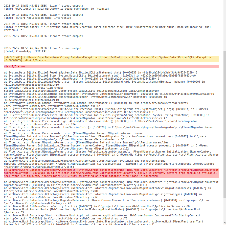

[Fatal] ConsoleApp: EPIC FAIL!
[v0.3.1.471] NzbDrone.Core.Datastore.CorruptDatabaseException: Lidarr failed to start: Database file: System.Data.SQLite.SQLiteException (0x80004005): disk I/O error
disk I/O error
at System.Data.SQLite.SQLite3.Prepare (System.Data.SQLite.SQLiteConnection cnn, System.String strSql, System.Data.SQLite.SQLiteStatement previous, System.UInt32 timeoutMS, System.String& strRemain) [0x0033c] in <61a20cde294d4a3eb43b9d9f6284613b>:0
at System.Data.SQLite.SQLiteCommand.BuildNextCommand () [0x000f6] in <61a20cde294d4a3eb43b9d9f6284613b>:0
at System.Data.SQLite.SQLiteCommand.GetStatement (System.Int32 index) [0x00008] in <61a20cde294d4a3eb43b9d9f6284613b>:0
at (wrapper remoting-invoke-with-check) System.Data.SQLite.SQLiteCommand.GetStatement(int)
at System.Data.SQLite.SQLiteDataReader.NextResult () [0x0011e] in <61a20cde294d4a3eb43b9d9f6284613b>:0
at System.Data.SQLite.SQLiteDataReader..ctor (System.Data.SQLite.SQLiteCommand cmd, System.Data.CommandBehavior behave) [0x00090] in <61a20cde294d4a3eb43b9d9f6284613b>:0
at (wrapper remoting-invoke-with-check) System.Data.SQLite.SQLiteDataReader..ctor(System.Data.SQLite.SQLiteCommand,System.Data.CommandBehavior)
at System.Data.SQLite.SQLiteCommand.ExecuteReader (System.Data.CommandBehavior behavior) [0x0000c] in <61a20cde294d4a3eb43b9d9f6284613b>:0
at System.Data.SQLite.SQLiteCommand.ExecuteNonQuery (System.Data.CommandBehavior behavior) [0x00006] in <61a20cde294d4a3eb43b9d9f6284613b>:0
at System.Data.SQLite.SQLiteCommand.ExecuteNonQuery () [0x00006] in <61a20cde294d4a3eb43b9d9f6284613b>:0
at System.Data.SQLite.SQLiteConnection.Open () [0x00959] in <61a20cde294d4a3eb43b9d9f6284613b>:0
at FluentMigrator.Runner.Processors.GenericProcessorBase.EnsureConnectionIsOpen () [0x0000e] in C:\Users\Mark\Source\Repos\fluentmigrator\src\FluentMigrator.Runner\Processors\GenericProcessorBase.cs:54
at FluentMigrator.Runner.Processors.SQLite.SQLiteProcessor.Exists (System.String template, System.Object[] args) [0x00000] in C:\Users\Mark\Source\Repos\fluentmigrator\src\FluentMigrator.Runner\Processors\SQLite\SQLiteProcessor.cs:78
at FluentMigrator.Runner.Processors.SQLite.SQLiteProcessor.TableExists (System.String schemaName, System.String tableName) [0x00000] in C:\Users\Mark\Source\Repos\fluentmigrator\src\FluentMigrator.Runner\Processors\SQLite\SQLiteProcessor.cs:47
at FluentMigrator.Runner.VersionLoader.get_AlreadyCreatedVersionTable () [0x00000] in C:\Users\Mark\Source\Repos\fluentmigrator\src\FluentMigrator.Runner\VersionLoader.cs:124
at FluentMigrator.Runner.VersionLoader.LoadVersionInfo () [0x00028] in C:\Users\Mark\Source\Repos\fluentmigrator\src\FluentMigrator.Runner\VersionLoader.cs:160
at FluentMigrator.Runner.VersionLoader..ctor (FluentMigrator.Runner.IMigrationRunner runner, FluentMigrator.Infrastructure.IAssemblyCollection assemblies, FluentMigrator.IMigrationConventions conventions) [0x00077] in C:\Users\Mark\Source\Repos\fluentmigrator\src\FluentMigrator.Runner\VersionLoader.cs:50
at FluentMigrator.Runner.MigrationRunner..ctor (FluentMigrator.Infrastructure.IAssemblyCollection assemblies, FluentMigrator.Runner.Initialization.IRunnerContext runnerContext, FluentMigrator.IMigrationProcessor processor) [0x00167] in C:\Users\Mark\Source\Repos\fluentmigrator\src\FluentMigrator.Runner\MigrationRunner.cs:102
at FluentMigrator.Runner.MigrationRunner..ctor (System.Reflection.Assembly assembly, FluentMigrator.Runner.Initialization.IRunnerContext runnerContext, FluentMigrator.IMigrationProcessor processor) [0x00000] in C:\Users\Mark\Source\Repos\fluentmigrator\src\FluentMigrator.Runner\MigrationRunner.cs:72
at NzbDrone.Core.Datastore.Migration.Framework.MigrationController.Migrate (System.String connectionString, NzbDrone.Core.Datastore.Migration.Framework.MigrationContext migrationContext) [0x000b5] in C:\projects\lidarr\src\NzbDrone.Core\Datastore\Migration\Framework\MigrationController.cs:58
at NzbDrone.Core.Datastore.DbFactory.CreateMain (System.String connectionString, NzbDrone.Core.Datastore.Migration.Framework.MigrationContext migrationContext) [0x0000b] in C:\projects\lidarr\src\NzbDrone.Core\Datastore\DbFactory.cs:122 is corrupt, restore from backup if available. See: https://github.com/Lidarr/Lidarr/wiki/FAQ#i-am-getting-an-error-database-disk-image-is-malformed
at NzbDrone.Core.Datastore.DbFactory.CreateMain (System.String connectionString, NzbDrone.Core.Datastore.Migration.Framework.MigrationContext migrationContext) [0x00045] in C:\projects\lidarr\src\NzbDrone.Core\Datastore\DbFactory.cs:133
at NzbDrone.Core.Datastore.DbFactory.Create (NzbDrone.Core.Datastore.Migration.Framework.MigrationContext migrationContext) [0x00027] in C:\projects\lidarr\src\NzbDrone.Core\Datastore\DbFactory.cs:81
at NzbDrone.Core.Datastore.DbFactory.Create (NzbDrone.Core.Datastore.Migration.Framework.MigrationType migrationType) [0x00000] in C:\projects\lidarr\src\NzbDrone.Core\Datastore\DbFactory.cs:69
at NzbDrone.Core.Datastore.DbFactory.RegisterDatabase (NzbDrone.Common.Composition.IContainer container) [0x00000] in C:\projects\lidarr\src\NzbDrone.Core\Datastore\DbFactory.cs:47
at NzbDrone.Host.NzbDroneServiceFactory.Start () [0x00037] in C:\projects\lidarr\src\NzbDrone.Host\ApplicationServer.cs:60
at NzbDrone.Host.Router.Route (NzbDrone.Host.ApplicationModes applicationModes) [0x0007f] in C:\projects\lidarr\src\NzbDrone.Host\Router.cs:55
at NzbDrone.Host.Bootstrap.Start (NzbDrone.Host.ApplicationModes applicationModes, NzbDrone.Common.EnvironmentInfo.StartupContext startupContext) [0x0003d] in C:\projects\lidarr\src\NzbDrone.Host\Bootstrap.cs:78
at NzbDrone.Host.Bootstrap.Start (NzbDrone.Common.EnvironmentInfo.StartupContext startupContext, NzbDrone.Host.IUserAlert userAlert, System.Action`1[T] startCallback) [0x00075] in C:\projects\lidarr\src\NzbDrone.Host\Bootstrap.cs:41
at NzbDrone.Console.ConsoleApp.Main (System.String[] args) [0x00029] in C:\projects\lidarr\src\NzbDrone.Console\ConsoleApp.cs:38
2018-09-17 19:34:05,427 INFO success: lidarr entered RUNNING state, process has stayed up for > than 1 seconds (startsecs)
2018-09-17 19:34:05,436 DEBG 'lidarr' stdout output:
Press enter to exit...
2018-09-17 19:34:06,436 DEBG 'lidarr' stdout output:
Non-recoverable failure, waiting for user intervention...
From <https://ba38b4426689c3df9029cd275e6e37518af21f76.unraid.net/plugins/dynamix.docker.manager/include/Events.php?action=log&container=0e75fe0edf53&title=Log%20for:%20binhex-lidarr>

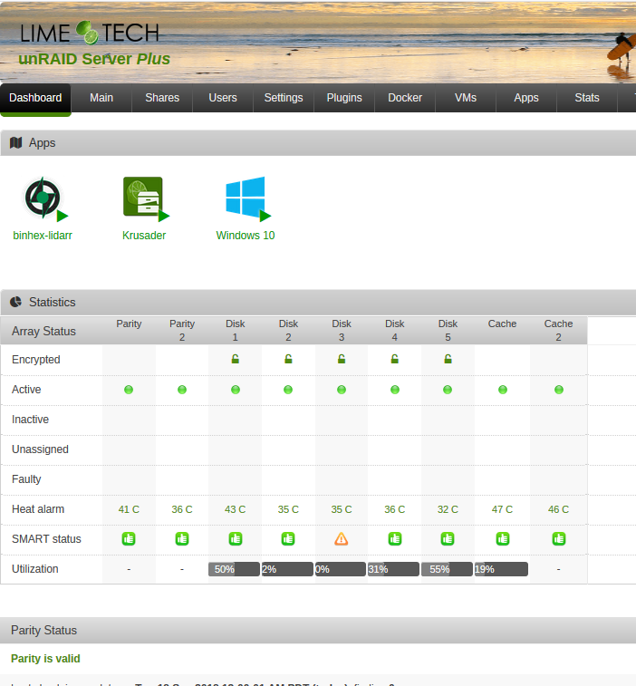

Edited by Do2a-2d

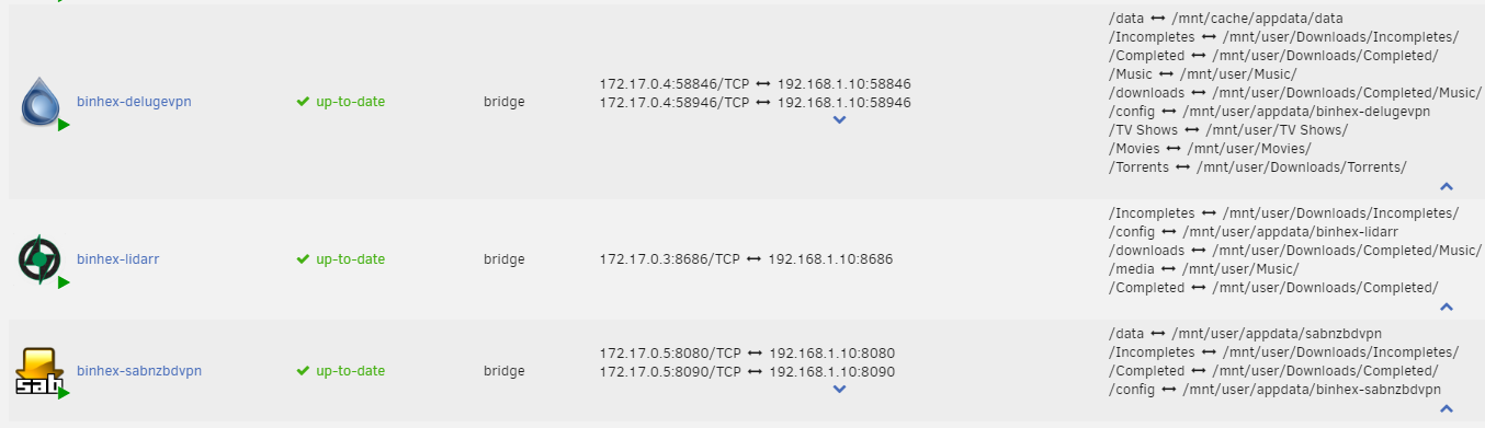

@binhex He's crossposted in our thread and I wonder if it's an issue with sqlite and the FUSE fs. Hasn't responded yet to my post. Just a heads up and illustrates @trurls point about crossposting quite nicely...
Sent from my Mi A1 using Tapatalk
ahh a good point YES fuse i forgot about that old chestnut, hmm i wish the default host path wasnt /mnt/user for docker on unraid, ho hum, thanks for the heads up, lets hope its just that.
I am sorry but I do not know what that means.
This is what I did do last night...
On all the dockers I changed the path for the config file to /mnt/cache/appdata/xyz_container.  This brought up the web UI for

Hi, I'm getting the following error persistent in all logs:
[Error] DownloadedTracksImportService: Import failed, path does not exist or is not accessible by Lidarr: /data/complete/
I believe my mappings are correct:
Internal Lidarr log (many like this):
19-1-7 21:20:10.1|Error|DownloadedTracksImportService|Import failed, path does not exist or is not accessible by Lidarr: /data/complete/Stevie_Ray_Vaughan_And_Double_Trouble-Texas_Flood-(Legacy_Edition)-2CD-2013-404
ok and how have you configured lidarr?, im assuming you have it pointing at '/data/complete/' right?, if so does '/mnt/user/downloads/complete/' exist on unraid?
Edited by binhex
Thank you for the response!
This is how I have it configured:
It doesn't let me choose a path that doesn't exist? Also, that's how my other dockers have been functioning perfectly for a while.
If I look in Krusader, the directory is Root > media > user > downloads > complete.
thats a screenshot of how the container is configured, what i am interested in is a screenshot of how you have configure the web ui for lidarr, in particular any references to /data

Hi Guys
  I finally almost got all my system running 100%...apart from the final bit of Lidarr.  I use SABnzbd, Radarr, Sonarr and Lidarr - all from Binhex as I was advised its best to stick to same dockers.
In Radar and Sonarr the tv series and movies are cleaned up of rubbish files renamed and moved from downloads complete folder to the relevant Media plex folder, unfortunately, all music downloads are left in Complete downloads music, with all the rubbish files left in the folder.
the paths in the Lidarr edit setup are same as the other two dockers.
Please help me with what has been a steep learning curve.
Thanks
K

I am having an issue similar to mcjfauser.  I have two download clients setup in lidarr - Deluge and SABnzdb.  SABnzdb is setup with a category of music, which is adds the file to the subdirectory of the local mapping of /Completed.  However, in Deluge, it first goes into /Incompletes, and then I have the label plugin move it to the /Completed/Music folder after the download completes.  The files downloaded from SABnzbd get imported into lidarr fine, but I can't get anything from Deluge to come over.  As you can see, I have tried several different mappings to get this to work.  Any suggestions without having to redo my setup in Deluge?
Edited by scbuckeye75
Unhide post
In response to your report of your own post. Your post was hidden because you had not yet been approved for posting on the forum. We get a lot of spammers so we have to approve the first post of any user.
Did you see the response to mcjfauser?
Do you understand volume mapping? Some of those seem like a shot in the dark.
Since I don't use any of those containers, I will just direct you to the Docker FAQ and let others help you with the details.
https://forums.unraid.net/topic/57181-real-docker-faq/
This in particular might be relevant:
https://forums.unraid.net/topic/57181-real-docker-faq/?page=2#comment-566086
Thanks for the response and letting me know about the reason my post was hidden.
Yes, I did, and I do not see where in the GUI to make those settings.
Yes, I understand volume mappings.  I was trying several different things because I could not get it to work.  I normally do not have all of those volume mappings.  I cannot find in GUI where you set the /download directory for each download client.
