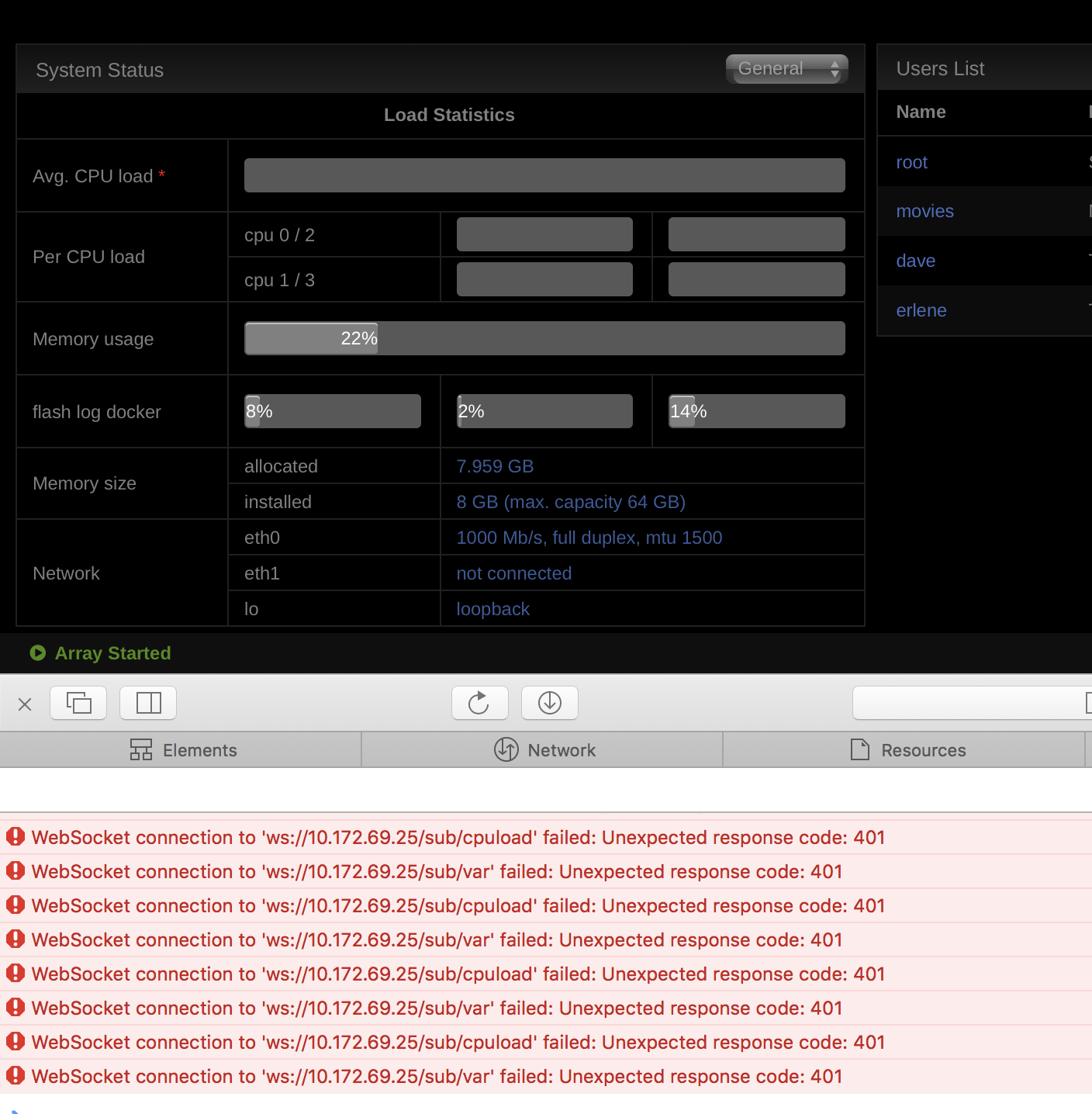

Just updated, will report any shenanigans if I see any ?
@spl147 have you tried using the safari technology preview?
same results

On 1/4/2018 at 7:00 AM, starbix said:
The web terminal works for me in safari. Are there specific features that don't work, or is there something special about my Safari installation?
If you enable password authentication (by setting a password for the root user) then Safari will have issues with the web terminal and the CPU meters on the dashboard.
