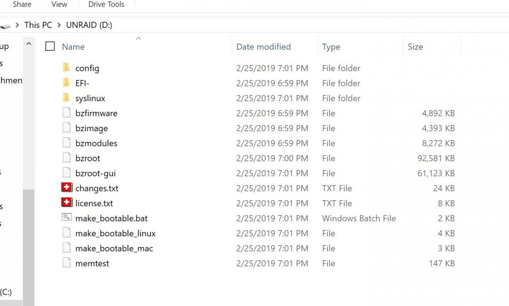

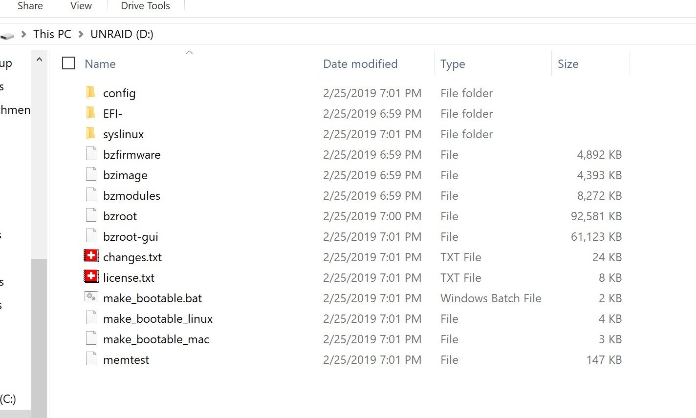

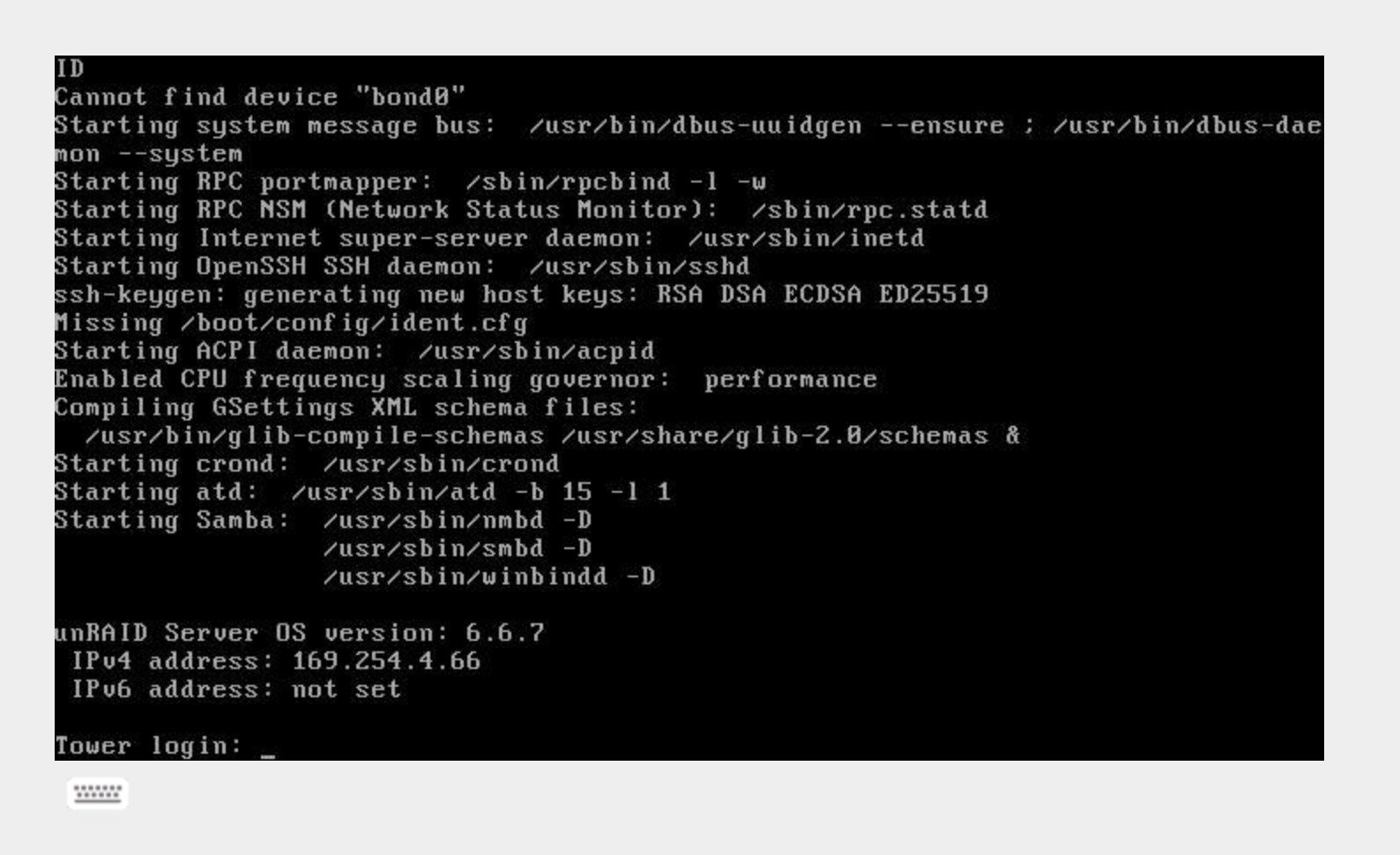

I am new to Unraid and I am having a similar problem getting Unraid to boot for the first time.  I have tried different usb locations and different usb drives.  I have attached a screenshot of the terminal.  Please advise.
That looks like its booting, but you're not getting an IP address
Login as root (no password), then enter in
diagnostics
And then post the zip file stored on the flashdrive (logs folder) here

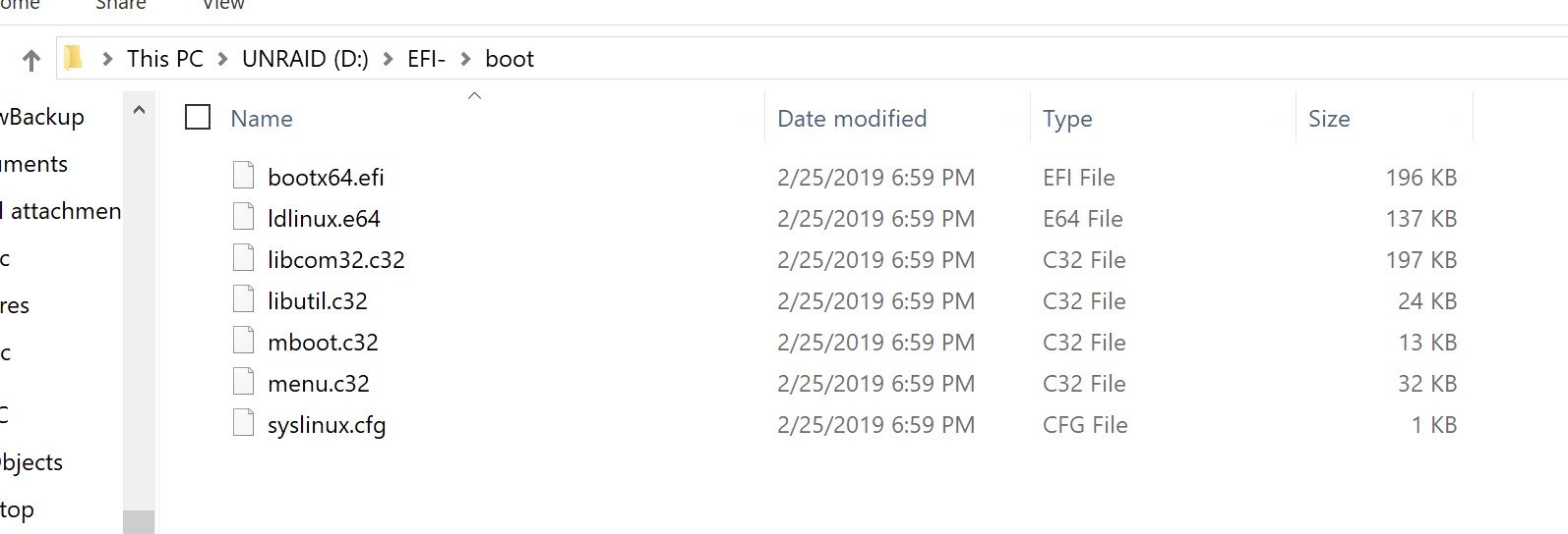

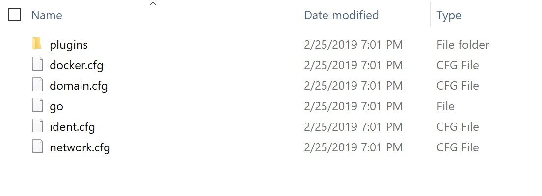

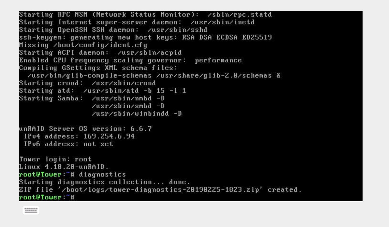

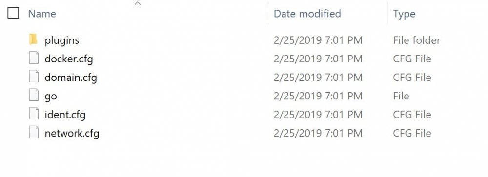

I did as asked but there is no logs folder on usb.  I noted the execution of the cmd "diagnostics" and it indicated that a zip file was created but the usb has no folder or subfolder "logs".  Not sure what happened to it.
If you login and issue the ‘df’ command does it show anything mounted as /boot.   If the boot process completed correctly this is where the flash drive should be mounted.  If it is not being successfully mounted then it could explain your symptoms.
If there is no /boot shown perhaps you can tell us more about how you prepared the flash drive; what make and model it is (USB2.0 drives seem to be more reliable); and whether you have it plugged into a USB2 or a USB3 port (again USB2 seems more reliable).
"Module bonding not found" always means the usb flash device is not prepared correctly or has other problems.  This is because we loopback-mount an image file, 'bzmodules', at /lib/modules very early in boot process.  This image contains all the Linux loadable modules, ie, drivers, and typically the network is first to startup and hence kernel needs to load the 'bonding' module.  If the image file is corrupted or not found, or wrong for the release, etc., you will see this message.
