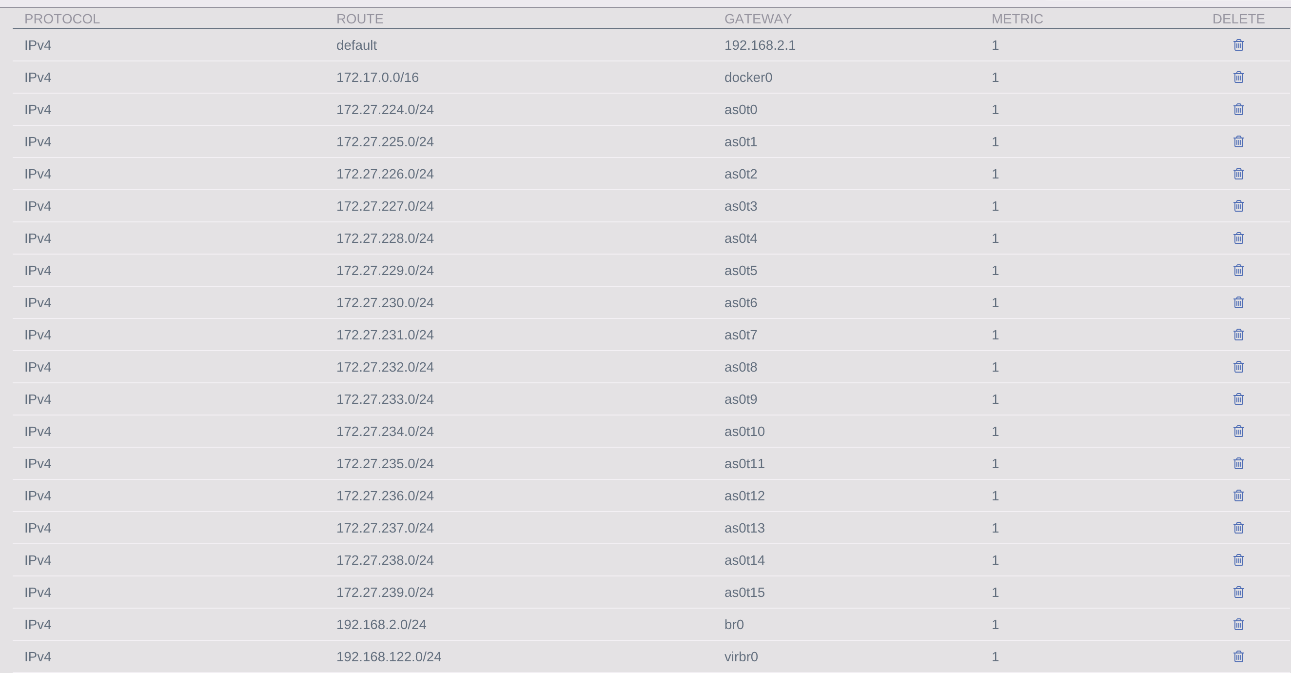

I went to the routing table in network settings and noticed a bunch of entries that I have no idea what they do. Namely as0t0 ... 15. I have some friends who run the same containers I do and have none of these entries. Could it be some kind of routing issue? I am completely stumped. If I switch all of the containers back to the unRaid IP, everything starts to work again.

I don't understand where all these 172.27.xxx.yyy networks (as0tx) come from. Never seen that before.
Isn't 172.*.*.* docker container native network?  No idea how it made it into the Unraid webui though......
seems like it. If I disable Docker in unRaid, all of those entries go away in the routing table
1 minute ago, bonienl said:
Docker is 172.17.xxx.yyy
It's kinda close.... :)
as0tX interfaces seem to be OpenVPN-AS interfaces...
I do have this installed. Thank you.
