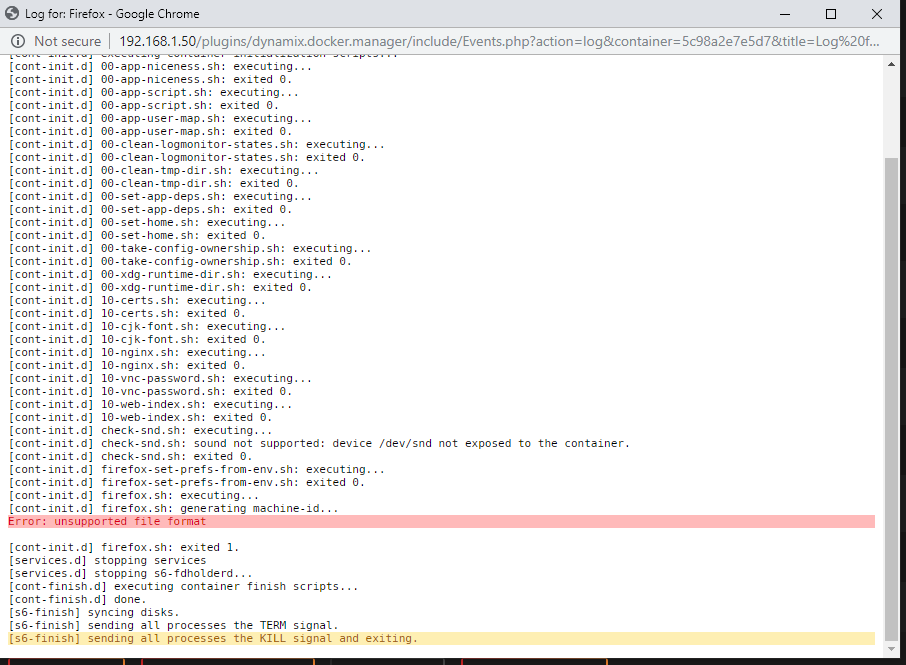

Hi
My firefox docker has just started failing to start. ive tried completely removing it and reinstalling it but no luck. See log.
Because of the error listed, maybe post your diagnostics and the docker run command
Theres my unraid diags.
 Not sure what you mean by the docker run command. Could you elaborate?
media-diagnostics-20190818-1515.zip
Edited by dfox1787
You seem to have corrupted file(s) in your appdata folder.  Can you try to start with a fresh appdata folder:
  • Stop the container.
  • Move the appdata folder: mv /mnt/user/appdata/Firefox /mnt/user/appdata/Firefox.backup
  • Start the container.
thank you that worked.
