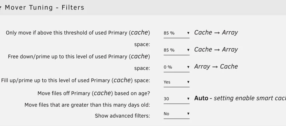

Can anyone tell me if i have this right? The way ive set it, it only moves stuff that’s older than 30 days IF 85% or more of the cache is full, right? The old mover tuning had a “force move it over xx% of cache” which i really liked bc that way if i have no files over 30 days old it wouldn’t keep them in cache if it got more full than 85% or whatever i set it to. IMG_6715.webp.2bf522d0afae8b1a5a18d490ac18511c.webp

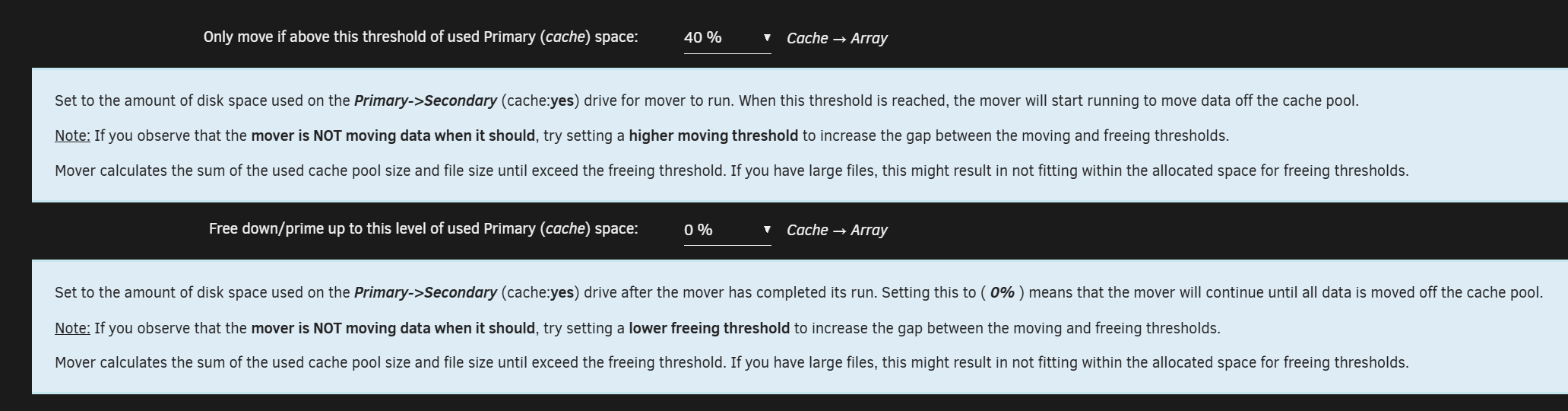

That second option is wrong.
The first line will cause the mover to trigger at 85% and the second line will cause the mover to free up space on the cache until 85%.
Thus, no files will move since your free down/prime up is the same as your threshold.
@Masterwishx we must get this question every other day.  I propose that we set default values of 85% and 25% for these two options specifically.  I think this is better as users are likely expecting something to happen with default settings.  When the mover moves a large portion of their cache, but not all of it most will likely be able to infer what happened with the settings and adjust accordingly.
When nothing happens, then most either assume the mover is broken or have no idea which setting could be causing the behavior.  At least when something moves and perhaps more/less than they are expecting, then they should have a rough idea of which options to play with.

For this I added help description in thresholds but very sad users don't read it :)
Sure I can add default values and warning if they are same

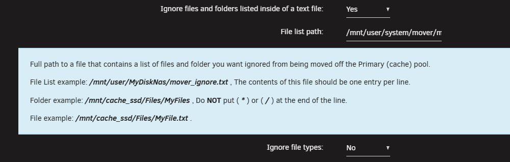

is possibile to get a setting for excluded dirs?
what are you missing ?
