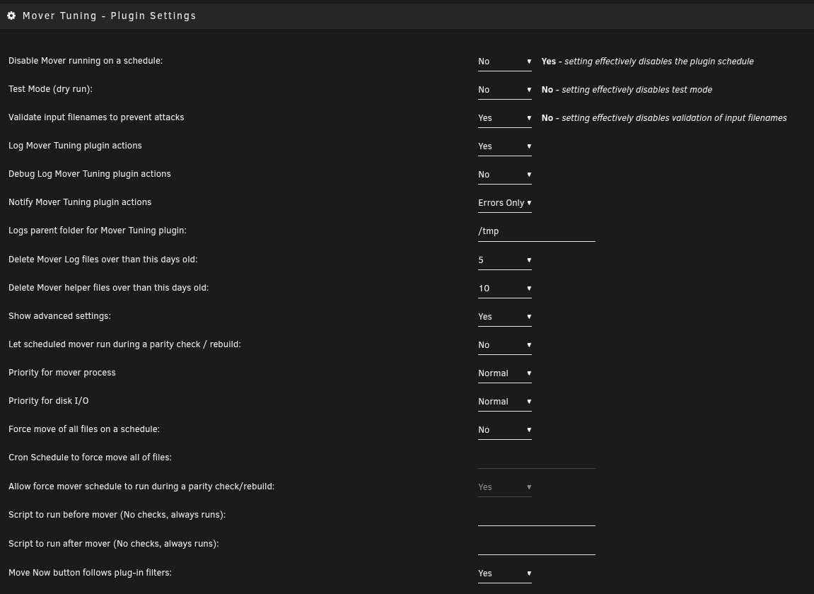

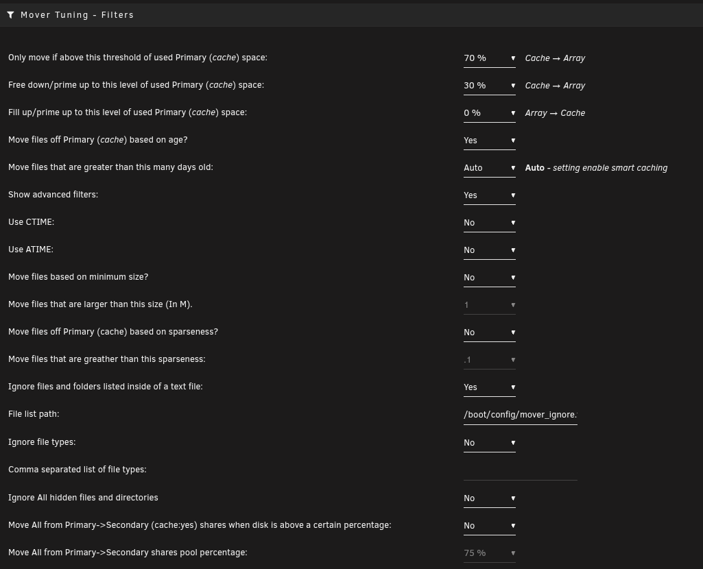

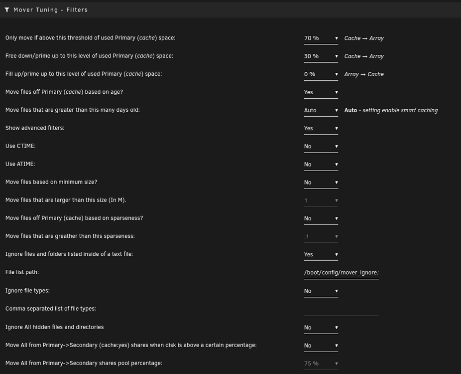

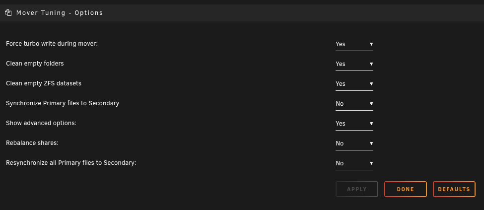

This plugin was working just fine for me, but I think after one of the more recent updates within the past few months some functionality has broken for me. I have not really changed any settings, but files do not seem to be moving off my cache pool as expected.
To start, I enabled mover logging, mover tuner logging, mover tuning debug logging, and test mode. This is the only output I see in syslog:
May 16 08:20:39 unRAID move: Mover Tuning Plugin version 2025.05.04
May 16 08:20:39 unRAID move: Usage: /usr/local/emhttp/plugins/ca.mover.tuning/age_mover start [-e <disk_name>]
May 16 08:20:39 unRAID move:        /usr/local/emhttp/plugins/ca.mover.tuning/age_mover stop|softstop|status|reset
May 16 08:20:39 unRAID move:        <disk_name> must match pattern 'disk[0-9]*'
May 16 08:20:39 unRAID move: reset  - reset config file to default values and delete override config folder
Additionally, If I look for any mover tuning logs within /tmp, I'm unable to find anything. It seems mover tuner is not properly executing, but I can't be sure.
I'm attaching screenshots of my current mover tuning settings for reference. Any thoughts on where I can start digging for a solution? Many thanks in advance!

2 hours ago, TerabyteTitan said:
range of 50 and 95%
So it should move after 95% until 50%
Please read posts above, mover cmd was fixed /created to work as it should but seems in 6.12 emhttp calling mover without start, will be fixed in next version.
You can run mover by: "mover start" in cmd it will call "age_mover start"
Can someone with unraid 6.12 , test plugin befor release?
Edited by Masterwishx
