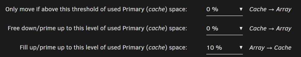

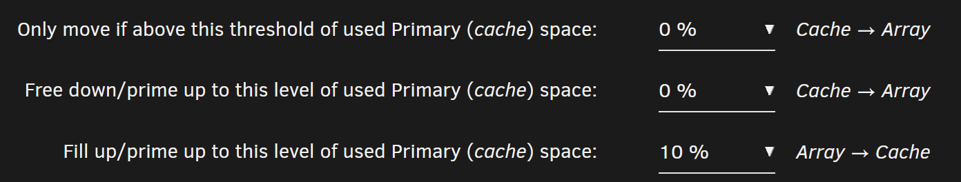

I'm sorry I don't understand what you mean by this. What overrides? Also is it the 'Fill up/prime up to this level of used Primary (cache) space' setting you are referring to? I wouldn't think that would matter as the share I am testing with is 'cache -> array'.
I tested it again changing that setting to 10% as you can see in the screenshot below, but otherwise using the same settings as above. I used 5MB files this time. I also reinstalled the plugin for good measure. The commands are included in a screenshot below, and I list the files before and after running the mover.
I also attached the logs from this most recent test.
Mover_action_2025-04-23T023816.list Mover_tuning_2025-04-23T023816.log Debug_Mover_tuning_2025-04-23T023816.log Filtered_files_2025-04-23T023816.list
No I meaned moving thresholds to 10%
Fillup it's for array to cache it's should be by default 95%.
I added `mover reset` command (default button) for next version that will reset options.
It's seems you have wrong setting for cache prefer (moving, freeing instead of free up) so check if you have override dir in config of plugin

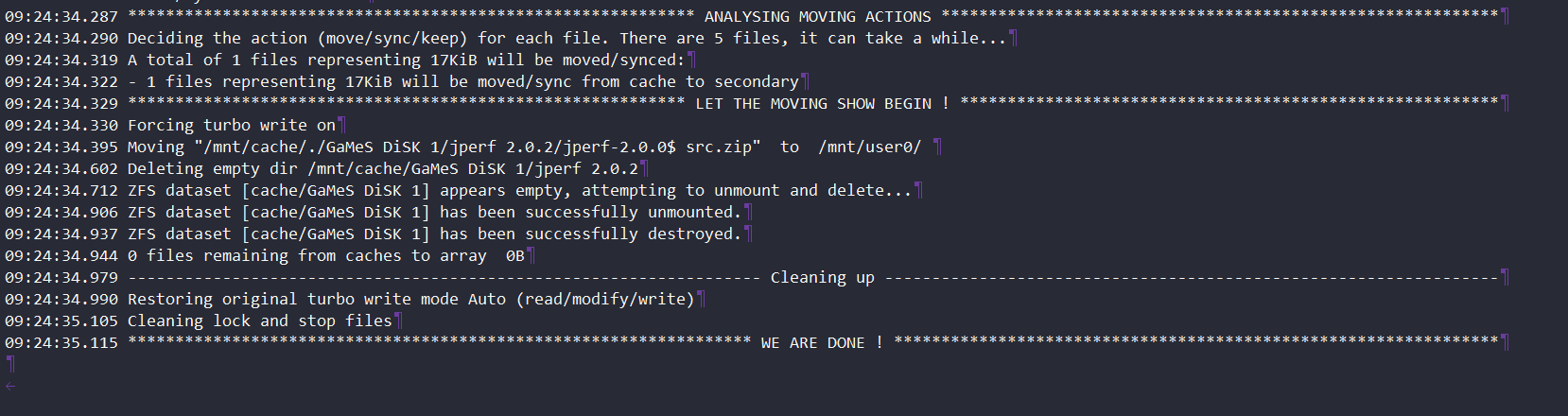

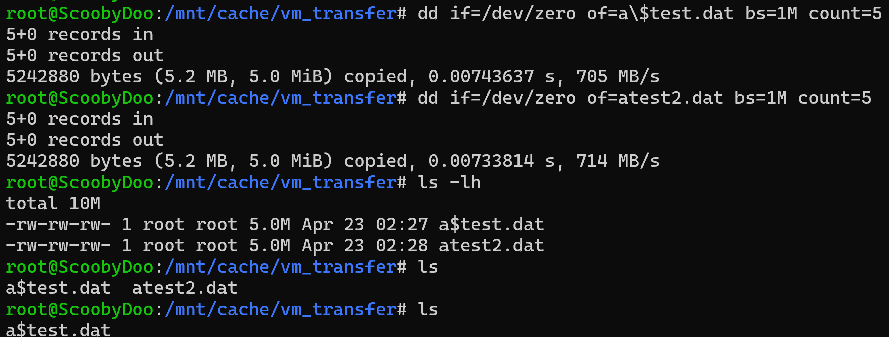

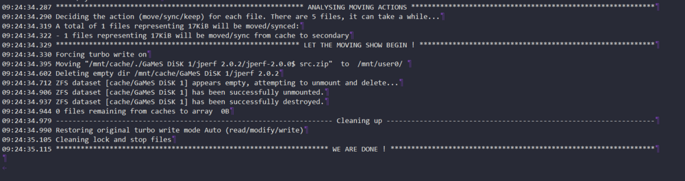

2 hours ago, fry_the_solid said:
Wouldn't the fact that all my files are moving as expected excepted those with special characters filtered by the 'validate input filenames' setting imply that the issue is with those special characters?
If you disabled files validation they should be moved, you can set both thresholds to 0%.
I can see they should be moving by mover action. And by mover log they are moving!?
I will try to reproduce it.

Sorry i cant reproduce it , all working fine if validation of files is disabled
