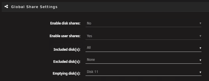

Is it possible to update the plugin to support the new "emptying disk(s)" feature in Global Share settings?
This is very useful for moving data off of disks to change the filesystem without having to use something like unbalance which is extremely slow for me.
you can run it from cli
You can also configure that in UI now. Its listed in the documentation for how to migrate fileystems. I have to do that for XFS v4 to v5 for a few disks. I basically have to disable Mover Tuning for this type of move since it doesn't seem to support that feature.
Edited by johnsanc
you can run : mover start -e diskX or to run unraid mover : mover.old start -e diskX
Edited by Masterwishx
if you mean in Global Share Settings then you need to stop array ?!
Yes its a very weird design choice to put it there... but that feature is available in UI shoved under Global Share settings as shown in my previous screenshot
Oh you mean to add like in Unraid mover when run to empty disk if was set in option.
I saw they added code for it, now I got it.
I will check if I can add it, but you can still run in cli, or make force mover schedule that will run unraid mover
Yes for now i set "Move Now button follows plugin filters" to "no" to get the empty disk function to work.
