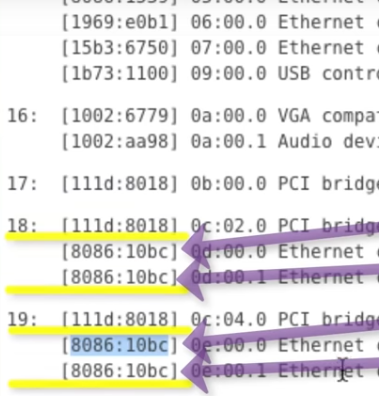

Hi, I love the guide, however, I am having an issue with starting the VM. I am on step 3.
This pops up
internal error: process exited while connecting to monitor: 2019-01-24T03:29:45.614726Z qemu-system-x86_64: -device vfio-pci,host=07:00.0,id=hostdev0,bus=pci.3,addr=0x0: vfio error: 0000:07:00.0: failed to setup container for group 15: failed to set iommu for container: Operation not permitted
Thanks
It looks like the nic that you are passing through isnt in its own iommu. You will need to break it up or passthrough everything in that group. have a look at my vid here https://www.youtube.com/watch?v=qQiMMeVNw-o&t=791s

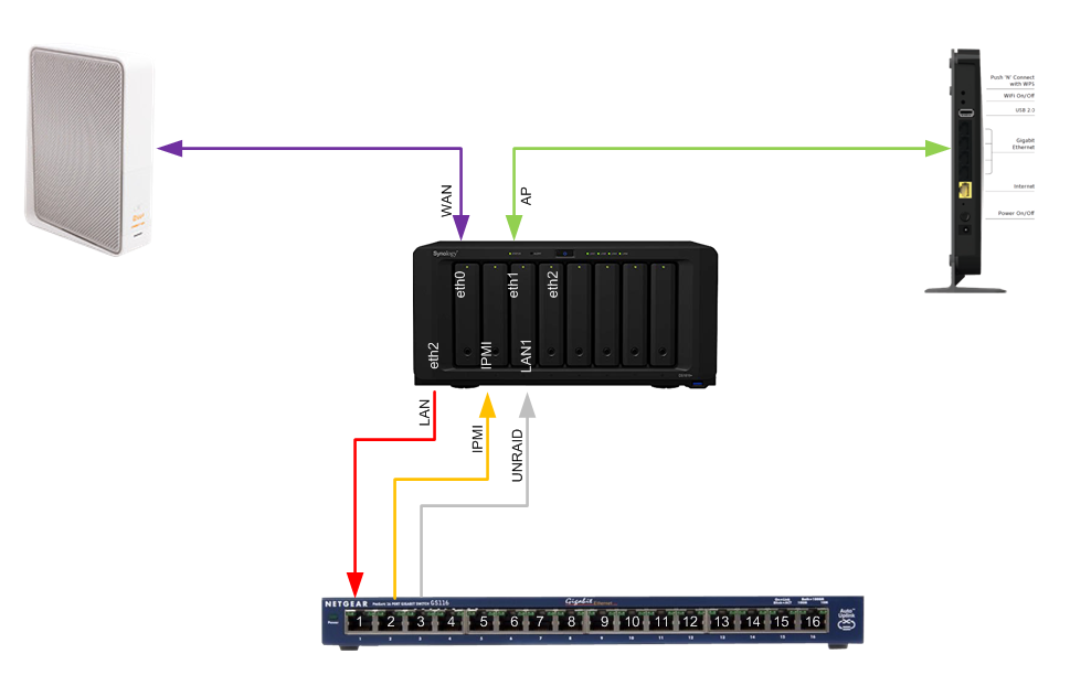

My network architecture at the moment is basically as follows:
----[MODEM]----[Netgear router + wifi]-----[16 port switch]----[ {UNRAID}, {MAC}, {PC} {etc}]
(The ISP modem is in bridge mode)
So what if i remove the Netgear router and setup pfsense on a VM in the UNRAID server?
----[MODEM]----[UNRAID/PFSENSE]-----[16 port switch]----[ {MAC}, {PC} {etc}]
(the old netgear wifi router will be added as an access point)
But... how do i keep IPMI working this way?
If the UNRAID server is turned off (over IPMI!)... where does it get an IP address?

I have set up the above topology. Unraid is running pfsense, and my DD-WRT router is now configured as an access point. So far so good. All devices can connect, eiter using the LAN (192.168.1.x) or WIFI (192.168.2.x) subnets. I can also access the unraid GUI on subnet 192.168.1.x on my (wifi) ipad which is in subnet 192.168.2.x. Also good. Me happy.
But... if i turn on my vpn on my ipad (goose vpn, in app form on the local device like pia/nordvpn etc) i can surf the internet etc but i can not acces the 192.168.1.x subdomain anymore? So i can not enter unraid's webgui etc. If i turn off the (local) vpn, all is ok... btw, if i use the vpn on my wired mac mini, there is no problem entering the unraid gui. Both mac-mini as unraid are on the same subnet.
How do i change this?
Or is this a DD-WRT setting i'm missing?
*edit1*
i also can not acces my receiver and apple tv (both are in 192.168.1.x) from apps on the ipad (192.168.2.x)... this must be related?
How do i make both subnets 'see' each other for all devices (not just some?)
*edit2*
Fixed the subnet-could-not-see-eachother issue by defining a bridge between them. Don't know if that is the best solution but it works. Also tried rules that would allow traffic from subnet a to b and vice versa but did not work.
The (local) vpn issue remains.
Edited by jowi

I followed this guide to install pfsense as vm on unraid and the required steps to passthrough the NIC (Intel Pro/1000 dual port), but when I try to boot the pfsense VM I get this error:
"internal error: process exited while connecting to monitor: 2019-04-20T15:41:25.512263Z qemu-system-x86_64: -device vfio-pci,host=10:00.0,id=hostdev0,bus=pci.3,addr=0x0: vfio error: 0000:10:00.0: failed to setup container for group 17: failed to set iommu for container: Operation not permitted"
I also tried the 'enable pcie acs override" option which did not seem to help.
Group 17, 18 is my card in 'system devices':
"IOMMU group 16:[8086:10d3] 0b:00.0 Ethernet controller: Intel Corporation 82574L Gigabit Network Connection
IOMMU group 17:[8086:105e] 10:00.0 Ethernet controller: Intel Corporation 82571EB/82571GB Gigabit Ethernet Controller D0/D1 (copper applications) (rev 06)
IOMMU group 18:[8086:105e] 10:00.1 Ethernet controller: Intel Corporation 82571EB/82571GB Gigabit Ethernet Controller D0/D1 (copper applications) (rev 06)
IOMMU group 19:[8086:10d3] 15:00.0 Ethernet controller: Intel Corporation 82574L Gigabit Network Connection"
Can someone help me get this working?
UPDATE: this fixed my issue:
https://forums.unraid.net/topic/37959-guide-passing-through-network-controllers-to-unraid-6-virtual-machines/?do=findComment&comment=592661
Edited by guruleenyc

I've been told that my config, with the netgear dd-wrt ap connected to a separate NIC (OPT1, WIFI see above pic), makes no sense, if i use a bridge to connect LAN and WIFI...  It would be better to just add the access point to the switch and make it a part of the LAN network. Does that makes sense?
Edited by jowi
Hey jowi.
So from your diagram, it looks to me like the goal was to keep WIFI and LAN clients separate.  If that is not the case, the simplest solution to get the WIFI and LAN clients to talk to each other is probably to move the AP to the switch.  This has the added benefit of only needing NAT and firewall rules to route clients thru the VPN on 1 interface (LAN) rather than 2 (LAN + WIFI).
You could keep the AP on a separate interface and use firewall rules to pass traffic between the subnets, but that seems way harder than just moving the AP to the switch.
My way of thinking about it: the biggest reason to have different clients on different subnets in a small setup is for them to NOT communicate.  For example, I have different HOME, GUEST, etc. subnets (via VLANs, not different hardware interfaces, but functionally about the same).  Clients connected to the GUEST wifi cannot see my server on the HOME subnet.  And I like it that way :)
Hope that helps.
P.S. based on your earlier posts, I'm not sure how the iPad on the WIFI subnet ever saw the server on the LAN subnet ...
