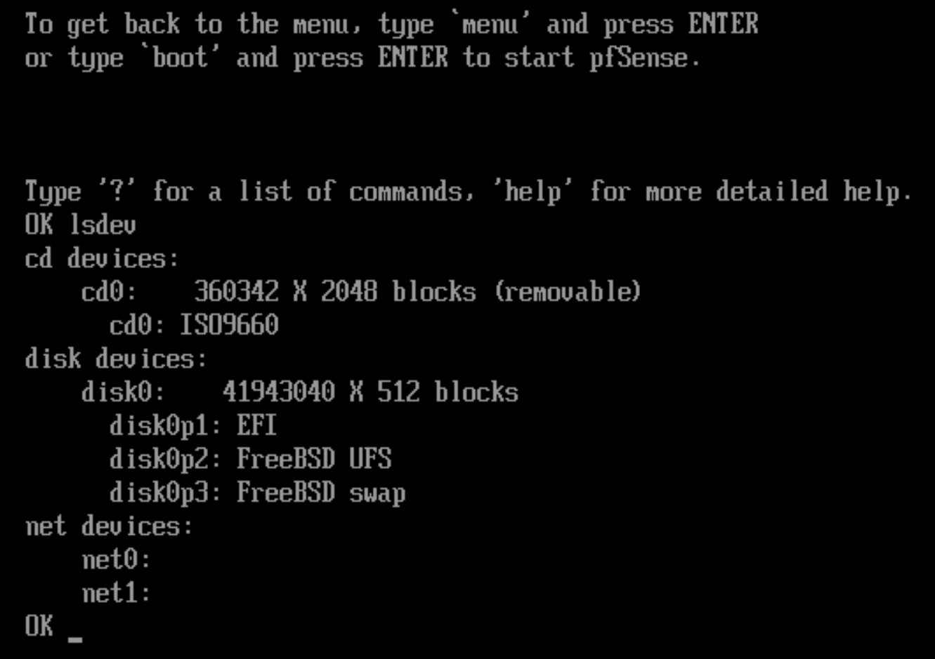

UPDATE @ 3:20pm Mountain: I've finally managed to at least get the Intel dual port 1Gbps NIC passed through to the pfSense VM and for the 1st time I was able to reach the pfSense menu and configure the interfaces. It's not seeing my HP NC523SFP dual port 10Gbps NIC but that's probably a driver/module issue that I can update in the pfSense VM. I've read that others have used the HP (QLogic) 10Gbps adapters so I'm sure I'll eventually figure it out
UPDATE #2: did some testing and found that pfSense fails to detect the NICs with QEMU 4.x. QEMU 3.1 is the version that I'm currently using and so far pfSense seems stable.
As for the current solution that enabled the Intel NIC: it was as simple as changing the machine type from Q35-4.2 to Q35-2.11 - saw this in one of the many threads that discuss passthrough. It was the only change made to get it to recognize at least the Intel NIC.

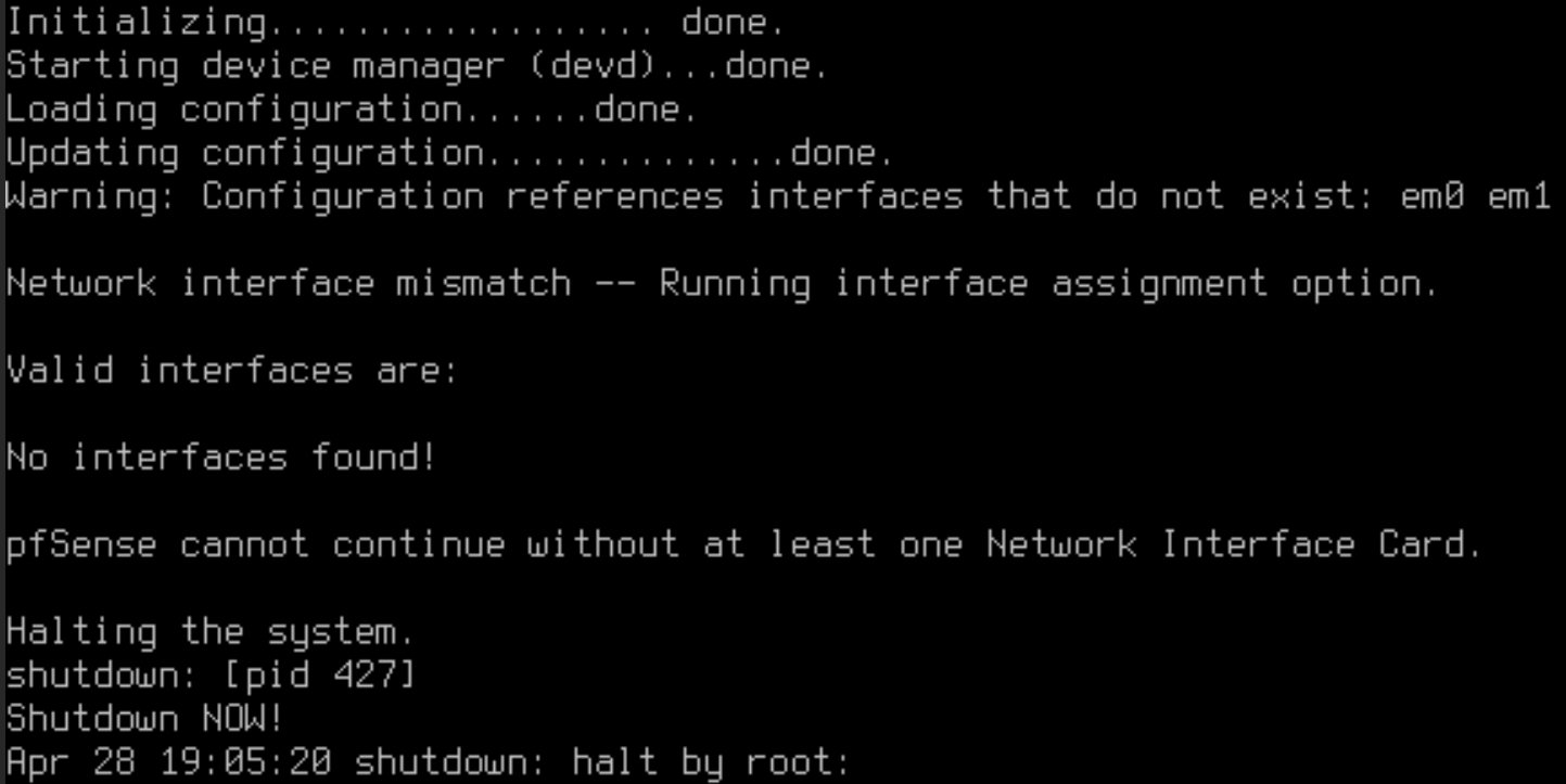

I'm having some issues with getting my NICs passed through to the pfSense VM. I've tried both the vfio-pci.cfg/BIND and the vfio-pci.ids=xxxx.yyyy methods. I have two dual port NICs, one an Intel 82571 dual port 1Gbps and the other a HP NC523SFP dual port 10Gbps. Both methods do seem to bind the cards to vfio as unRAID no longer sees them under Network Settings.
The initial creation of the VM as per part 3 of the videos works as expected. When the VM reboots at the end of the install, pfSense loads from the vdisk but fails before getting to the pfSense menu options. The error message reported states that 'Configuration references interfaces that do not exist (em0, em1).
I never get to the ‘interface assignment’ stage…. I’ve also tried with PCIe ACS override and VFIO allow unsafe interrupts options in VM Settings. When I reboot the VM and hit escape at the loader menu I can issue an 'lsdev' command and it shows the following:
Are then net0: and net1: devices 2 of my 4 NIC ports? Where are the other two? I tried with just the Intel dual port card and saw the same result. I then tried with just the HP NC523SFP card by itself, also yielding the same results.
As another note, when I try to review the logs of the VM boot, it’s very short and only has the last couple of screens of info prior to the halt. How do I increase the log size for my VM so I can capture all of the messages from start of the boot through to the halt. At least then I can possibly find a cause for my issue.

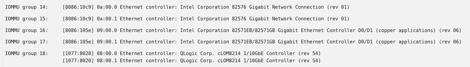

Here's the IOMMU list for my NICs:
The onboard dual 1Gbps NICs have a different PCI ID and they are still visible to unRAID and working in a failover bonded pair. Any suggestions on what I need to do to overcome the halt issue for the pfSense VM? TIA!

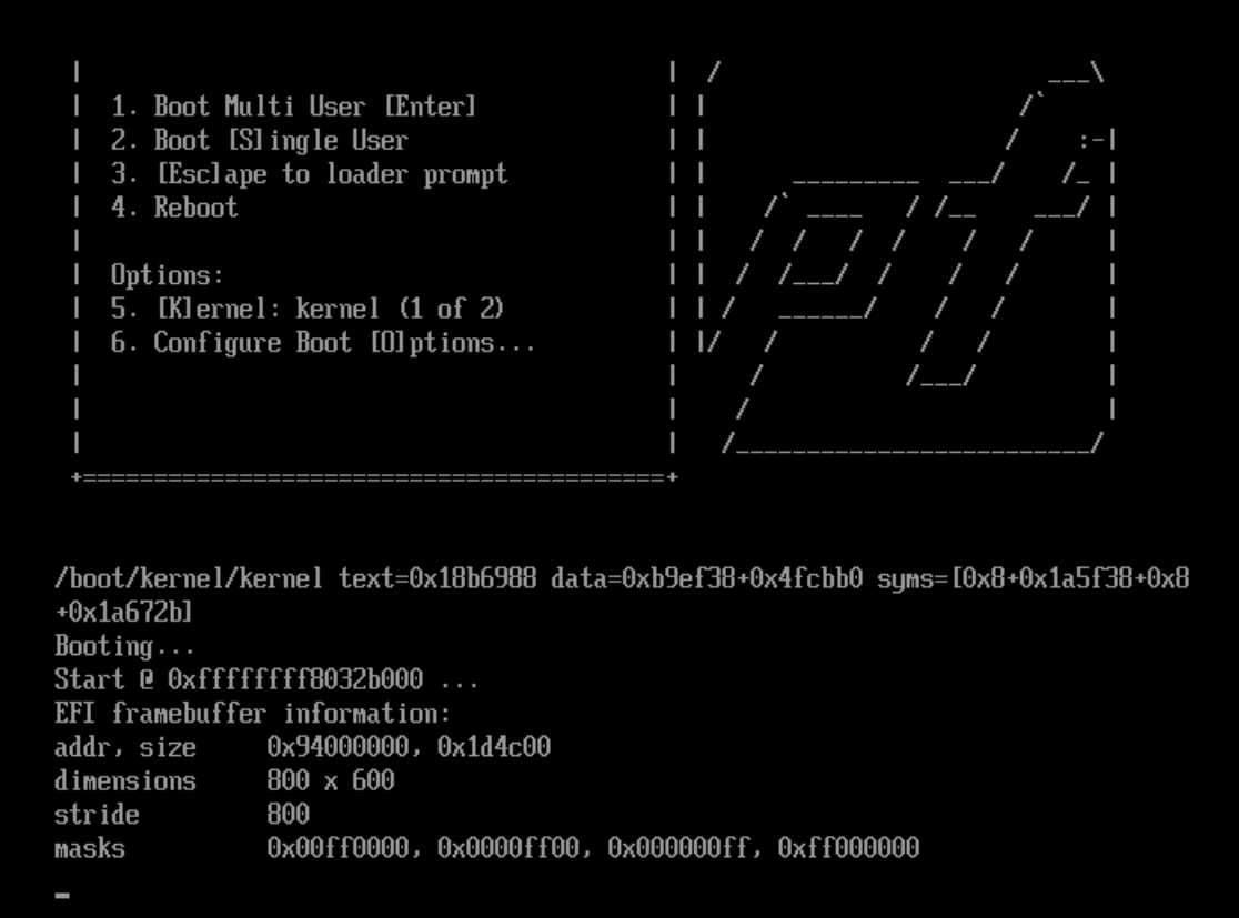

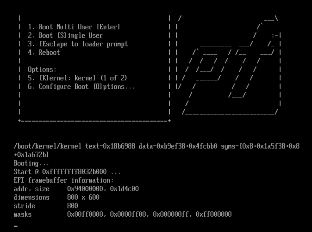

Hello.  When I launch PFSense for the first time I get stuck on the black screen where it says booting... and nothing else happens.
I have attached my logs from my PFsense Vm.  I see the following errors
2020-05-24 02:05:07.735+0000: Domain id=1 is tainted: high-privileges
2020-05-24 02:05:07.735+0000: Domain id=1 is tainted: host-cpu
char device redirected to /dev/pts/0 (label charserial0)
2020-05-24T02:05:18.252838Z qemu-system-x86_64: vfio-pci: Cannot read device rom at 0000:08:00.0
Device option ROM contents are probably invalid (check dmesg).
Skip option ROM probe with rombar=0, or load from file with romfile=
2020-05-24T02:05:18.254745Z qemu-system-x86_64: vfio-pci: Cannot read device rom at 0000:09:00.0
2020-05-24T02:05:18.256320Z qemu-system-x86_64: vfio-pci: Cannot read device rom at 0000:08:00.1
2020-05-24T02:05:18.257872Z qemu-system-x86_64: vfio-pci: Cannot read device rom at 0000:09:00.1
I did some searches and someone mentioned it has to do with the CPU pinning but I pinned 2 threads on 1 core.  I even tried switching the pinning to a different core.  I had 1 and 7 pinned but now I have 5 and 11.

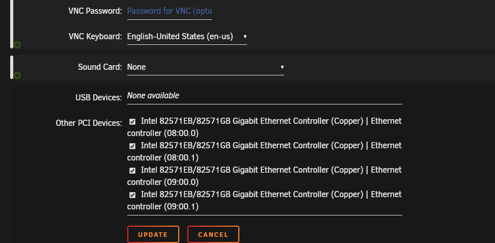

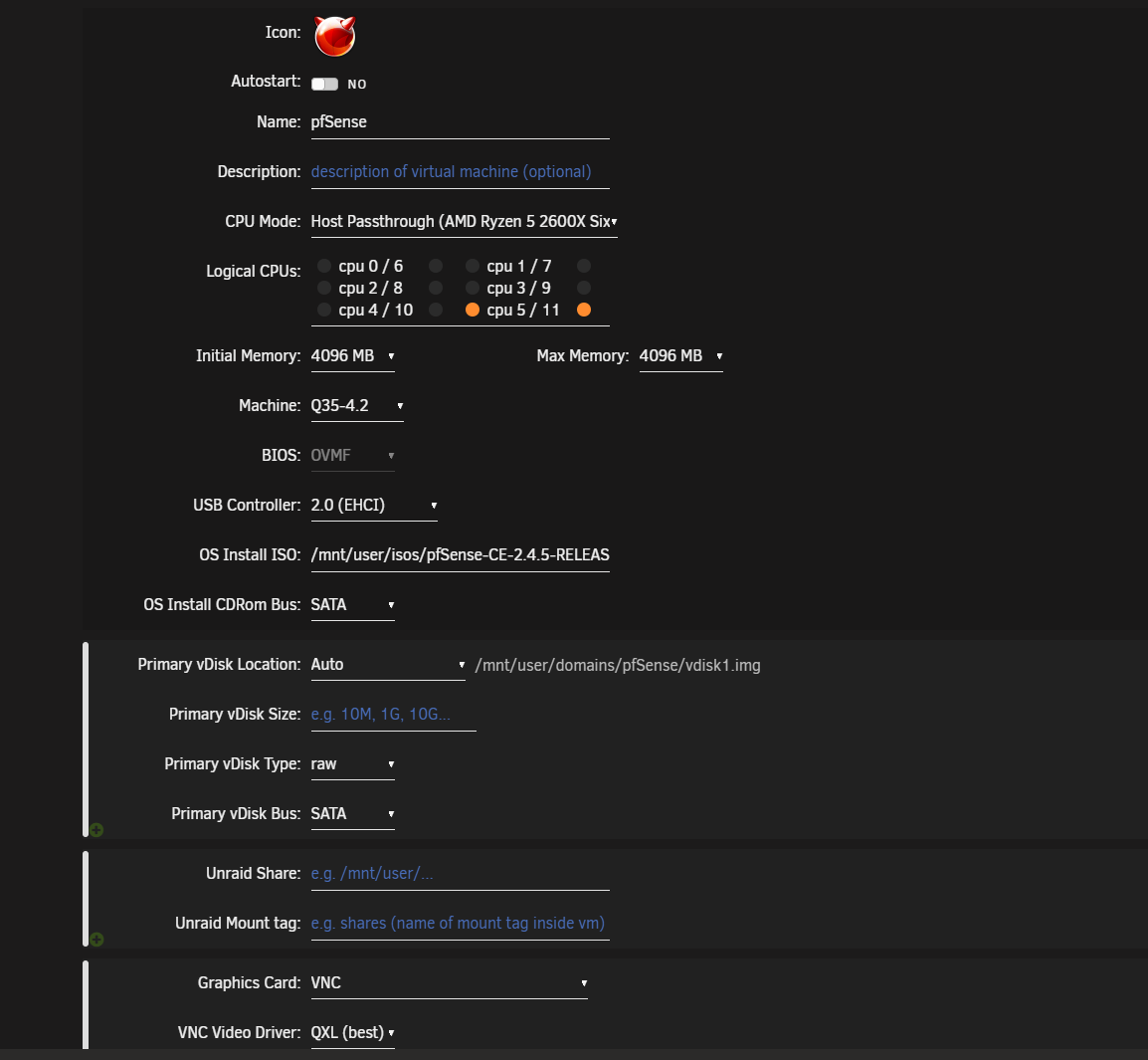

So Im a little lost here.  I used the vfio plugin to get passthrough working.  I also had to enable ACS override to get the IOMMU groups broken up.
Here is my pfsense VM config
Part 1
Part 2
I have attached my pfsense logs and my IOMMU group in txt files.
Any help would be appreciated.
PFsense logs.txt IOMMU Groups.txt
Hello All,
I'm having the same issue as @Armed Ferret my current version of unraid is 6.8.3, is this a known issue or is it unsupported? I am a noob at unraid and wanted to see about getting pfsense vitalized as one of my projects after my plex server.
Thanks

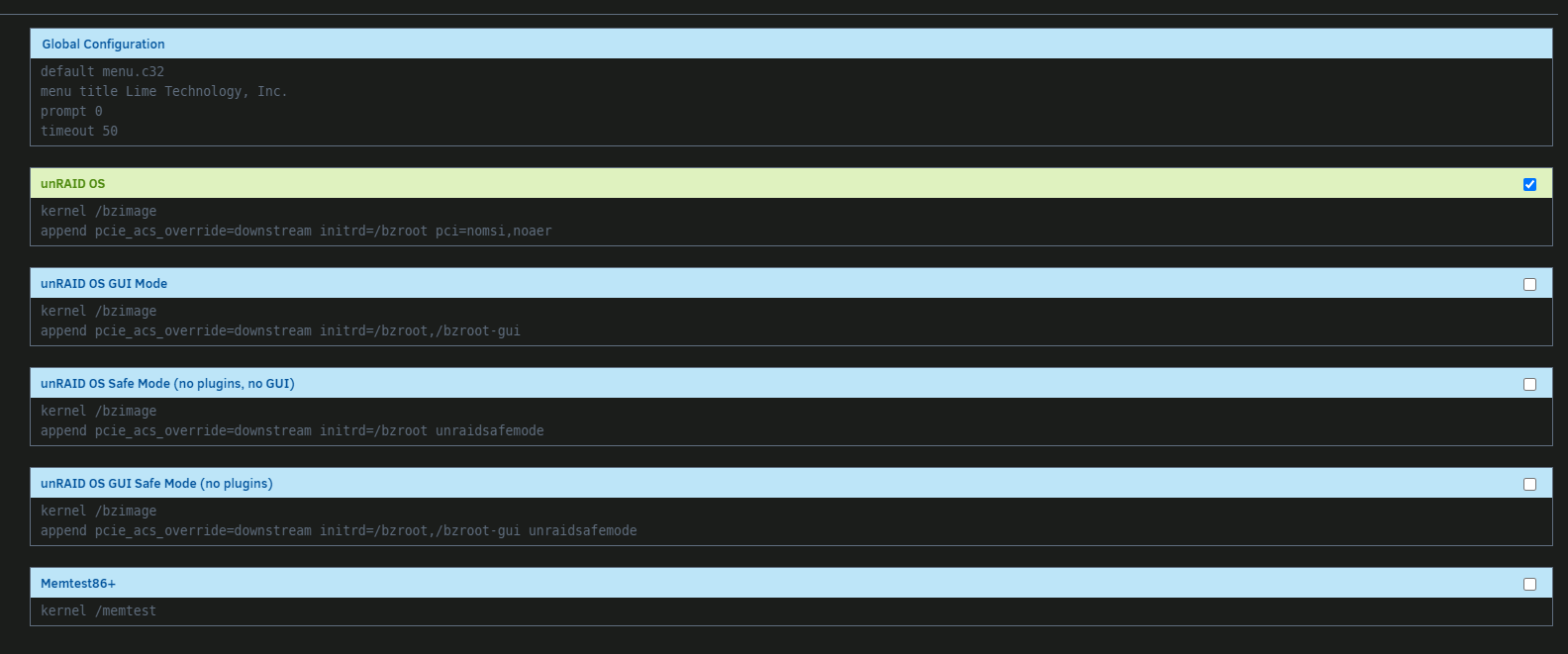

Hey guys, I could really use some help.. I'm not sure what is going on.
I'm trying to get my gbe nic passed through to my VM, but I don't think my syslinux config is working properly
This was my original Config
kernel /bzimage
append pcie_acs_override=downstream initrd=/bzroot pci=nomsi,noaer
This is my edited config
First I tried
kernel /bzimage
append vfio-pci.ids=8086:1079 pcie_acs_override=downstream initrd=/bzroot pci=nomsi,noaer
This seemed to have 0 effect, the devices were still in the network settings.
Then I tried below, as I saw it in a post
kernel /bzimage
append pci-stub.ids=8086:1079 pcie_acs_override=downstream initrd=/bzroot pci=nomsi,noaer
I can no longer see the controllers in my network settings, but I also cannot see them available to passthrough to the VM
Any idea's?
Edit: I have just been editing the Unraid OS syslinux config, I assume this is fine as this is how I boot it
Edited by Addy

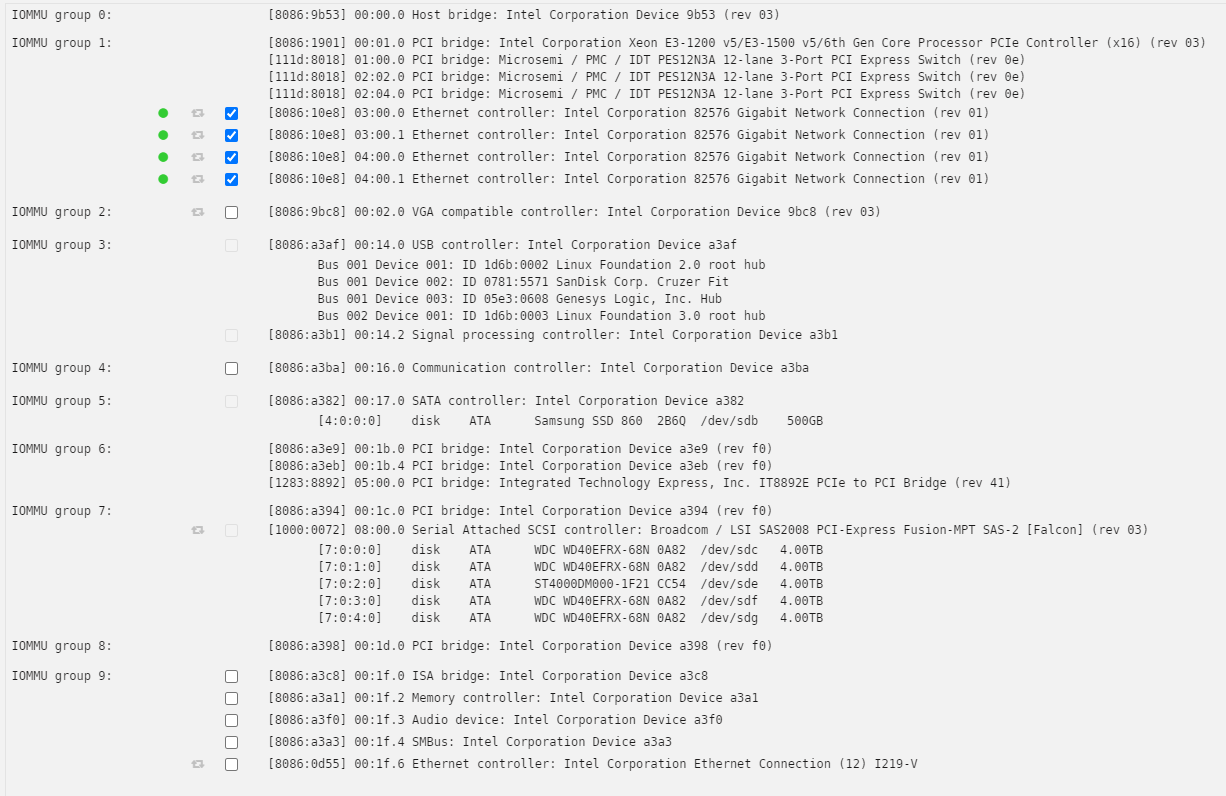

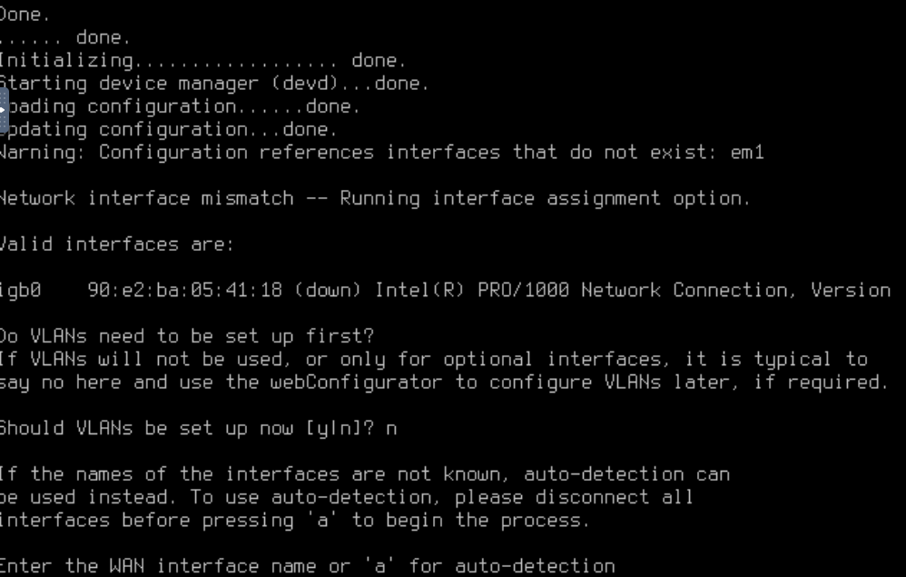

Have followed along and when its time to assign interface ports, pfsense doesnt see that 4port NIC
This is my IOMMU groups
I am assuming the ticked items in Group 1 is the 4 port intel NIC, but not sure if the remaining item in thatgroup are ascociated?
Do they need to be split?
I have tried the overide option on or off, this is what pfsense displays
igb0 is the onboard nic?
EDIT: In the VM creation it automatically sets the machine type as Q35-5.0
Once i changed it to Q35-2.11 everything worked as per the video
And i did not have to set any pcie overrides. My intel nic in group 1 passed through no problems. pfSense now installed!!
