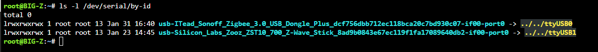

the best method to passthrough usb to docker is via device by-id
open unraid terminal
type
ls -l /dev/serial/by-id
you will get output of your devices with names
copy the whole BLUE name of your device
go to your docker and edit config
add /dev/serial/by-id/  before pasting the name from above.
eg
/dev/serial/by-id/usb-ITead_Sonoff_Zigbee_3.0_USB_Dongle_Plus_dcf756dbb712ec118bca20c7bd930c07-if00-port0
then add :/dev/zigbee to the end -  this is the container mount point
so you end up with this in your Docker Host config:
/dev/serial/by-id/usb-ITead_Sonoff_Zigbee_3.0_USB_Dongle_Plus_dcf756dbb712ec118bca20c7bd930c07-if00-port0:/dev/zigbee
if anywere inside your docker program it asks for the device location you would set it to :
/dev/zigbee
Edited by TRusselo

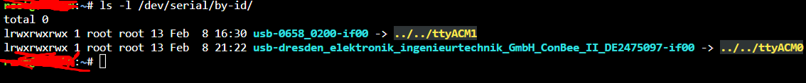

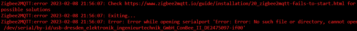

Tried this with my conbee2 stick and no luck.
this in zigbee2mqtt configuration.yaml
and i get this in zigbee2mqtt log
so frustrating having to reconfig every time i reboot server

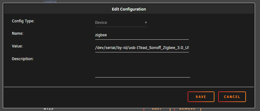

 i have an idea
docker config (your first screenshot)
add :/dev/deconz   to the end (this sets the mountpoint inside the docker {outside:inside}/ or {host:docker} )
so "/dev/serial/by-id/usb-dresden....97-if00:/dev/deconz"
in configuration.yaml change port to
serial:
  port: /dev/deconz
Edited by TRusselo

thnx m8, this worked!! the first u suggested with "null" did not work fyi
did the same with my zwavejs2mqtt docker and that seems to work also!
