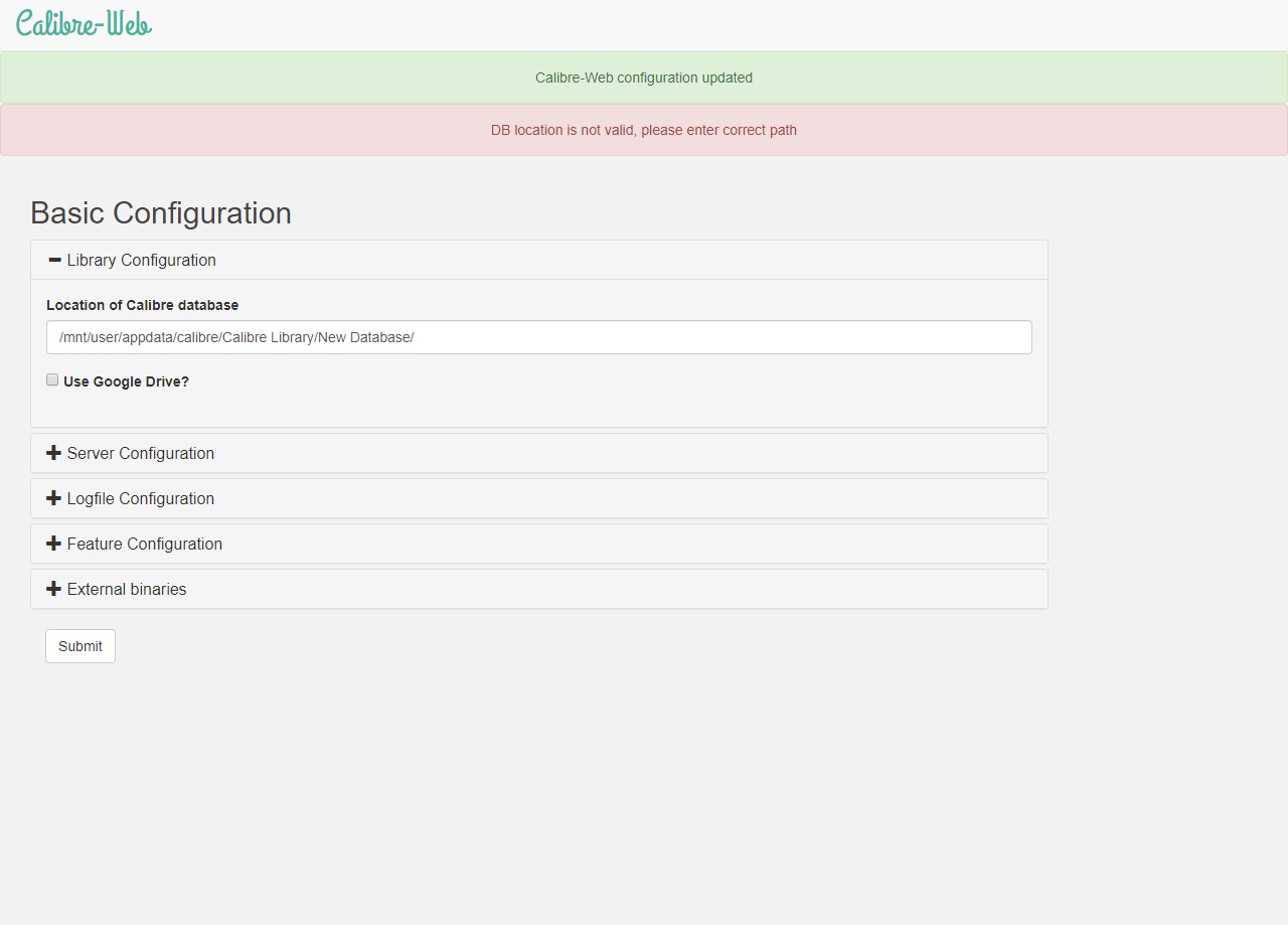

I am trying to set this up and I keep getting the error "DB location is not valid, please enter correct path" when trying to enter the path to my calibre books and database.  I can see the books and the db in the directory and I have set it the same way in the container configuration.  But it still won't work.  Any suggestions?
Edited by pcgirl
You are using the host path instead of the container path. Inside the container it's /books.
Ah, that works, thanks!

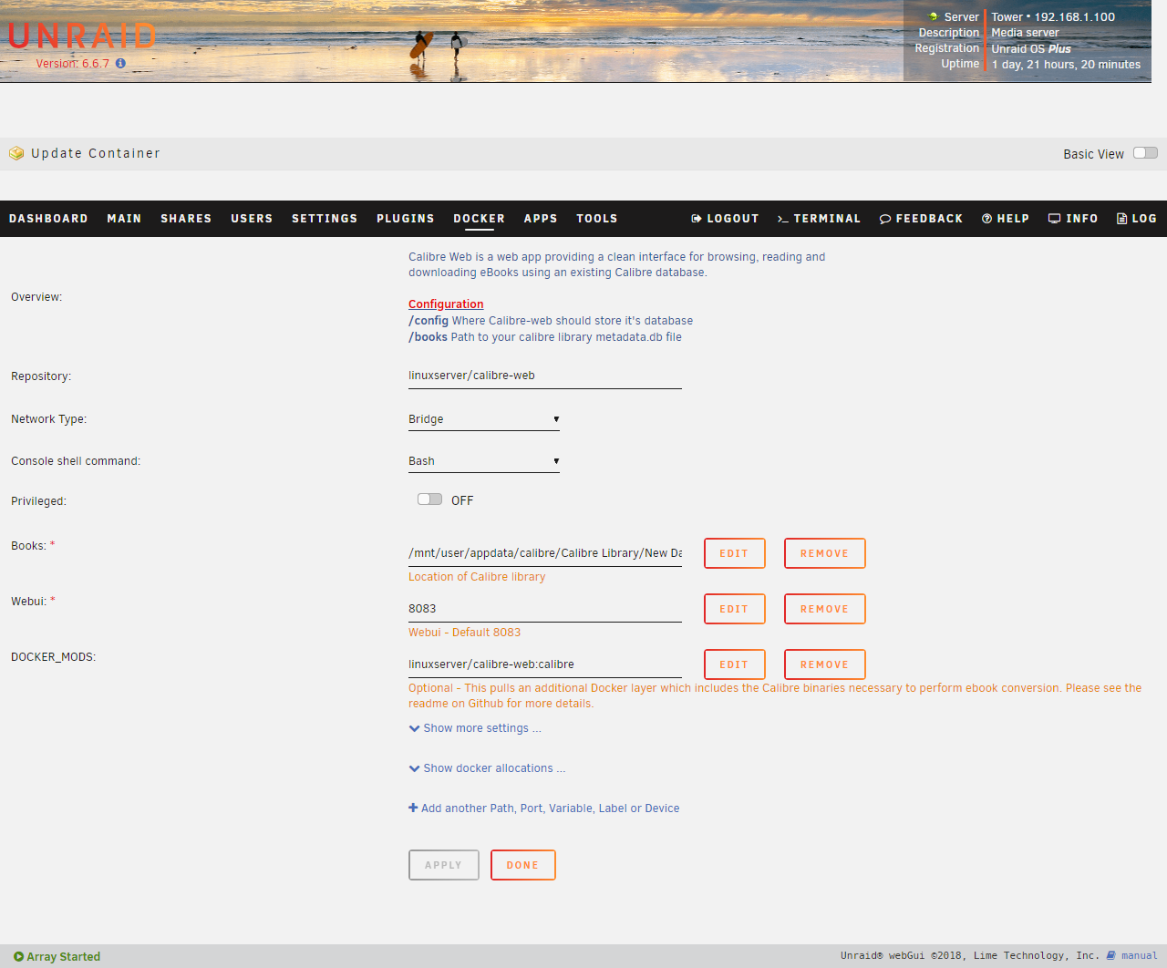

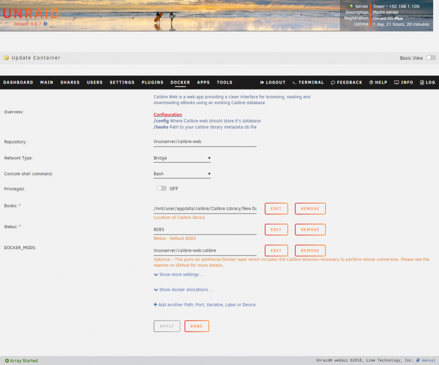

I'm trying to set up this Calibre-Web docker and am using the ls.io version of the Calibre docker. I can reach the Calibre web-UI easily on my ip:8080, however I cannot reach the Calibre-Web web-UI on ip:8083. What could have gone wrong?
i am having the same problem ... has anyone solved it?
You need to post container log and docker run command. Our crystal ball is broken.
