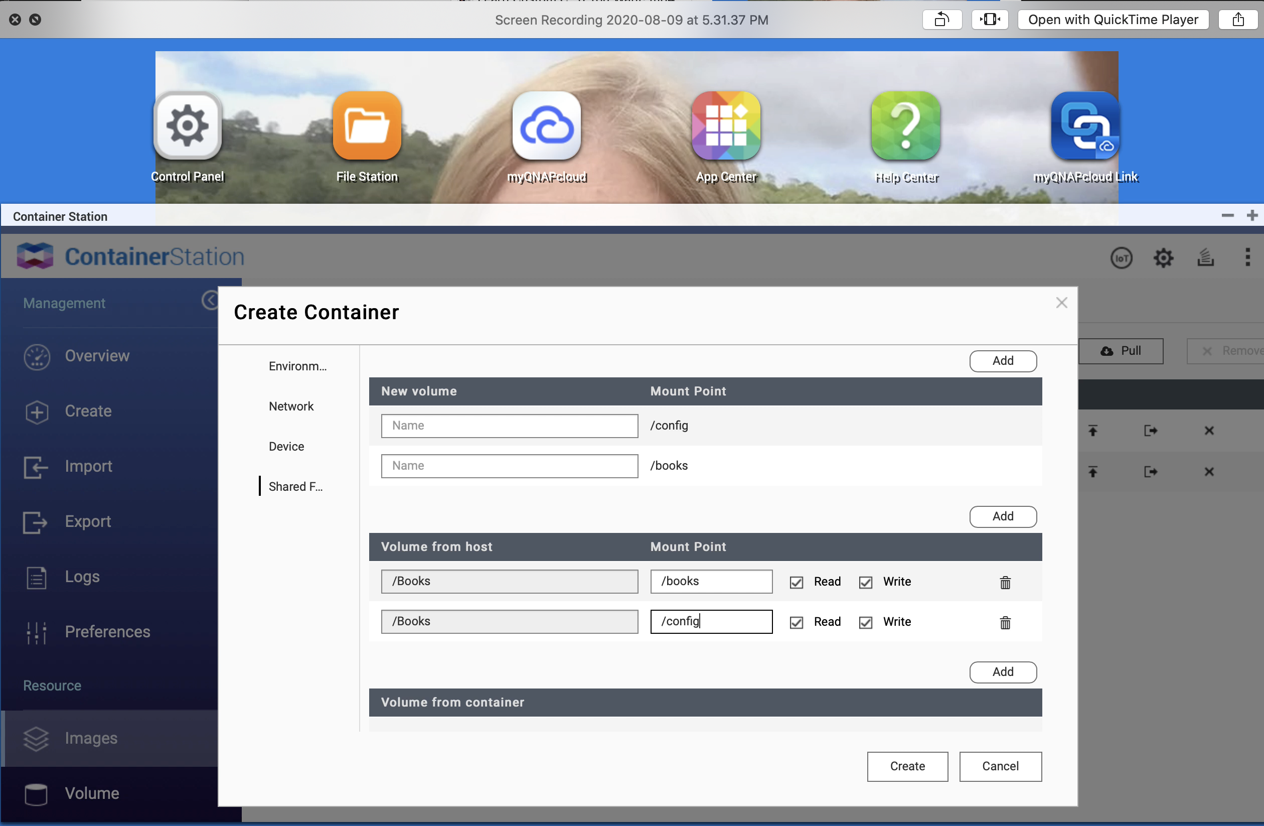

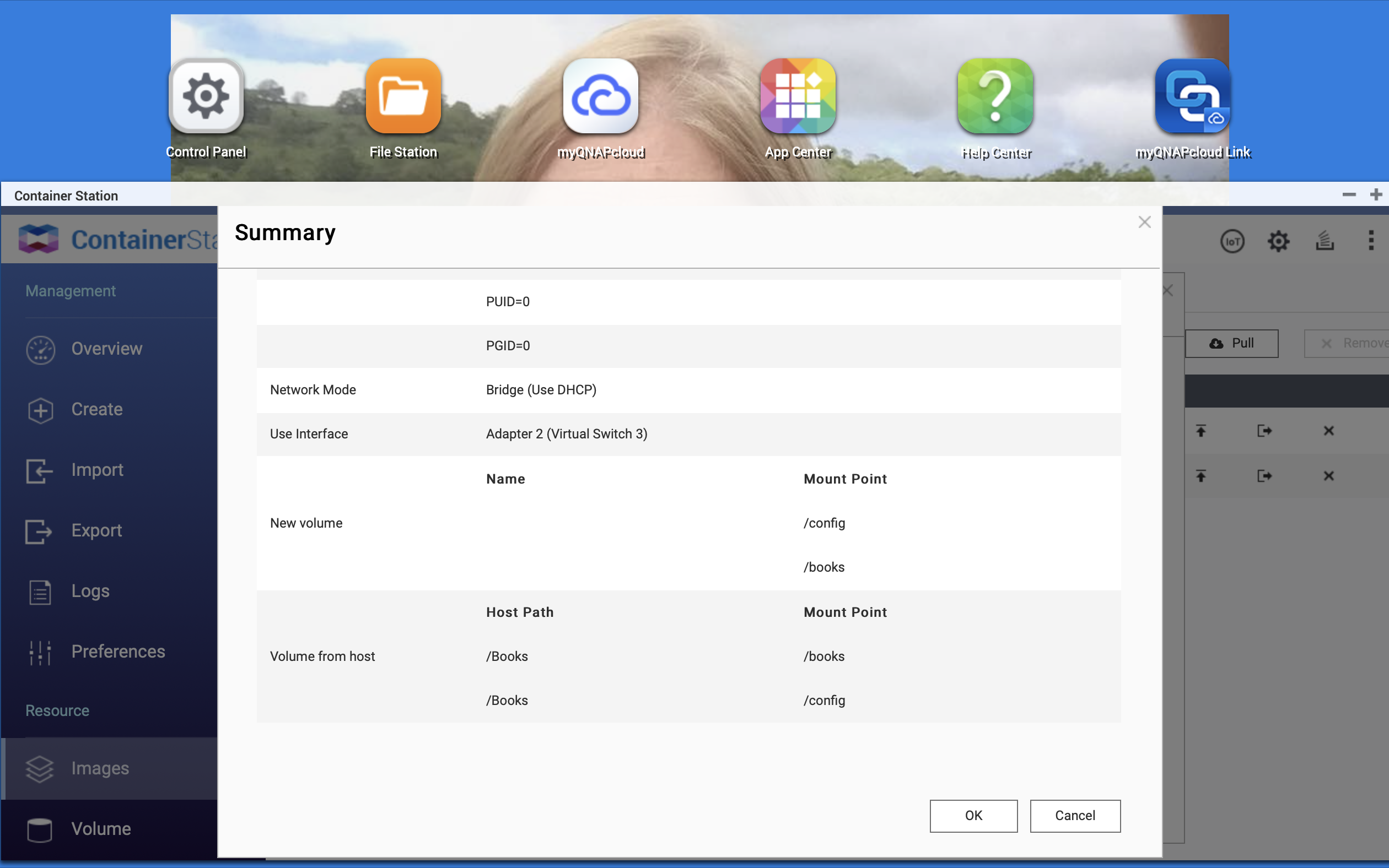

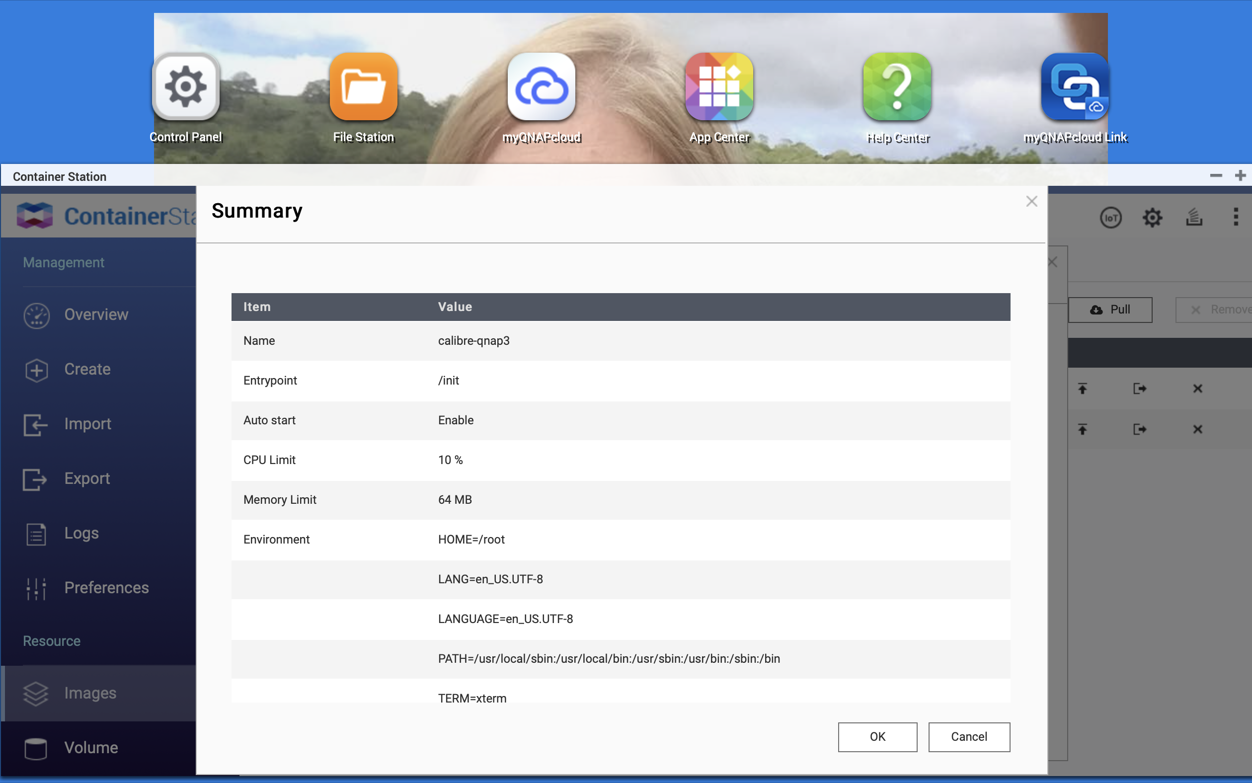

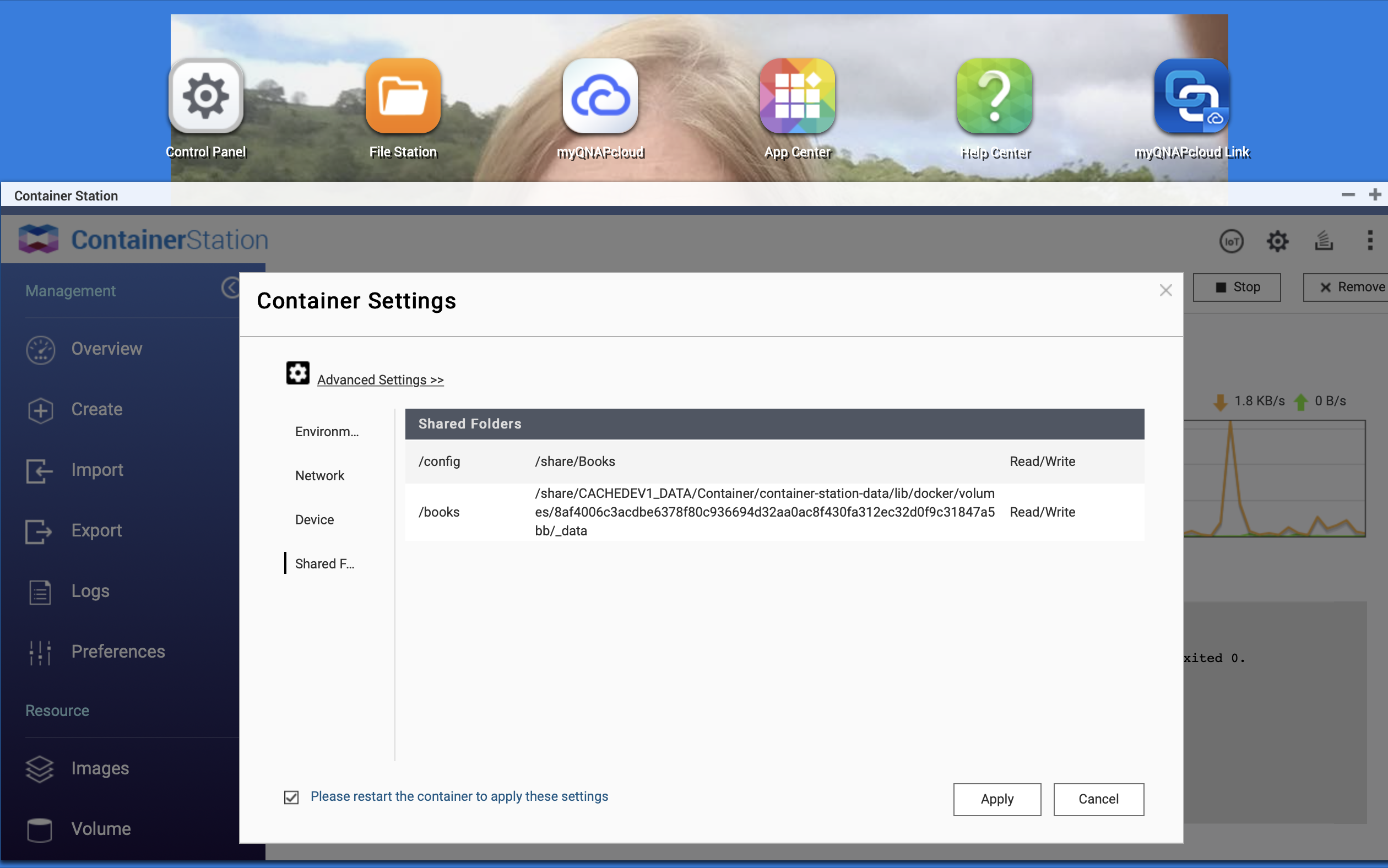

I'm a noob on both Qnap containers and on docker.
I'm trying to setup the server and have a shared folder Books in which are all my ebooks and the metadata.db file.
Each time I create the container one of the locations for either /config or /books (that as far as I can see are correct - see screenshots attached) maps correctly to the shared folder, but the other one maps to a newly created folder in the Container>Docker folder.
Is it NOT possible to map both to the same shared folder (though this is how my install of Caliber works)?
I'd appreciate any insights.  Create Container settings are in screen shots below.

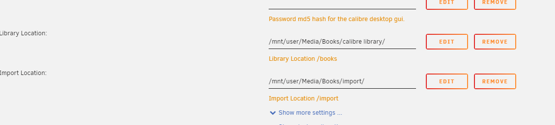

I've got a problem setting up my library. I want to use my import directory, but it just maps to the LIbrary location when I go to import.  If I try to go up a directory, it takes me back to / and I can't get to ../import.   Any idea on what I'm doing wrong?
Post the docker run command. Screenshots doesn't tell us everything.

I dont understand what you are doing with your bind mounts. You have the books folder mounted to books in the container and then you have multiple mounts of subfolders to various folders in the container. Two with the same host path.
I'm not sure where you can't go to the /import folder. In Calibre-web?
