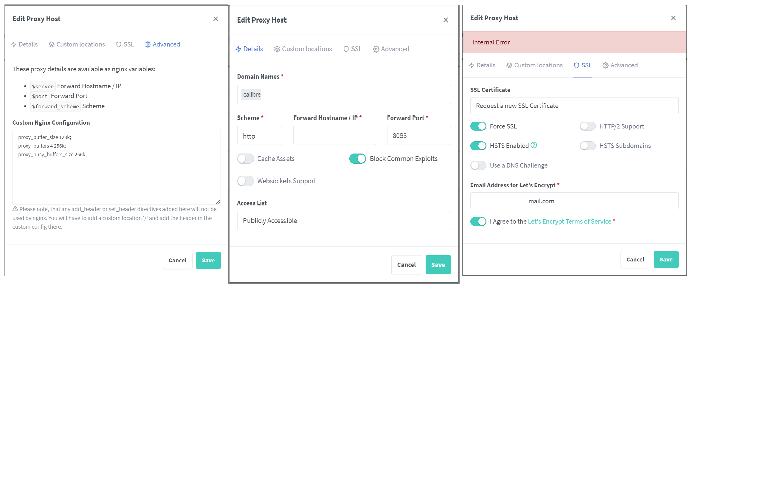

I've got the calibre-web container running beautifully when I access it locally... But when I access it thru my reverse proxy (Nginx Proxy Manager) it keeps kicking me to the login page when i try to change views or look at a book's details.
I have included the following options on the NPM advanced tab as suggested:
proxy_buffer_size 128k; proxy_buffers 4 256k; proxy_busy_buffers_size 256k;
I do not have "Allow Reverse Proxy Authentication" selected in the feature configuration page.
Ideas?
EDIT - might have fixed this myself by unchecking the NPM options for 'cache assets', 'block common exploits' and 'websockets support'. Will see how it continues to behave.
nope. still kicking me to the login screen for calibre-web

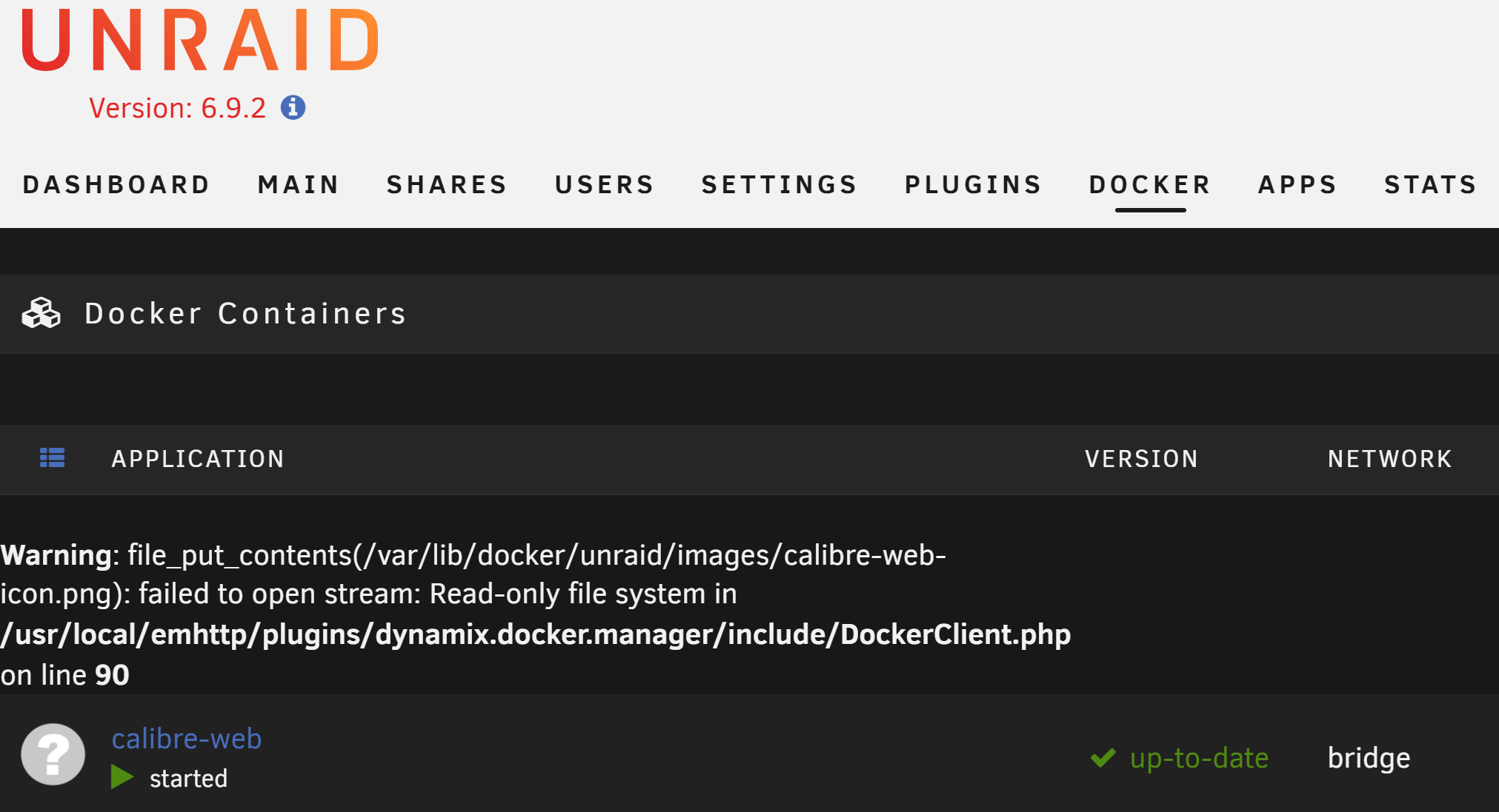

I had a Calibre-Web update available today, so I updated it. After updating my Docker page now gives me this warning:
Warning: file_put_contents(/var/lib/docker/unraid/images/calibre-web-icon.png): failed to open stream: Read-only file system in /usr/local/emhttp/plugins/dynamix.docker.manager/include/DockerClient.php on line 90
Any ideas on what I'm supposed to be doing to resolve this? It *appears* that Calibre-Web did successfully update since it says "up-to-date" whenever I check for updates. But Calibre-Web no longer works. I get an page cannot be displayed error when trying to access the WebUI. Below is a screenshot of the Docker page.
EDIT: I tried restarting the server, and that causes it to say:
Execution Error
Error code 403
Edited by IFireflyl

On 7/14/2021 at 11:38 PM, IFireflyl said:
Well, I tried to reboot my server to see if that would fix it. Now the Calibre-Web docker is completely missing and I have to re-install it. *le sigh*
That has nothing to do with the container. It's an unraid issue.
Without diagnostics, odds on you have to delete the docker.img and reinstall everything via Apps - Previous Apps.  It should be like nothing happened.
Yep, that's what I ended up doing. I have no idea what caused it, or how to find out. But it appears to be working fine after a re-install. Thanks!

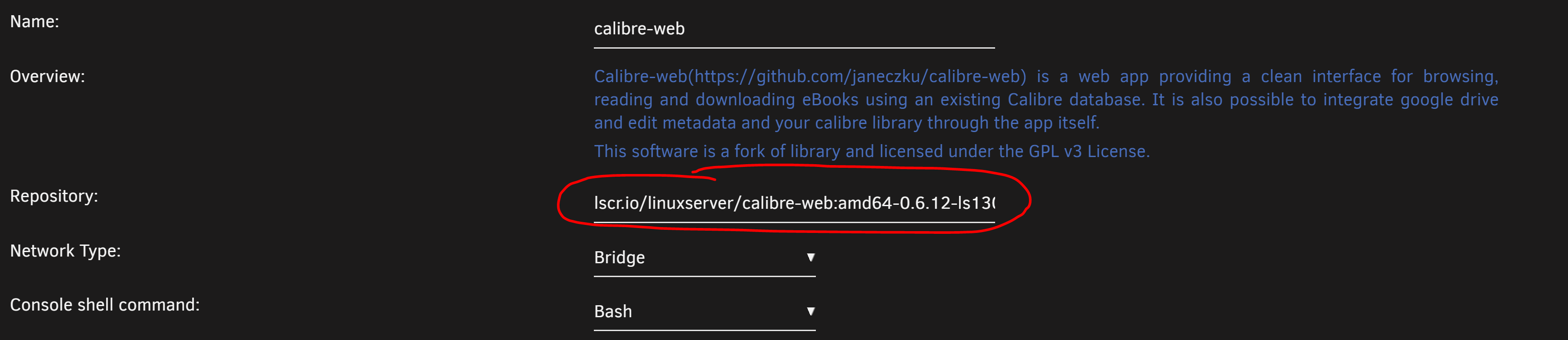

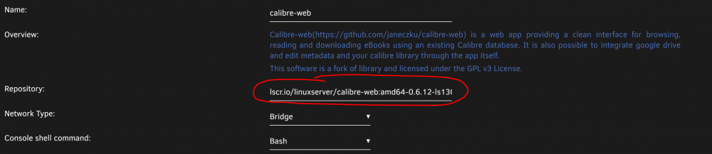

On 10/18/2021 at 8:52 AM, Liner81 said:
yeah, something happened to cause problems again. I still have the fix applied, but its not working 100%. If I log out and back in, sometimes it works fine, otherwise I can't progress beyond a few clicks without it locking up. I really should try to revert back a few versions.
Edit your Calibre-Web docker, and find and change the Repository section to this:
lscr.io/linuxserver/calibre-web:amd64-0.6.12-ls130
It should look like this:
That will downgrade your Calibre-Web docker to the older version (released approximately three months ago) where the workaround I mentioned actually works. We'll have to be satisfied with this until they release a fix for this in the future.

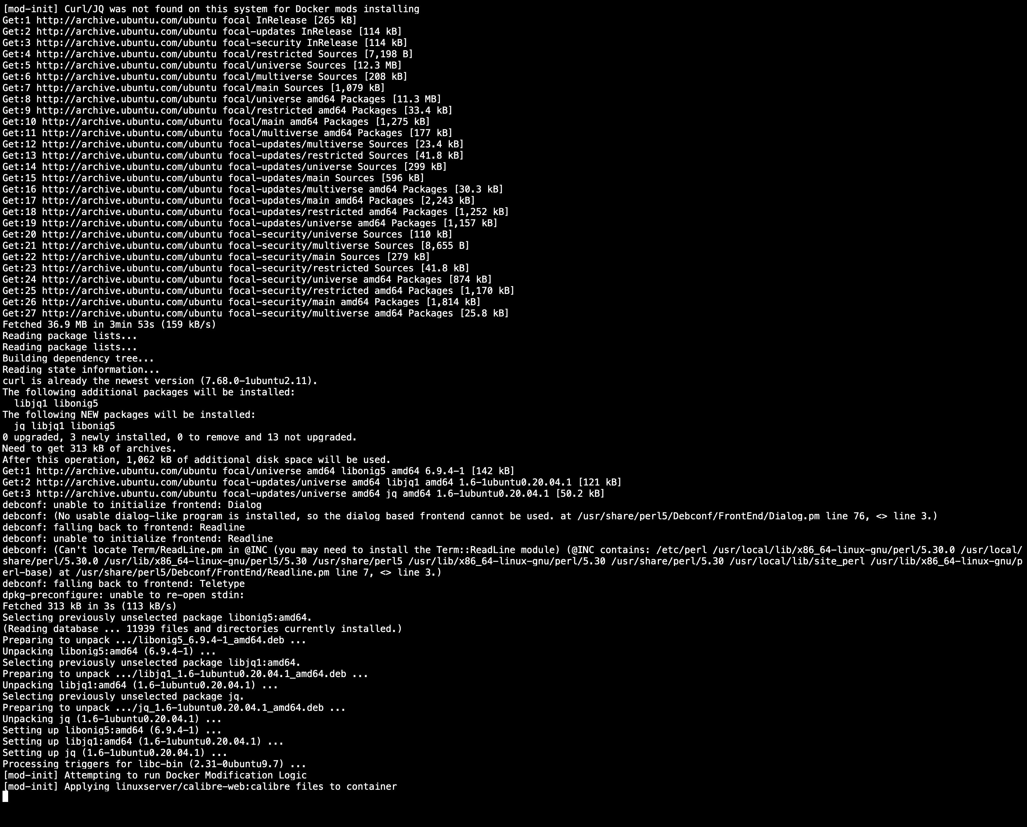

So I was having issues trying to get this working, (nuked & re-installed 4 / 5 times)then checked the logs...
[mod-init] Curl/JQ was not found on this system for Docker mods installing
This error is triggered by lack of network on container start-up...
So I set Autostart and wait to 5 seconds, now it's pulling some archives and applying it to the image?
Will update if working. Seems to be stuck thinking about something.
Yep, that worked.
I left it for about an hour with the log open an all sorts of stuff was downloading / unstuffing and happening!!
All up and running now.
Just be patient, it seems to be hung on;
[mod-init] Attempting to run Docker Modification Logic
[mod-init] Applying linuxserver/calibre-web:calibre files to container
But if you just leave it alone t sorts itself out.

I've got the calibre-web container running and can access it locally just fine. Problem I'm having is trying to setup a reverse proxy via (Nginx Proxy Manager) it keeps giving me an internal error.
I followed janeczku gudie https://github.com/janeczku/calibre-web/wiki/Setup-Reverse-Proxy#nginx-proxy-manager to no avail and was wondering if anyone else has got this to work? I attached a pic of my npm setup can any one see where I went wrong? thanks1.thumb.png.6175da7eb7f6c5781882eda3e1e07ade.png
Hey just want to let everyone know that the only way I was able to solve this was by switch over to swag. And wow I'm amazed at how easy it was to setup. Well using video from ibracrop on YouTube. Lol love them
