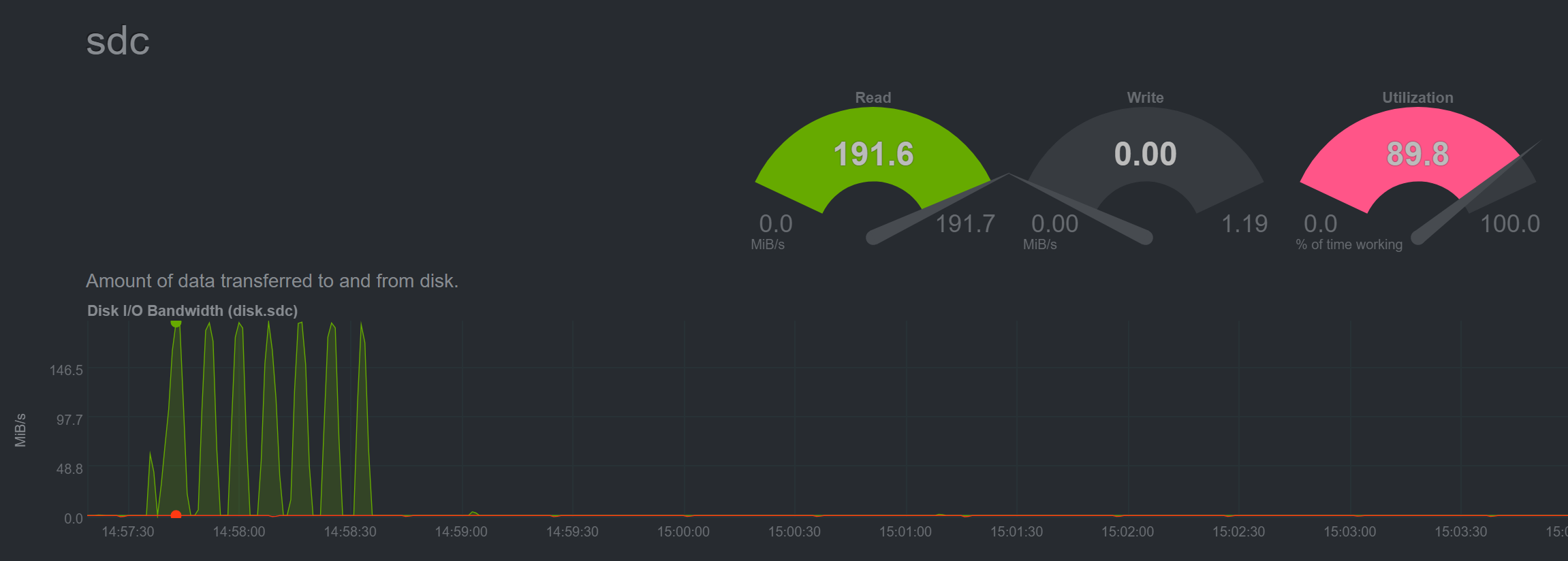

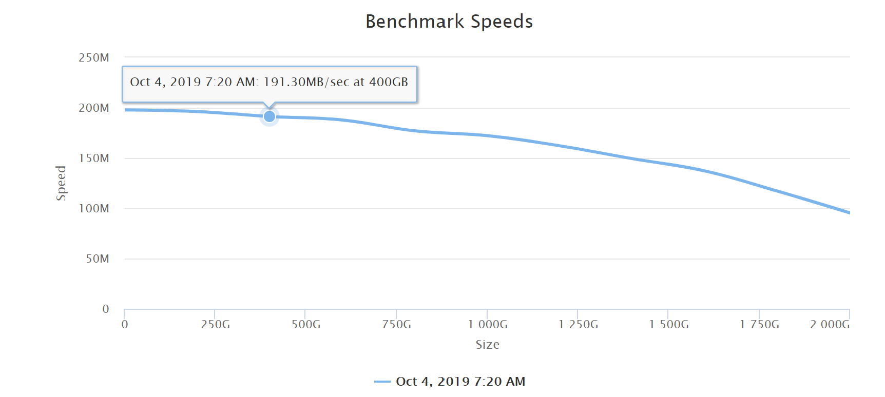

I was having similar issues with slow write speeds, around 25 MB/s but on benchmarks it peaks around 200 MB/s
Now with disk cache enabled peaks around 190 MB/s both read and write, without using the cache drive and with turbo write enabled.
sdparm --set=WCE /dev/sdb
From NetData running in a docker container, before the read and write was at 100% utilization.
Im using a DELL PERC H330 controller (even updated the firmware from unraid), tested both RAID (Physical disk mode) and HBA mode without any difference.
