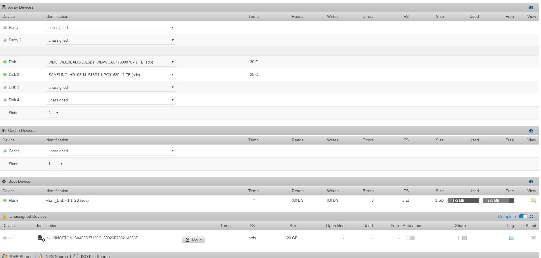

To help clear this up for us. With the array stopped, post screenshots showing the cache assignment and the unassigned.
14 minutes ago, trurl said:
I prefer to reserve the word "slot" for the actual disk numbers unRAID uses to refer to the disk
Sorry for confusion. To clarfiy: I moved the disk to a different bay in the storage chassis which is connected to a different SATA-port on the motherboard.
This is how it looks like now:

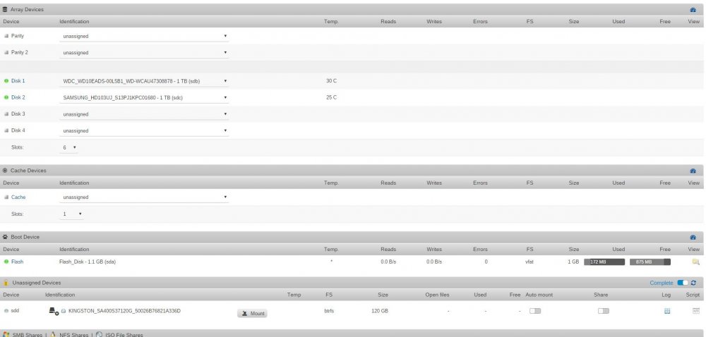

and here with the array stopped:
Changing to a different SATA port on your motherbaord should not change the identification string of the disk and Unraid should use the disk as before.
That does look like a normal identification for that disk.
Go to Tools - Diagnostics and post the complete zip.

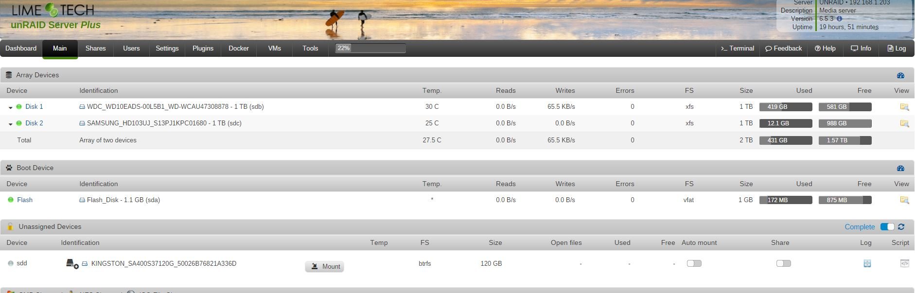

The reason why it didn´t show up in the screenshot i posted was because it wasn´t detected by the motherboard´s internal SATA adapter (which is actually the reason the issue start at all: both, the cache and the parity drive were attached to the two internal sata ports i mentioned above. And both ports seem to be dead now, not detecting any drive attached to them)
In that case the GUI will tell "missing device" instead of "unassigned". It remembers previous assignments unless you run a New Configuration command.
Hm, no - it says "unassigned", not "missing" in my case. So probably there was an issue with my config right from the beginning.
Update on the issue: In the meantime, i reassigned both the cache drive and the parity drive to the array. The cache drive was recognized right away. Unfortunately, that´s not the case with the parity drive, it´s rebuilding from scratch right now...
Because you changed an "unassigned" slot to a new disk assignment, Unraid considers this a new device.
In case of your cache device, its contents are recognized and can be instantly reused.
In case of your parity device, Unraid did not have parity before (unassigned), it need to build it a first time.
From now on you should not see anymore the unassigned slots when moving disks to other SATA ports. It should keep on working as before.
