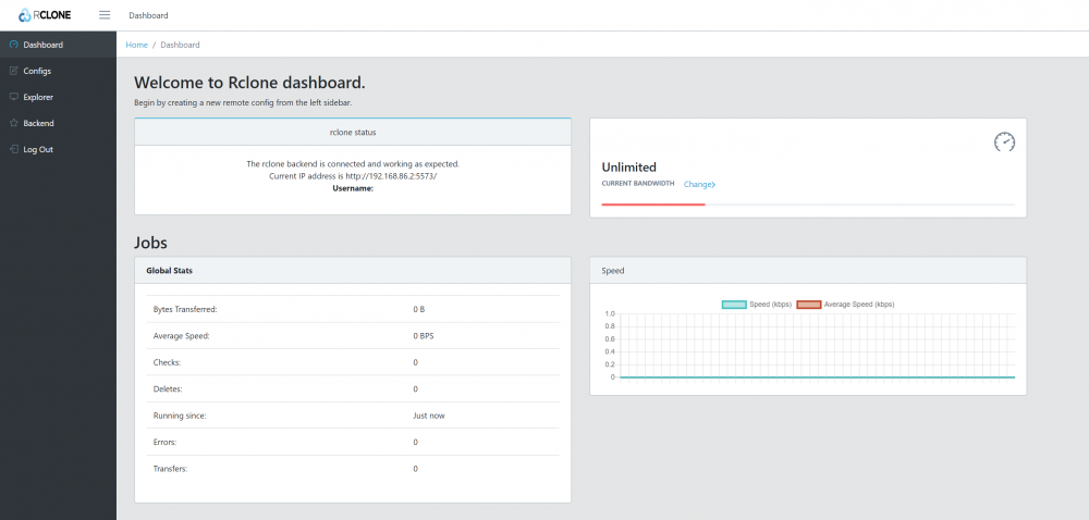

BTW, i found something cool!
https://github.com/rclone/rclone-webui-react
Just run rclone rcd --rc-web-gui --rc-user=test --rc-pass=test --rc-addr IP:PORT in terminal and you have a GUI for rclone, wtf! xD
Then go to IP:Port in browser. Thats all! Crazy.
It seems liek you can change your config there. Theres also a "jobs" "status" and so on, but sadly that doesnt work, maybe someone know how to connect that dashboard to our rclone installs? :D (so it shows what its doing, i would really love that becasue most time i dont really understand why its downloading) [or does it only show stats from things done via GUI? :(]
Edited by nuhll
No, im just stupid... you can embed these commands into your mount and or move commands, im currently tryin to work it out.
48 minutes ago, nuhll said:
I got it working:
https://github.com/rclone/rclone-webui-react/issues/38
There are my 2 commands i use currently you need to add another script which only runs at the first start... now you can see what your mount is doing!
So to sum up, you have to create a new userscript that start at startup with:
rclone rcd --rc-web-gui --rc-addr :5555 &
and then add to your mount
--rc --rc-addr=YOURIP:YOURPORT --rc-web-gui --rc-user=test --rc-pass=test --rc-web-gui-update --stats=24h
And to your upload script
am I correct?
I don't understand the usage of the first script ? (rclone rcd --rc-web-gui --rc-addr :5555 &)
What is the purpose? Why a different port as the others?
am I correct?
Hey, yes that should be correct.
is just be used to download the latest web gui (bc unraid delete linux after ever restart) sadly the normal commands dont auto download the gui (it seems)
