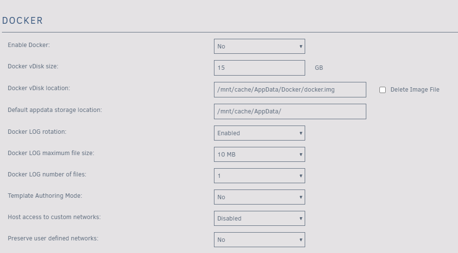

I think he's saying to set it as /mnt/cache/appdata instead of /mnt/user/appdata.
where?
do you mean the volume mapping?
/downloads /mnt/user/downloads/
to
/downloads /mnt/cache/downloads/?
But isnt it recommended to use the user shares..?
Edited by nuhll
1 minute ago, nuhll said:
where?
In your docker settings for radarr
In the UI settings for Docker? You first need to stop Docker in order to be able to make changes there. Maybe also changes in any particular mappings for RADAR to use /mnt/cache/ for temporary paths etc.
Edited by BRiT
