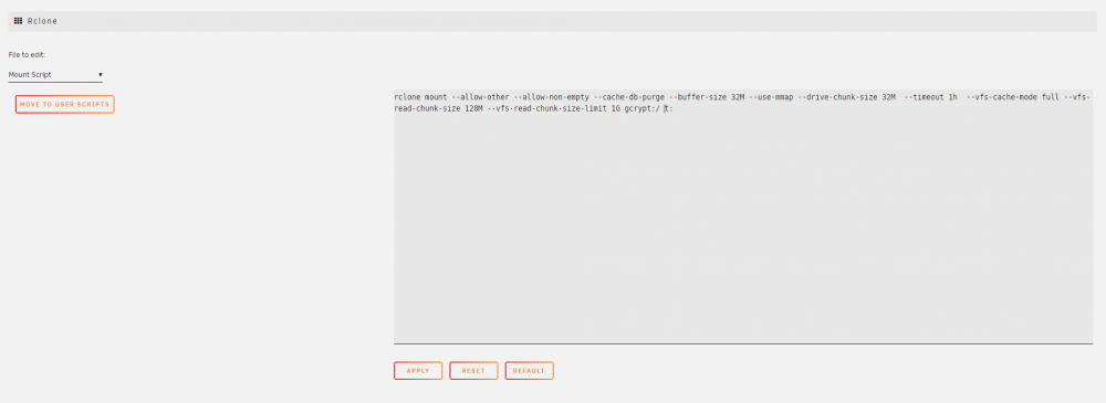

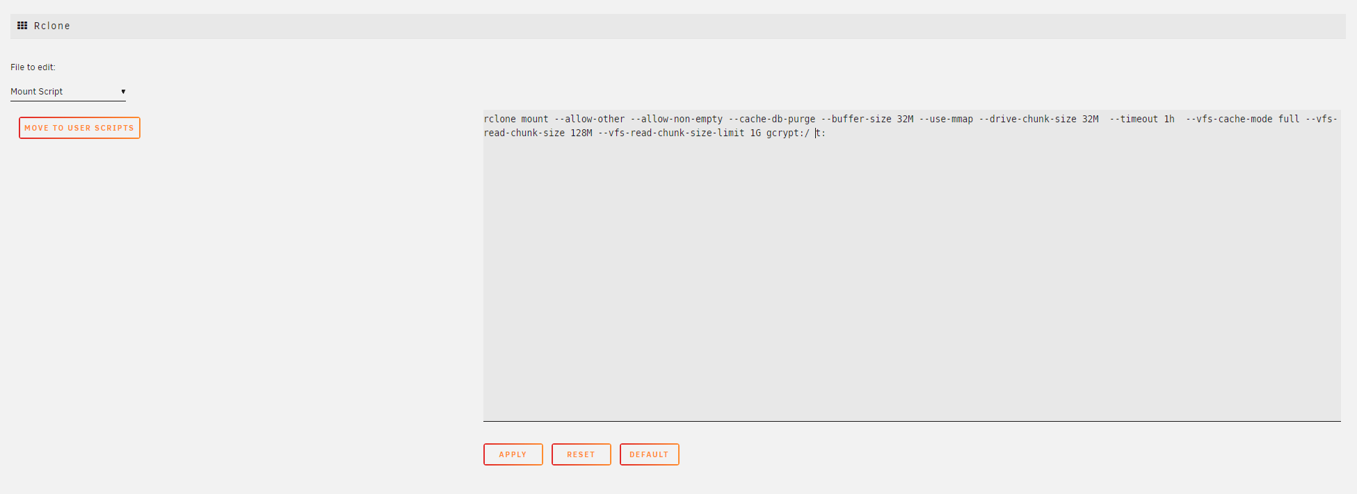

Hello all
I could need some help. Did I do it correct?
I asume the mount script is not fully correct. i have copied id from my windows Intel NUC.
rclone mount --allow-other --allow-non-empty --cache-db-purge --buffer-size 32M --use-mmap --drive-chunk-size 32M  --timeout 1h  --vfs-cache-mode full --vfs-read-chunk-size 128M --vfs-read-chunk-size-limit 1G gcrypt:/ t:
Feel free to adjust the mount comand.
Thank you
@DiniMuetter
It's best to use all the script on DZMM's github: https://github.com/BinsonBuzz/unraid_rclone_mount
Instructions for setting up all the user settings are well documented on his github. Read that fully and you should have no issue setting it up correctly.
 Use the userscripts plugin for easy editing and running.
Your current command is mounting like it's on a windows file system -- Mounting your gcrypt: to the windows "t:" drive.
For unraid that won't work and it should look something like:
rclone mount \
	gcrypt: /mnt/user/cloud (or where ever you want your gcrypt to be mounted in unraid)
But again. If you use DZMM's scripts you won't have to do any of the hard editing. Simply set your user settings at the beginning of his scripts and they automagically configure it for you!
Feel free to chime back in if you have more questions/problems
Edited by watchmeexplode5
