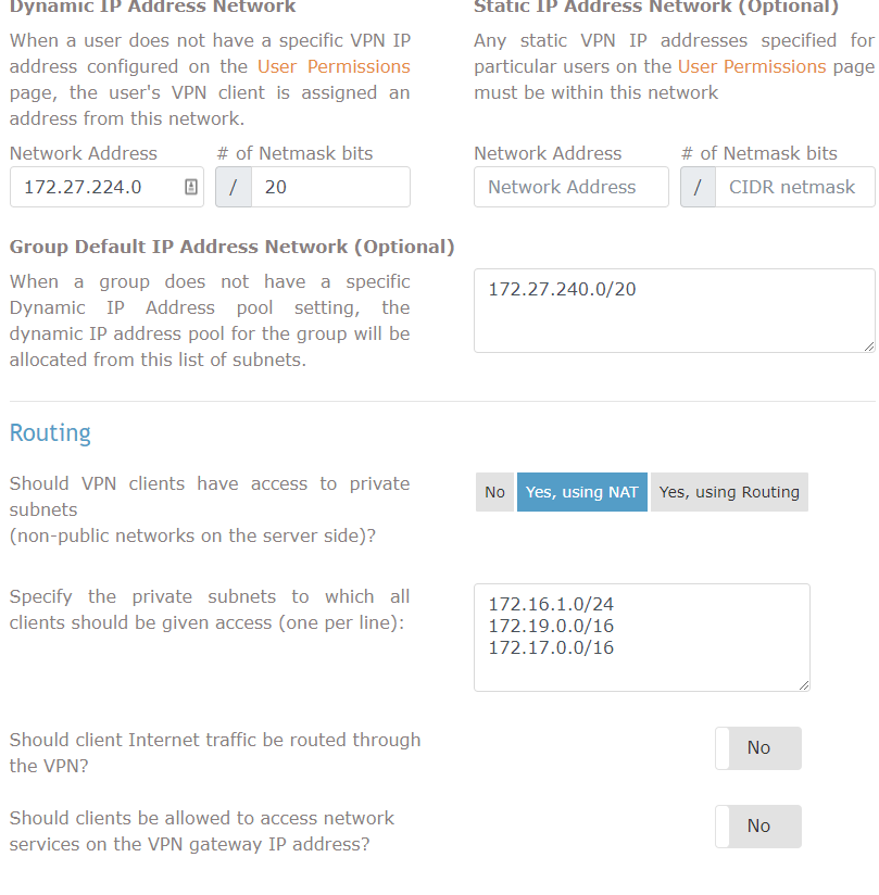

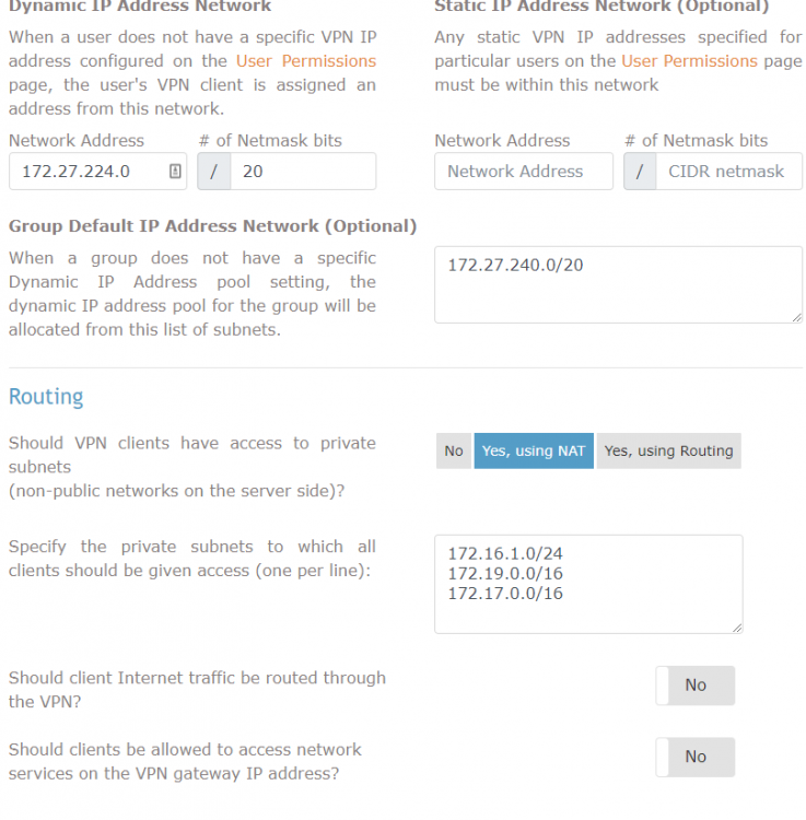

My problem is why I cannot ping this docker or access it via the VPN. It doesn't make sense because I'm accessing the local network not any bridge.
I'm using OpenVPN-AS and this are the networks I have enabled to access
image.thumb.png.fe55b0138a93ab3144851a3af3c2266e.pngimage.png.ea6b4d34548a9a02834fa8f6b4d405e3.png
Maybe I'm missing something.

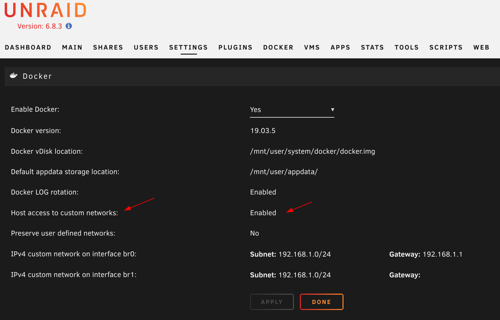

meanwhile there is a nice option ... since 683 when i remember ...
OMG... so simple yet I've spent so much time on trying to see what is wrong here..... I thought it was either my router or a DNS issue..... (I'm using pi-hole and Untangle)
Damn Hidden Advanced Setting, I always forget to open them...

ok, so I have Host Access to custom networks Enabled, but for some reason it doesn't work all the time... I was trying to access Nitwarden and it would not ping from terminal and Nginx Proxy Manager was giving me a 502 error, I restarted both and the issue was still the same, I remembered I had to disable and enable the option for it to work a while back, was going to try it yesterday but I was using NPM to access the Unraid GUI so I couldn't... I did this now and it fixed my issue again...
What can I do the prevent this from happening again? is there a script I can run that would replicated this disabling and enabling? or make a seperate vlan for this manually? if so how?
  • 2 months later...
 I too am seeing this error. I have the Access to custom networks enabled, but upon restart access has been lost. Disable Docker, Apply, disable access to custom networks, Apply, Re-enable Docker and access to customer networks and boom back again. A touch frustrating.

On 6/28/2020 at 8:13 AM, ceyo14 said:
ok, so I have Host Access to custom networks Enabled, but for some reason it doesn't work all the time...I remembered I had to disable and enable the option for it to work a while back... I did this now and it fixed my issue again...
Oh man! Thanks guys! I had these issues with my HomeAssistant VM and a mariadb container months ago and started getting them again over the weekend after restarting my unraid host. It took me hours to find this thread that lead to the solution that I no doubt implemented back then.
I'm assuming this (the need to disable and reenable for it to take effect) is some sort of bug then that needs to be fixed?
