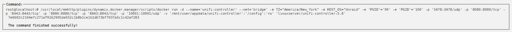

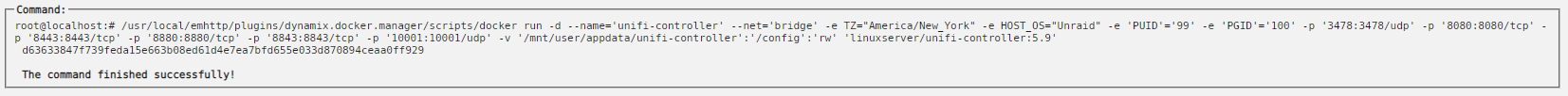

For the life of me I cannot get the Unifi Controller web UI to respond. I've tried 5.7, 5.8, 5.9, LTS... I've even deleted my Docker img and started everything from scratch. I've updated to the latest Unraid 6.9.2. Nothing works and I have no idea what I'm missing.
EDIT:
In 5.9, the web UI responds but I get "UniFi Controller is starting up... Please wait a moment". Refreshing after several minutes reveals the same message.
Edited by kazanjig
EDIT:
Post your docker run command.https://forums.unraid.net/topic/57181-docker-faq/?do=findComment&comment=564345
