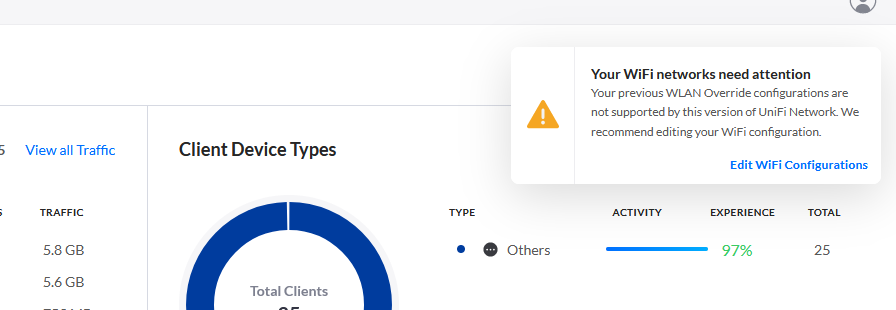

Cool cool cool. It happened again:
my theme swapped to 'white' and I received an error message saying my WiFi config isn't supported by this version (I haven't changed versions). It also swapped times from 24 hour time to 12 hour time. I guess some config file somewhere got wiped.
Also, when I went to settings, the 'new in v6' video started playing, as if it was the first time I visited the page.
I'm looking at the WiFi options and can't see anything problematic there - and indeed the main settings (SSID + pw) remain unchanged.
Just another fun Unifi moment...
And it's happened AGAIN!
Wow, Unifi! Just amazing!
Has anyone else here experienced this? or is it just me?
If it's just me... anyone have idea what the cause could be? I'm at a loss why.
