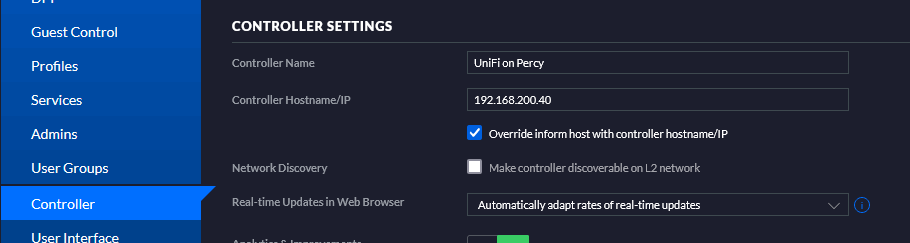

Did you have the controller settings Override inform host set properly in your previously working version?
You MUST keep that set properly to use a containerized unifi controller.
Indeed, it was not activated because I simply did not know...  Thanks for the hint!
How/ where  do you activate this?
EDIT: Owh I think I know is it this?

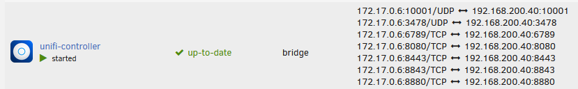

Is there a reason why this container defaults to "bridge" network? For me it's only reliable with "host" network (else it does not adopt devices after restart).
Mine works fine as Bridge. Never had adoption issues (well, there were some when I had to factory reset my devices and completely nuke the controller install, but that wasn't related).
I have the following ports mapped and am running version 5.14.23-ls76:
EDIT: Be sure to make sure you have the broadcast address set manually in Settings > Controller > "Controller Hostname/IP" too!
Edited by jademonkee
Added controller host info and pic
