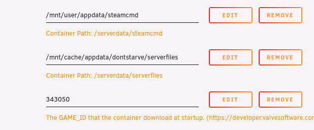

yes i have a cache disk and my docker container are on it. i us unraid 8.9.0 RC2
here my template:
38 minutes ago, Ossito said:
Hello ich77
here my template:
Please change the path from '/mnt/user/...' to '/mnt/cache/...'
I think this should solve your problem.

But can you explain me why if /mnt/user/ doesn't work and /mnt/cache does?
all my other container are in /mnt/user/.
A few applications gameservers need the physical path where the application and the files for the application are and not the "virtual" path.
For example TeamFortress2 and GarrysMod are the same and needs the path to the physical location.
That's why I put always the '/mnt/cache' path in my templates to the gamefiles and the '/mnt/user' path for SteamCMD because SteamCMD doesn't need the physical path to the files because it only downloads the files or checks for updates.
Even if you install the container you see that the CA App actually fills depending if you own a cache drive or not the physical path to your appdata directory:
If you are using a UnassignedDevices disk the path is for example '/mnt/disks/DISKNAME/SHARENAME' or if it's located on the array then the path has to be '/mnt/disk2/SHARENAME' (the array path is dependent on the disk where the files are but keep in mind that if someone uses it on the array the files can't be split over multiple disks!)
Also some other Containers are in the CA App that needs also the physical path that are not from me, this is completely application dependent.
Hope that makes sense to you.

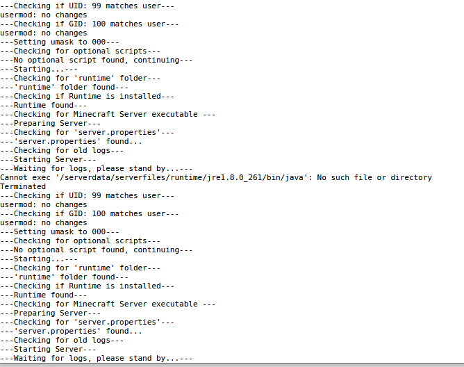

I sadly have a problem with the MinecraftBasicServer that i dont get fixed.
Starting the server the first time gives me an error (first picture). I dont know what this means really? There is nothing there on the server, so should i install something there?

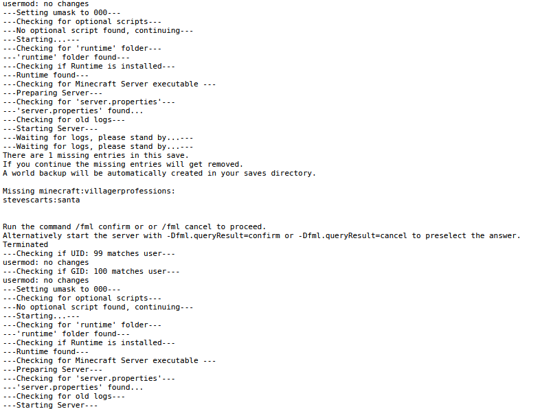

After i convert the server to a forge one i get this start error (second pic). I tried getting into the console through the screen but it says that there are no screens for this docker( i used "docker exec -u minecraft -ti Mods screen -xS Minecraft"). If i put the "-Dfml.queryResult=confirm" into the start parameter, it doesnt help and still shows this error.
Could somebody help me please with that?
Have you eventually shut the container down or restarted it on the very first start, because this looks not like the really first start, you have to wait at the very first a little longer since it downloads the runtime.
Please try to delete the folder 'runtime' in your minecraftbasicserver folder.
Where did you put this command in?
It seems also that you have mods already added...
The log says something or better speaking that a dependencie or something in your savegame is missing (keep in mind there are different versions for windows and linux out there) and that you have to confirm that.
I will reinstall it then and try that. Maybe there is my error.
In Extra Game Parameters and then Extra JVM Parameters to test which works.
I put in my backup from my old server so it would start the old world on the new server. Thats why mods and a save is already in.
Edited by Kurtchen
6 minutes ago, Kurtchen said:
EDIT: i tried to delete that folder but it reappears instantly?
Stop the container and try to delete it and then to start it up again then it should say that the runtime isn't found and it will redownload it.
Is this also a Linux machine?
Try for troubleshooting reasons to delete the savegame for now then this issue should be resolved.
The docker was removed and i cant delete it.
I now installed it in a different instalationpath. This worked perfectly now!
